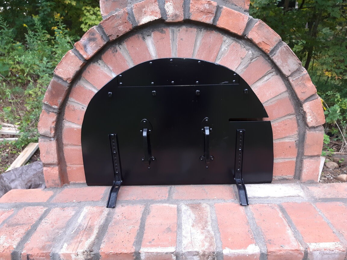

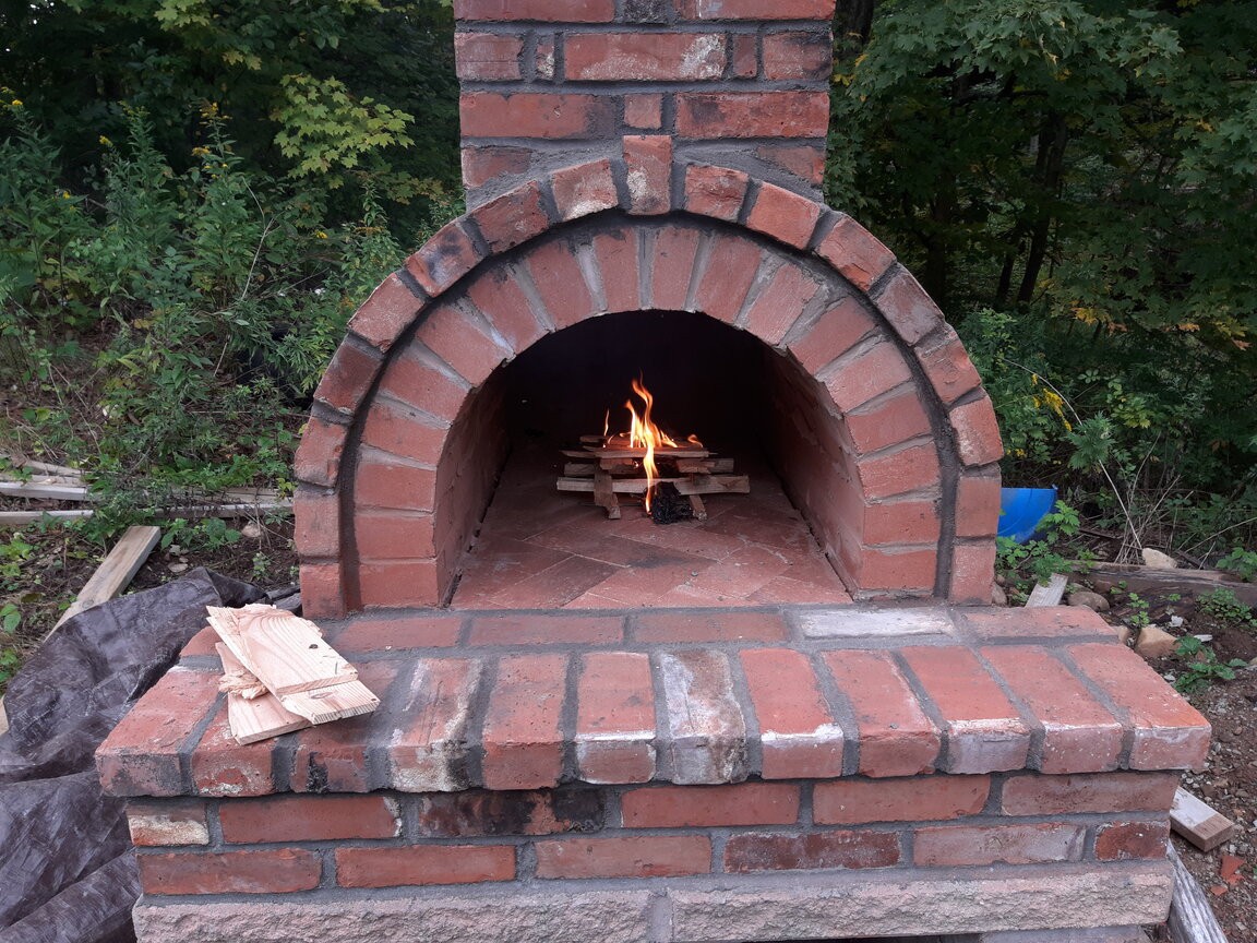

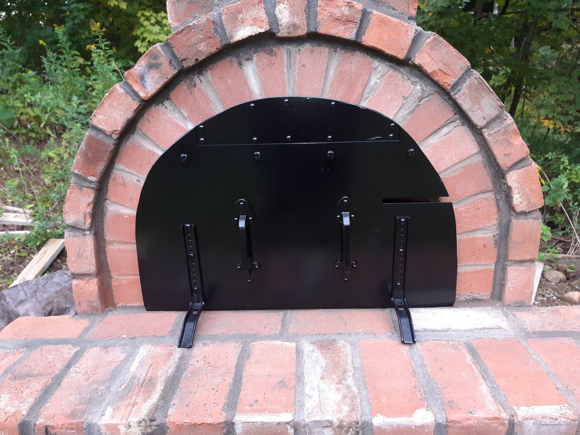

        Well we lit the first curing fire yesterday and overall it went well. I had completely forgotten about the briquette method so the very top of the oven of course got hotter than 150 degrees so to remedy that quickly I just spread the fire out a bit wider amongst the floor. I also fabricated a door out of heavy gauge 1/8 steel scrap on Saturday. The slot on the right was already there so i just left it as a peek hole. Next fire I will have a bag of briquettes for sure.
          I see an ove glove purchase in the near future ;}

            The door looks great, I purchased a pair of welding gloves from my local builders supply store for $6.00 and they are working out really well.
            Sixto - Minneapolis
            • #7
              Thank you Sixto, I don't have a welder so I just drilled , bolted and screwed together, it's a pretty solid door

                    Thanks for the reply. I ended up using charcoal briquetes last night, started with a pile and added more as they heated up. Eventually had one single layer spread evenly across the entire oven floor, front to back, it had a nice even steady heat, hoovering around 200 to 220. I let it burn out naturally.
