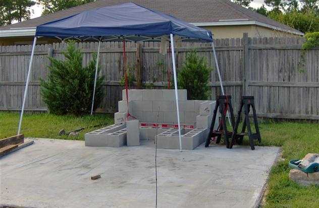

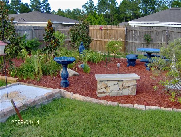

    Going next to the garden my wife wanted earlier this year.
Name:	HPIM0027 (Custom).JPG

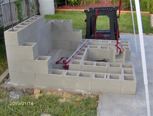

    Re: My turn in FL
    Holes filled with rebar and concrete
    [ATTACH]26896[/ATTACH]

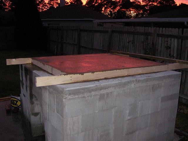

    Void filled with dirt from slab pour, layered with cement board and topped with concrete prior to supending slab
    [ATTACH]26897[/ATTACH]
    My son was helpful with pour of slab
    [ATTACH]26898[/ATTACH]
    Adding cancer braclets to slab for my other son. Oven iss being built in memory of him, he loved Pizza
    [ATTACH]26899[/ATTACH]

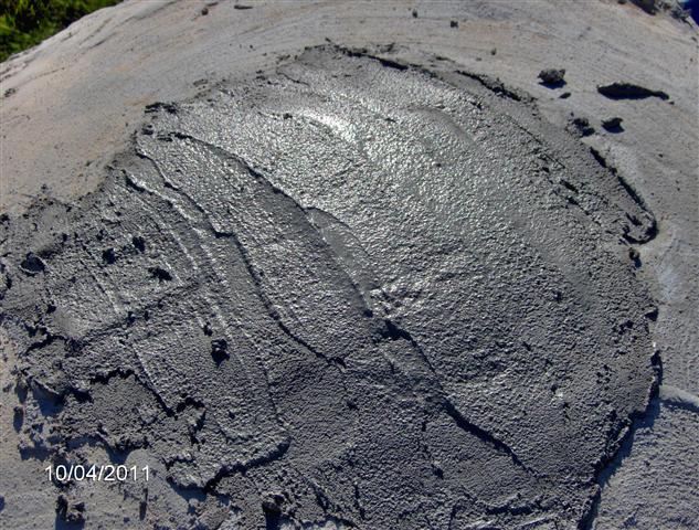

    Finishing slab
    [ATTACH]26900[/ATTACH]

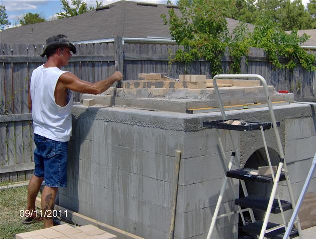

      Re: My turn in FL
      Insulation done
Name:	61 (Custom).JPG

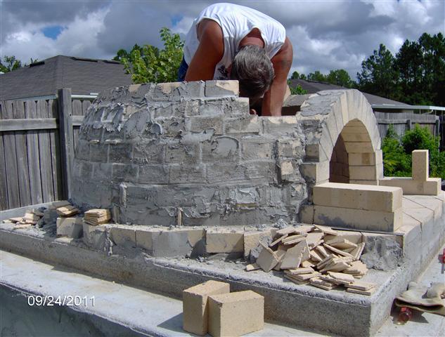

      First chain going on
Name:	HPIM0093 (Custom).JPG

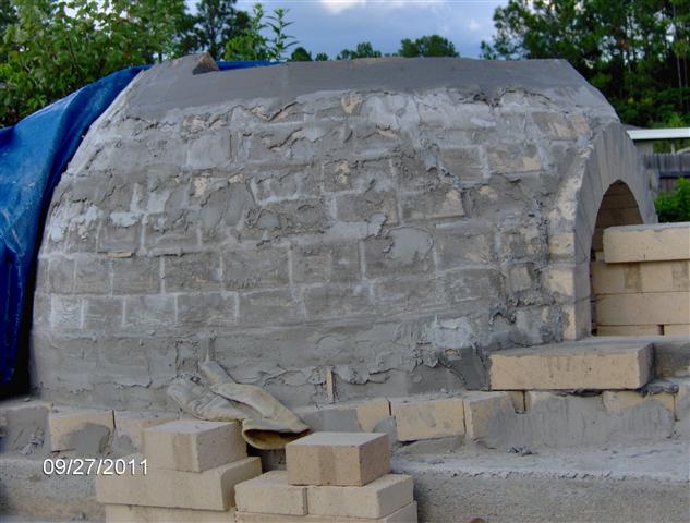

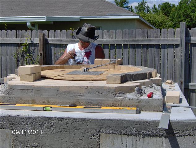

        Re: My turn in FL
        Moving right along
Name:	98 (Custom).JPG
Name:	107 (Custom).JPG
Name:	121 (Custom).JPG
Name:	128 (Custom).JPG
Name:	134 (Custom).JPG

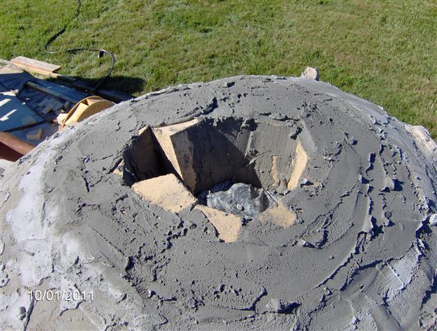

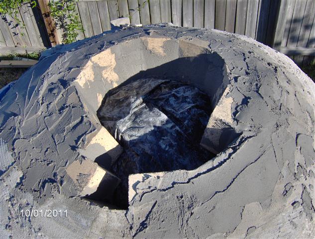

            Re: My turn in FL
            Almost there
Name:	136 (Custom).JPG
Name:	141 (Custom).JPG
Name:	145 (Custom).JPG

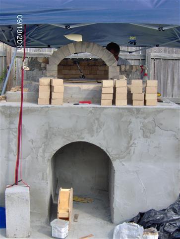

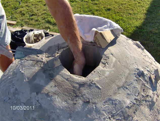

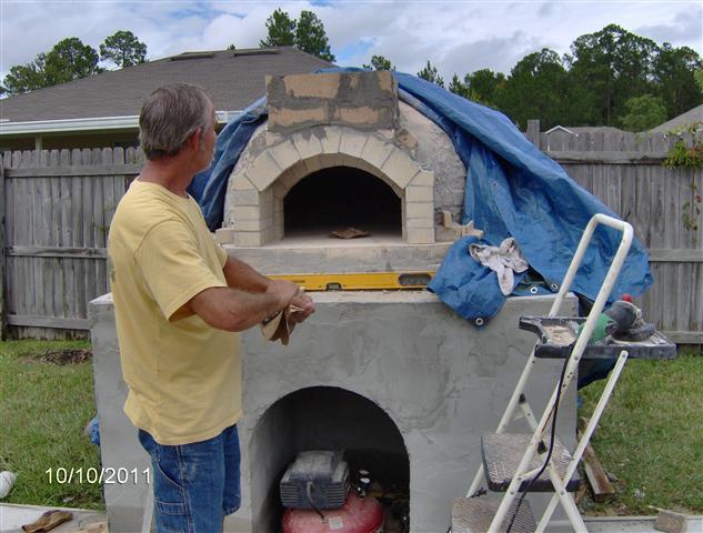

              Re: My turn in FL

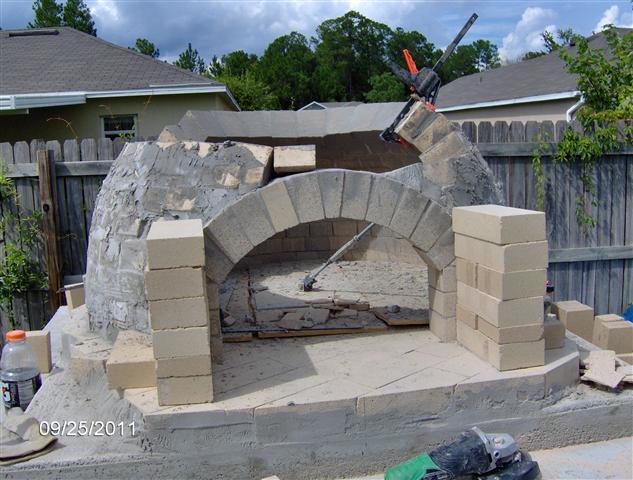

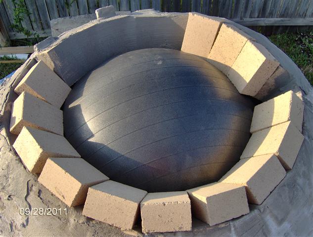

              Getting close, dome closed
Name:	HPIM0189 (Custom).JPG
              tearing Pizza Box a week later
Name:	HPIM0194 (Custom).JPG

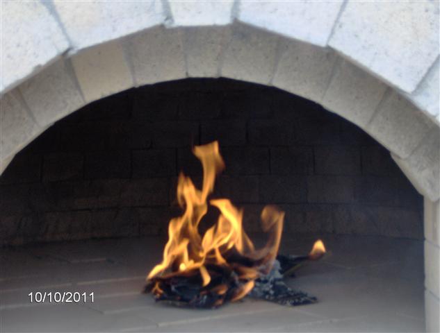

              Our first fire, just had to do it
Name:	Our first fire (Custom).JPG
              today I will put an electric burner in set to low till this weekend then start curing fire at a very slow pace.
