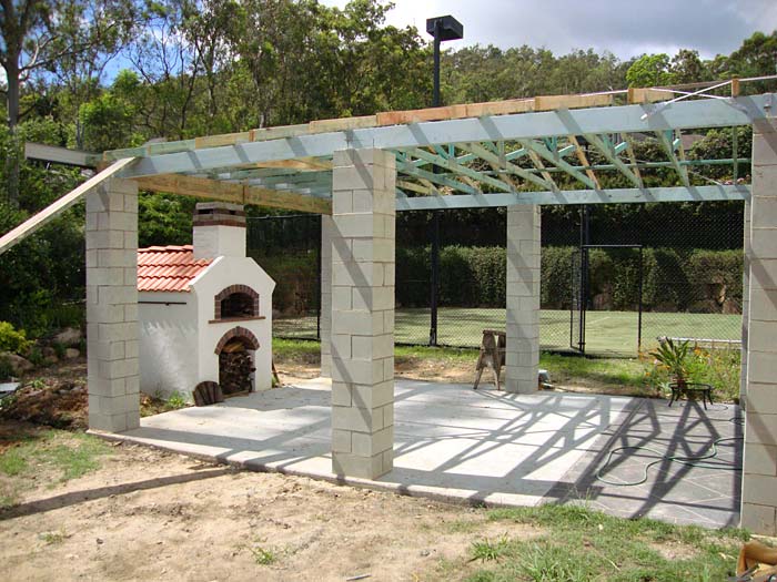

              It's a barrel vault design, pic from Rado's site:
              (deleted - people keep thinking this is what I've built *shrug*)
              the hearth bricks will sit on edge on, giving a floor thickness of 115mm, on top of a full 4" of perlcrete insulation above the hearth slab.
              The whole vault will be skinned with only 2" of cladding, Then the walls insulated with 4" of loose Perlite and the vault top covered in 2-3" of blanket insulation. (this will also allow me scope to add more cladding if I need it)
              I'll also change the chimney design somewhat to make a smaller landing than the original design. The chimney will be thermally separated from the oven cladding by 4" of perlcrete and any blanket I have left over stuffed into any air gaps.
