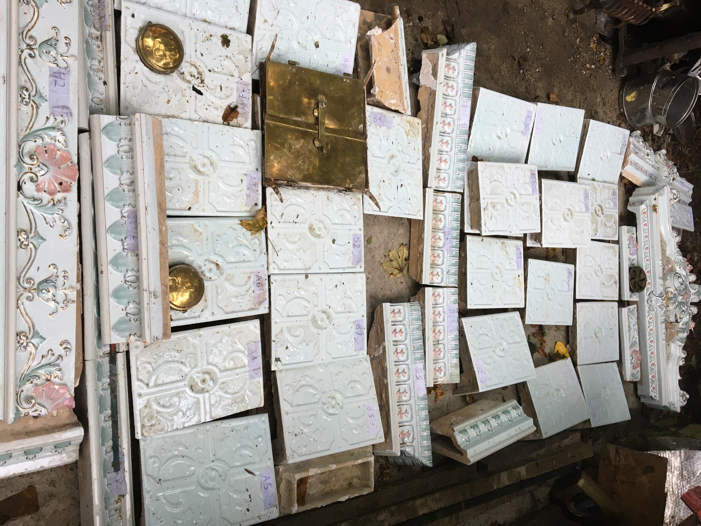

    Click image for larger version  Name:	IMG_9142.PNG Views:	0 Size:	64.2 KB ID:	442163 Click image for larger version  Name:	IMG_9113.JPG Views:	0 Size:	1.13 MB ID:	442165 Click image for larger version  Name:	IMG_9123.JPG Views:	0 Size:	1.31 MB ID:	442162 Click image for larger version  Name:	IMG_9127.JPG Views:	0 Size:	716.0 KB ID:	442164 Click image for larger version  Name:	IMG_9125.JPG Views:	0 Size:	1.36 MB ID:	442166 The planning/Greenbelt restrictions prevents me from building a gazebo. A seating area is designed to benefit from the smoke emitted by the cooking surface of the stove and utilise the smoke/heat generated to run it under the granite slabs to heat it up theon. No calculations were carried out on how much heat is required, hence the two stoves are connected to the shaft created in between the two walls (with tiled surfaces). Someone's bottom is either going to be too cold or it will be burnt like hell by the granite surface!
    An antique kakelugn ceramic stove from 1832, looks slightly like a Birthday icing is to obscure the stove. The antique kakelugn ceramic stove is yet to be assembled.
