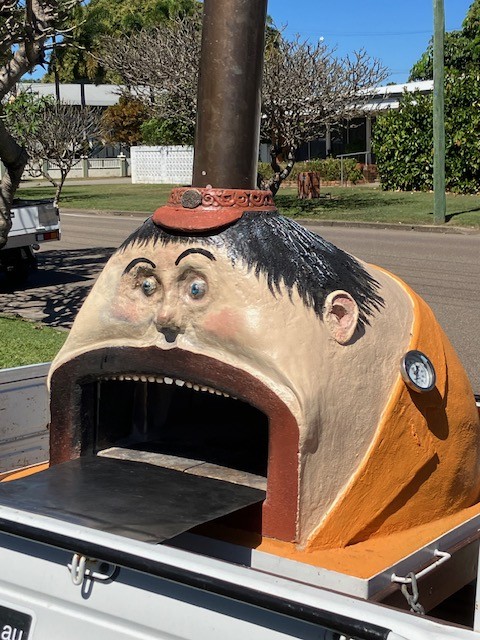

    Yes, it's a bit of fun. We call him "Augustus Gloop" after the character in Roald Dahl's Charlie and the Chocolate Factory.
    I'm always amused when some kid, who demands to have the first pizza, is unaware that the first pizza is never the best.
    I can roll the whole oven off the trailer and onto the steel stand, which allows me to use the trailer for other purposes, but usually it stays on the trailer to operate.
    I have a removable stainless plate in front of the oven mouth which works nicely as loading landing.
