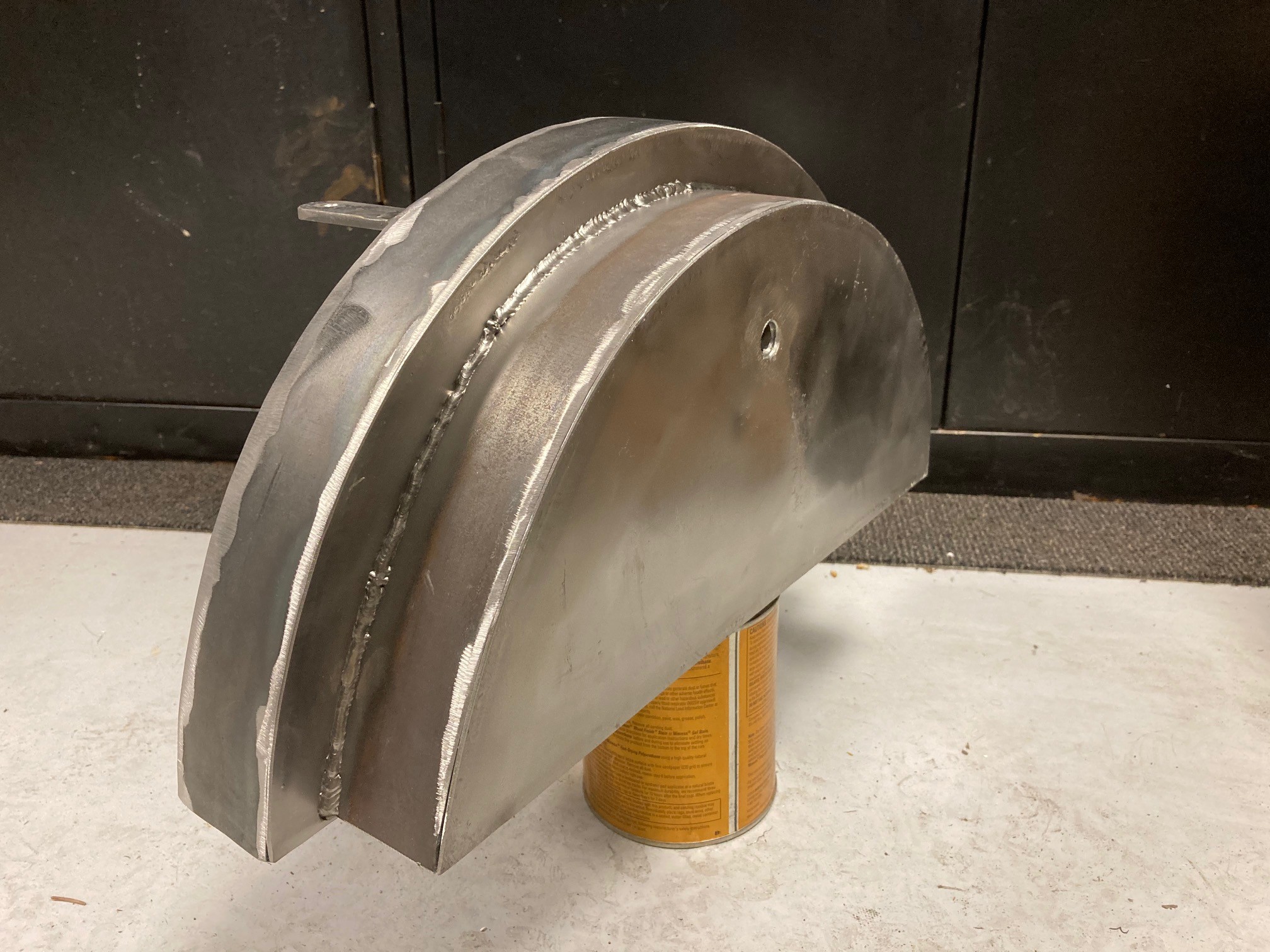

      Yes sir. The inner arch fits inside the cast concrete opening. The outer arch fits under the bricks which are 3” thick plus the mortar. Both arch pieces are 2” thick. There is less than 1/4” of side-to-side movement once the door is in place. When I add some insulating rope to the outside between the arches, it should be an interference fit. Hopefully you can see what I mean by looking at this picture.

        Rainy day at home, so I decided to take a ride down the shop and finish up my door. I did an overlay on the front and had some “hot” rivets in a drawer and decided to use them as decoration. The handles are table/chair legs from Lowe’s. So in all, there are 3 steel plates and 4” of CaSi insulation between the inside of the oven and the outside. I’m going to also build an insulated cover to go over the chimney vent. Even with a damper, I will be losing a lot of heat out the chimney as it’s the least insulated spot on the oven. An insulated can that I can put over the copper vent when I need to retain heat should work well.
        Here it is in its raw form. Still trying to figure out the color and coating material.

        • #79
          Beautiful door - almost a little Steam Punk. As they say "I wasn't picking up what you were putting down" when I asked you about how the door was going to fit - didn't catch your double arch design. Have you weighed it yet?
          • #80
            HEAVY! 18.6 pounds as it sits, so by the time I fit the handles, thermometer and have it coated it will be 20+ pounds.
