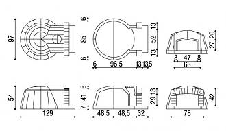

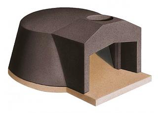

I managed to pick up a good quality 34" Italian pre-cast oven from an insolvency reseller in England at a bargain price. COVID and recent high-inflation was tough on pizza oven retailers apparently. It should arrive on a pallet on Tues 9th July. I hope it arrives in the correct number of pieces. It's perhaps slightly smaller that I wanted but I'm consoling myself that the build cost will be lower and that I'll fire it up far more often given the faster heat-up time.
I really wanted to buy a Forno Bravo oven, but they're not available in the UK currently. The Italian "Volta" ovens are also sadly no longer available in the UK. The Australian brick oven kits popular on here are also unavailable in Europe and import cost is prohibitive. And finally, the various other UK alternatives that I looked at all had glaring design flaws like chimney in chamber, insubstantial vent opening (Vitcas), or just plain terrible casting. Stumbling on this discounted Linea Napoli VZ oven was a stroke of luck I think; provided it turns up in NE Scotland intact.

Click image for larger version  Name:	Linea Napoli pic.jpg Views:	0 Size:	36.4 KB ID:	459705
Click image for larger version  Name:	Linea Napoli dimensions pic.jpg Views:	0 Size:	79.3 KB ID:	459704
