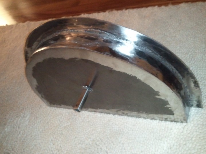

    Nice build Martin! There are several threads in the forum dealing with door construction. Many folks have settled on two doors for their ovens; an insulated firing door and a "lighter" cooking door. Most of the insulated doors use either ceramic batting or board in a sandwich of metal pieces. I had a stainless steel "hollow" door made that I filled with perlite. For my cooking door, a friend took a piece of sheet metal, gave it a slight x-fold for strength, welded in a steel rod handle/base so it will stand on its own, and attached an old coiled metal welder's tool handle. I can easily handle the door with one hand while checking on my bake. I've attached a few photos, one of the stainless firing door (up on bricks for draft testing) and two of the cooking door.

      As far as using foil on wood for a door - I think others have tried that and found that the wood gets too hot and catches fire. You really need to use metal. I built my door out of 16 gauge mild steel, welded together with 2" of CF batting. Works great. Others have built similar doors using rivets or screwed together that seem to work well if you don't have access to a welder. The plate steel is available pretty inexpensively through onlinemetals dot com. They will cut the pieces to square dimensions, but not to the arc of your opening. For that, you need a jigsaw with a metal blade. I had them cut the strips for the side of mine and it was a big time saver. Cost of the metal was probably less than $40.

              Have a look at post 17 of my link at the bottom of this post. This door works extremely well and is very light. You only need one flat sheet of stainless steel, a short piece of scrap aluminium angle, loose vermiculite, decorative wood for outside and handles. Most of the material you should already have. For me this was not expensive and the outer part of the door does not heat up at all.
