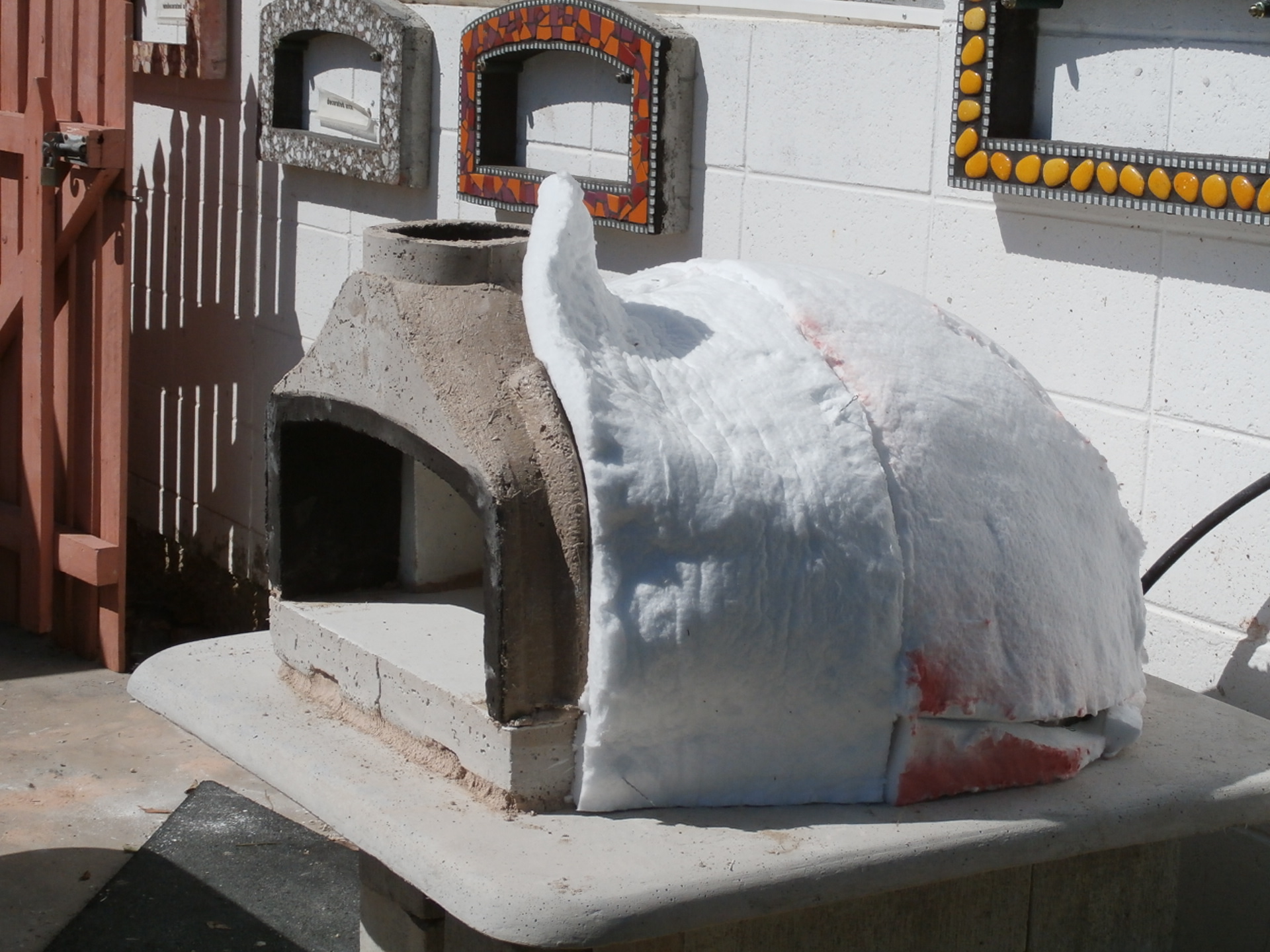

                              Yes David, very timely! I spent some time poking around your posts trying to find your advice for doing the p/v-crete layer, so thanks for summarizing. Do you have any works of wisdom for what you have found works best between the insulation and the p/v-crete. Chicken wire, 1/4 inch hardware cloth, etc?????
                              • #90
                                I don't use anything as chicken wire takes hours to cover the blanket and tie in. 10:1 vermicrete is not at all strong and the chicken wire really only serves to hold the blanket in place. Provided you get the blanket fitting neatly I can't see any other advantage in covering it with chicken wire. I just vermicrete straight on to the blanket.
