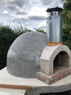

    Here are some pics of the blanket being put on. They have since finished the exterior, but we still plan to paint with white epoxy paint.

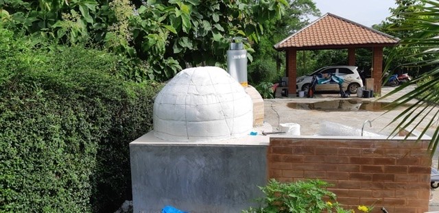

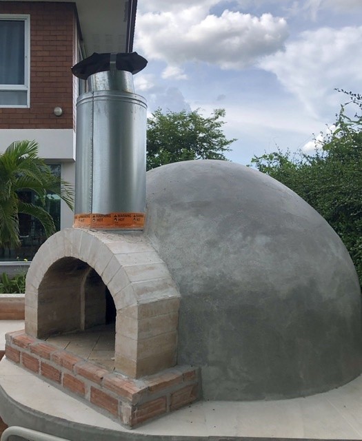

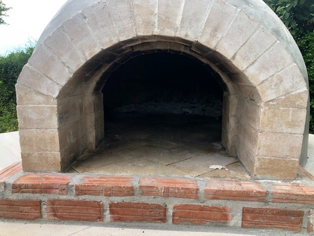

      The exterior is now complete except for a coat of epoxy paint to protect the surface.
      Click image for larger version  Name:	67E40710-D528-43D4-923C-D92FE691C2C5.jpeg Views:	0 Size:	74.6 KB ID:	428334
      Click image for larger version  Name:	8C46011A-00B2-471D-9275-830B1EBAB576.jpeg Views:	0 Size:	78.6 KB ID:	428336
      Click image for larger version  Name:	0124010A-D6B6-4629-ACB9-EFC537D8E3C6.jpeg Views:	0 Size:	85.8 KB ID:	428335
      The decorative brick was added to contain the firebrick, and I like how this ended up.
      The last to be done is refinishing the cap of the ceiling (inside). We hope to do that this week. Then we can properly fire up.
      Then paint dome exterior with white epoxy, and make a metal clad door/plug.

                Did you/they put additional insulation (vermiculite) on top of the blanket? the finishing looks so smooth on the pic that it looks like ordinary cement??
                Anyhow do measure temperature on the dome top to make sure your losses are limited. with a 500 degree fire inside, I had 70 to 80 degrees going through 2 layers of blanket.
                This is now reduced to 40 degrees with the vermiculite on top, which is less than a really hot day. If its not done, I would insist 'they'add it.
                Good luck with the firing up, take it easy.
                Did I understand correctly that you will try 'fixing' the flat brick roof on top of the dome from the inside? sure? I see a rain of mortar dust falling down on your pizza's already. Maybe go through he curing process first till you can get a really good fire rolling and see what happens? if the weird inner dome shape is not affecting the aerodynamics too much, why change? You do peek occasionally towards the dome top, but most of the time your focus is on the pizza floor.
                At the end of the day, aesthetics don't really matter when it gives you stable cooking conditions and great pizza. With a bit of luck, the funny inside shape will not hamper the flames from rolling as if they were in a laundry machine. Nothing is even close to perfection in Thailand and still they produce great tasting food. Your oven will be fine, despite the imperfections. The workers, the family, everyone will be wondering what you were so stressed about ;-)

                      After the blanket was a mix of cement and "mountain rock" which looked like lava rock to me, white, lots of air bubbles/gaps in it, very light. That was all I could find. We did not end up patching the inner ceiling. They did a few small fires with Lam Yai, and now I am trying to get them to do more, progressively larger ones. Personally, I'd do it every day just for the joy of watching a good fire. Unfortunately, getting them to do what I want is more like trying to get a cat to take a pill. ...and they want to try cooking pizza with it, but of course they tried with a very small, early curing fire at a very low temperature and now they say, "it's too big, it didn't work." arrrgghhh.
