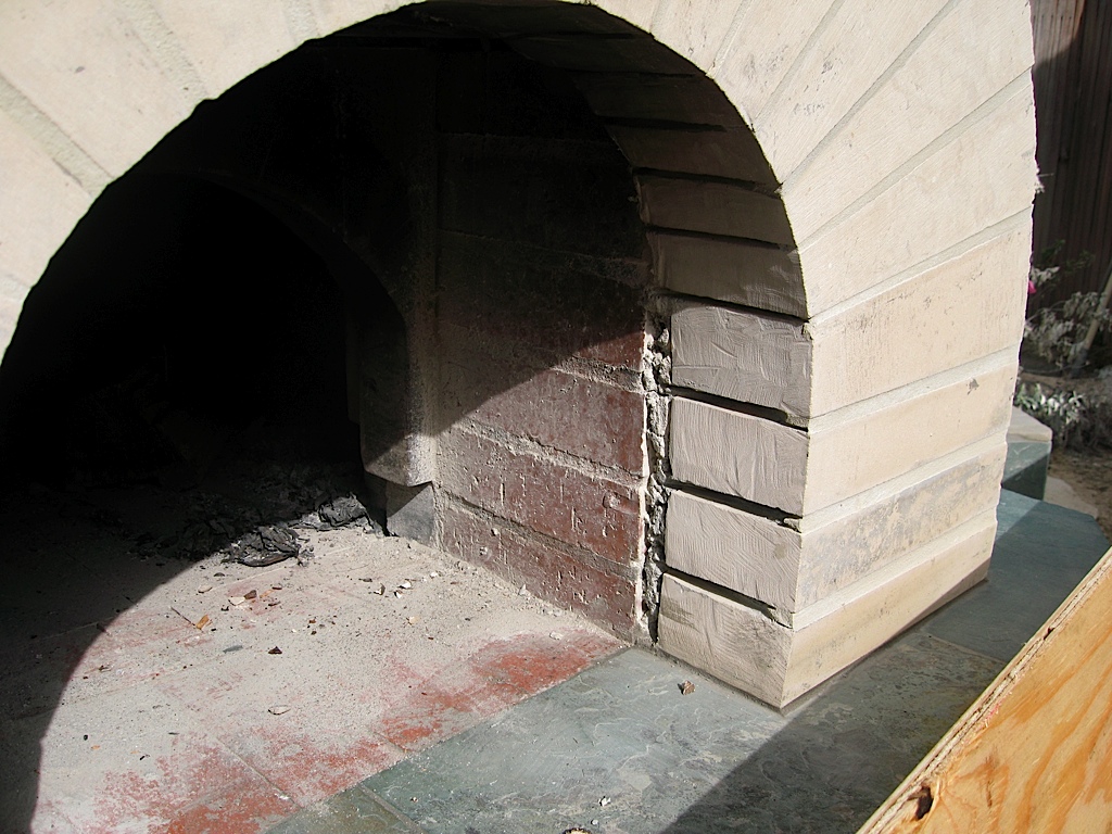

I noticed this image
In an early thread about James' oven installation.
I see a variation in the width of the oven opening, with the opening at the oven floor -maybe 2-3 inches wider than the upper portion. Left as it appears, you could move a very wide pizza peel through that bottom opening while having a more narrow opening in the upper portion to hold the oven heat.
I realize two things here involving the seal of an oven door and increased difficulty in the arch construction to exaggerate a narrow upper arch. I want it both ways in terms of a wide and tall oven landing with good heat retention.
Has anyone tried an unconventional oven landing shape to mimic the picture above? What are your thoughts?
And also because we love doing general cooking in the oven rather than just pizza.
