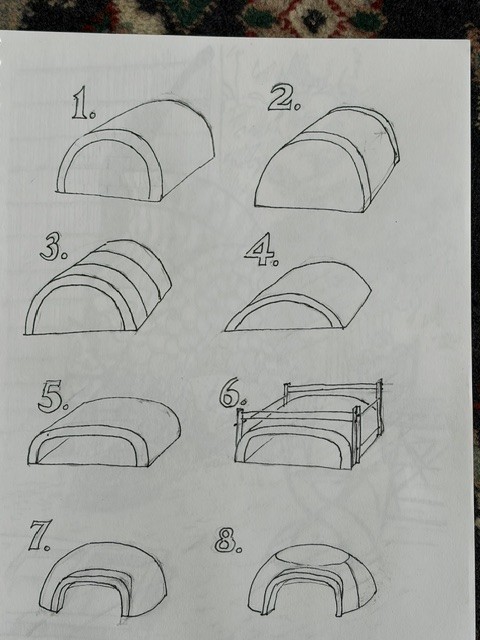

        The problems of uneven heating and the resulting thermal expansion particularly in brick builds can lead to stress and fractures usually created in the mortar joints. Therefore cast builds are less susceptible because there are fewer joints. At the other end of the scale, the larger the brick or cast section, the greater the chance of cracking, hence the use of loose laid floor bricks which can expand and contract individually.
        While a half barrel structure may seem simpler to build than a dome, it introduces more complex issues requiring more complicated solutions.A few thousand years of millions of oven built and thousands of different design solutions experimented with have resulted in the hemisphere with its superior chamber circulation as well as its inherent stability characteristics, to be the most popular choice.
        1. A half barrel oven with its internal height equal to half its width is a relatively stable structure until thermal expansion takes its toll. A 10" high ceiling would result in a 20" wide oven.
        2. If the end walls are built against, rather than under the vault, the expanding vault simply pushes the end walls out.
        3. If multiple sections are used in this fashion the top of each section heats and expands first, while the base remains a lot cooler, creating stress and possible fracture.
        4. A larger radius vault results in far greater outward thrust at the vault's base, requiring either buttressing or bracing, as well as unworkable angles at the vault sides.
        5. More vertical sides increases workability but the uneven thermal expansion remains. So brick builds in this form are far harder to construct and far less stable than cast ones.
        6. Steel bracing to support structure. Buttressing is another method, but introduces far more thermal mass, requiring more fuel and longer heat up times.
        7. Single piece cast dome, sometimes preferred for mobile applications.
        8. Multi piece cast dome, either low ceiling or hemisphere preferred by most commercial manufacturers.
