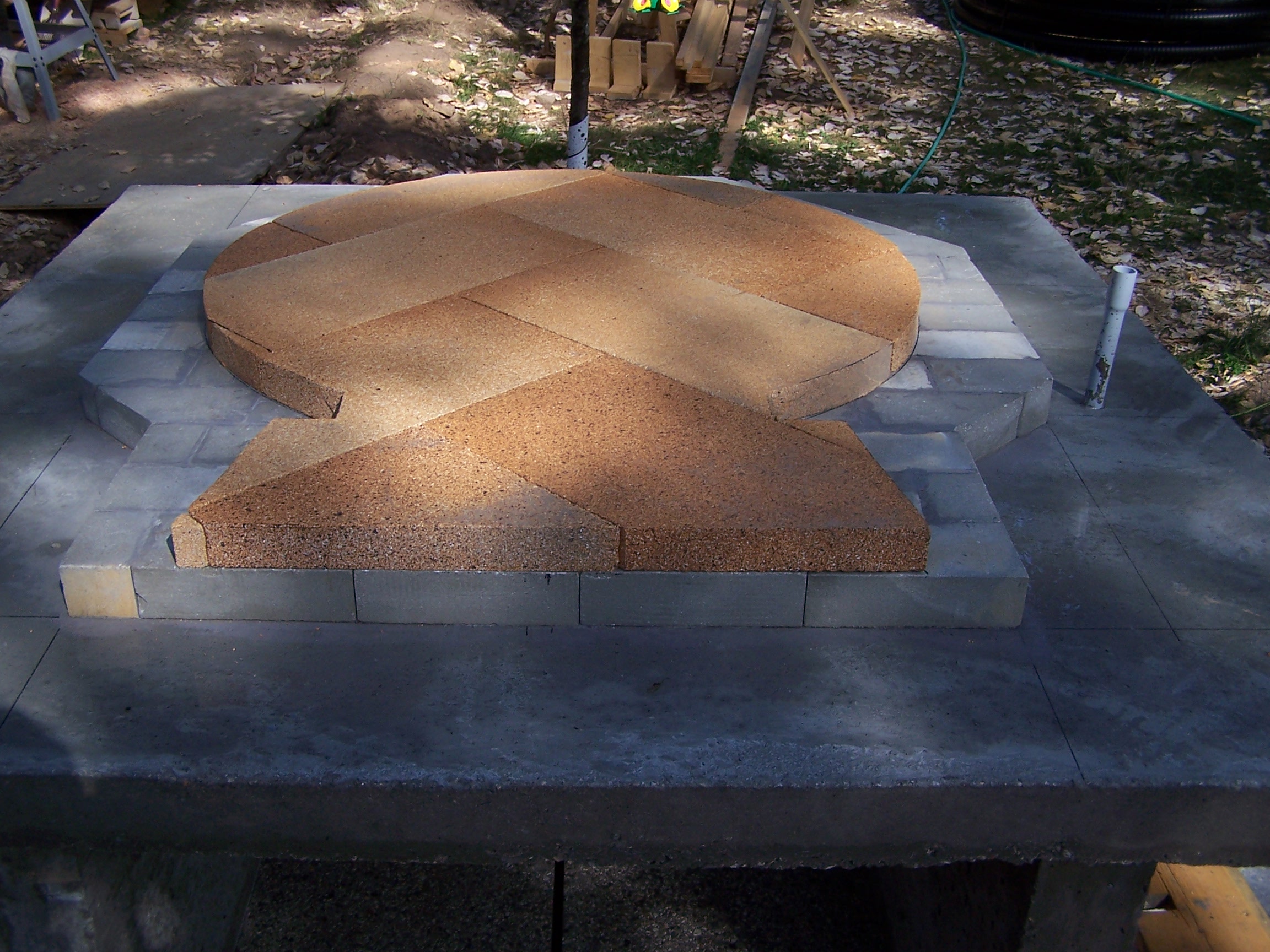

    Thought I would share a few photos of an oven project on Salt Spring, Canada. This forum is a fantastic resource for ideas, and I am hoping this project can add to this.
    I was hoping to post photos as the build progressed, but it went so fast, (3 weeks), that only now have I been able to surface and share on line.
    This picture shows the "skagit" firebrick, (12x24" firebricks), cut to fit a 42" hearth and landing, sitting on a base of IFBs, (insulated firebricks of calcium-magnesium cilicate. Same as the board but in a 9" brick dimension.
