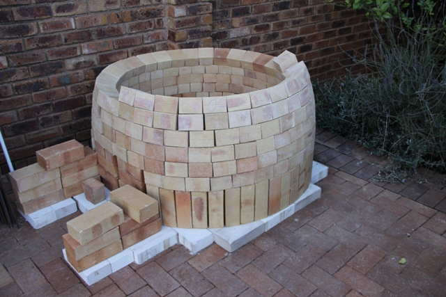

Design objectives-> leave as liitle mortar between bricks as possible - cut each brick to size and fit.

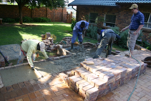

3. Build the base (Foundation)
4. Building the oven and braai area

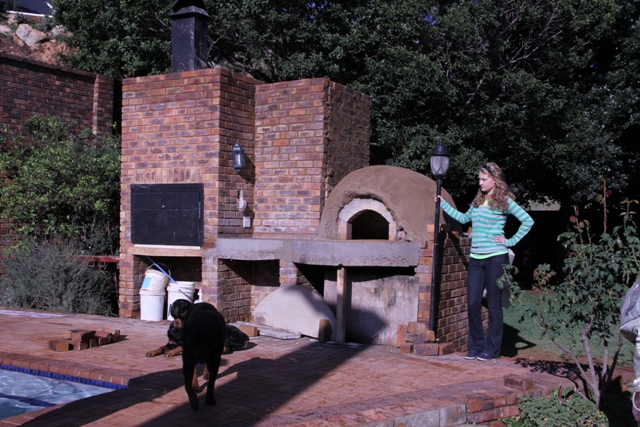

Currently I am at this point- also requiring the entrance and the flue to be built. Then we need to make it look pretty.
