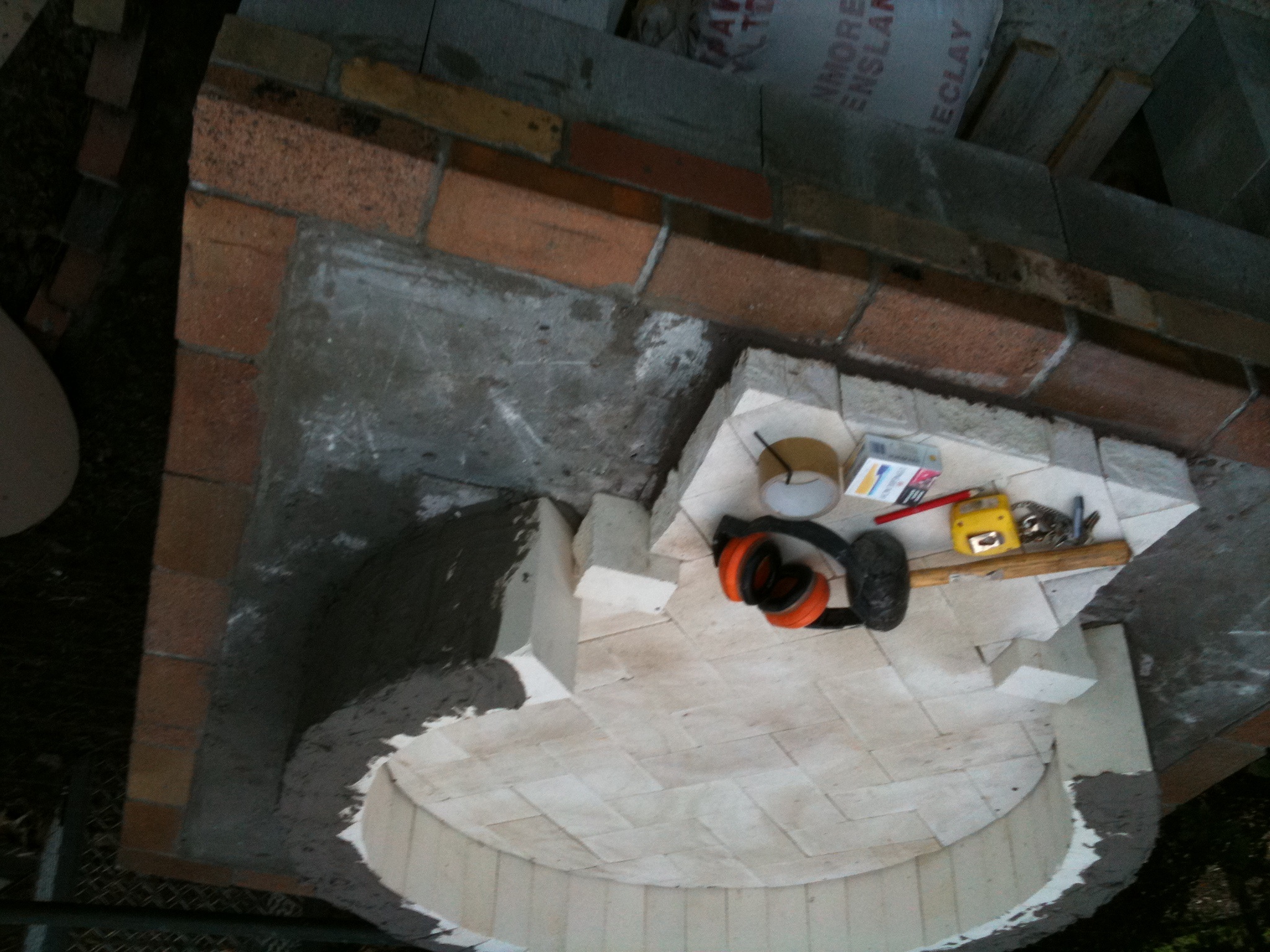

          started to lay the floor bricks..got through 3/4 but my son who decided he doesn't want to have his 2 hour sleep in the middle of the day anymore woke up after 1 hour!!! i think he knows when its oven time......so the rest will have to wait until tomorrow!

            Try laying on the 45 rather than they 90 if an edge pokes up you only have you peel glance of it rather than doing the dead stop thing. If you have to grind in years to come it will only be a corner rather than a whole edge.

            No more complex cutting required really . This was all cut with angle grinder a brick bulster.

              argh...that is such a good point. missed that bit in the plans. so obvious though...
              what to do. should pull them up but ive run out of fireclay that i had left for bedding...and its 4 weeks off anymore.
              reckon yellow brickies sand mix (22%clay) would do as bedding?
              see this is why i love and hate this forum...love it for the right ideas, hate it cause now i have to re do haha.

                Scrape off the fireclay sand mix and rehydrate it .....
                A simple way of doing this is one of those 20 ltr paint tin mixers on the end of your electric drill and a 20 ltr plastic bucket. Takes the pain out hand mixing small amounts.

                  Much happier with the re work...re did the floor on 45 degree angles (herringbone). all nice and level, ready to start the dome.
                  using that paint mixer on the end of a drill is an awesome idea. worked a treat. i think i'll be using that method for mixing my mortar...screw the cement mixer for the smaller amounts.
