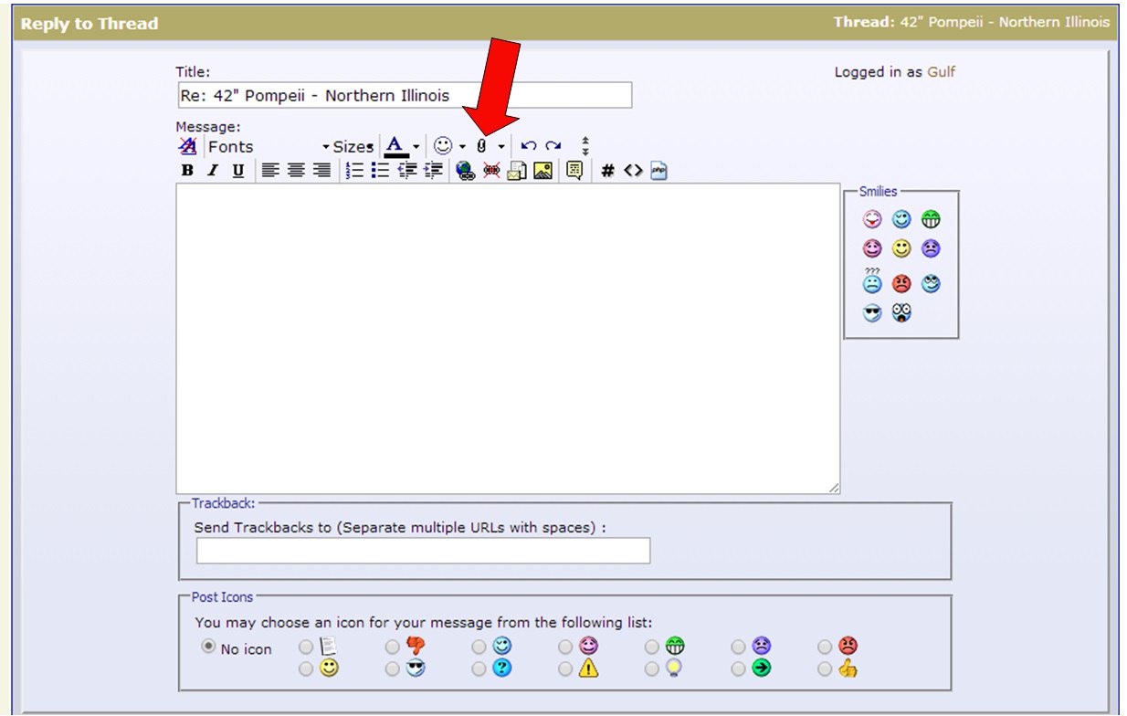

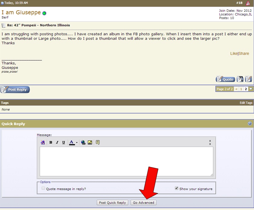

        I am struggling with posting photos?.. I have created an album in the FB photo gallery. When I insert them into a post I either end up with a thumbnail or Large photo?.. How do I post a thumbnail that will allow a viewer to click and see the larger pic?
        Thanks
        Thanks,
        Giuseppe
        pizza,pizza!
          #19
          Re: 42" Pompeii - Northern Illinois
          After selecting reply to post, click on the Go Advanced button at the bottom of your post. It will look like this:
          Now click on the small paper clip. This one:

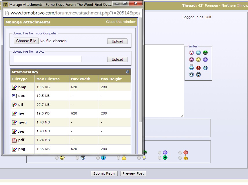

          A Manage Attacments box will pop up that looks like this.
          Use the Choose File selection to find the pic on your computer. Then select Upload. You can upload several pics, one at a time. Then go back to that same small paperclip. Click on the small drop down arrow by it.
          The Manage Attacments box will pop back up with your selected pic files. Then just post your pics to your reply .

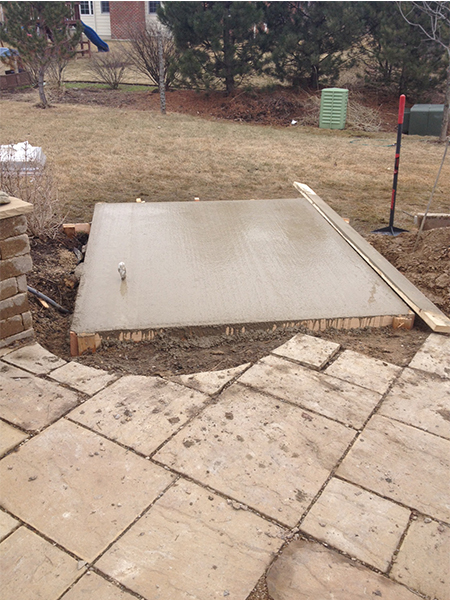

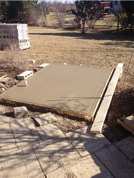

              Stonecutter… Don't know that I'm patient enough to wait two weeks to start on the block work I appreciate you comments I left it exposed for a few hours today and recovered. Seems to be setting up nice.
Name:	Pour day 2.JPG
Name:	Pour day 3.JPG
