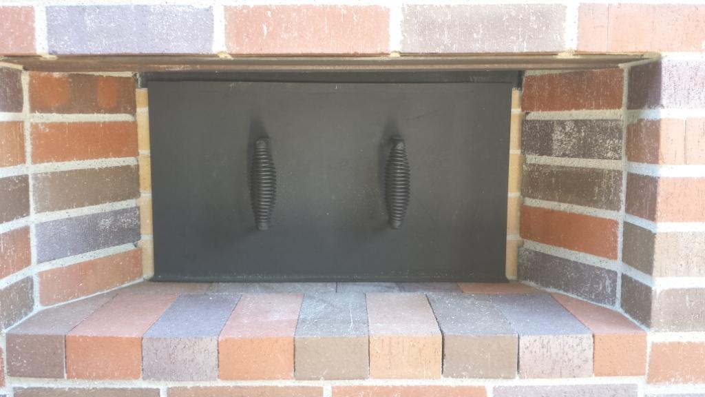

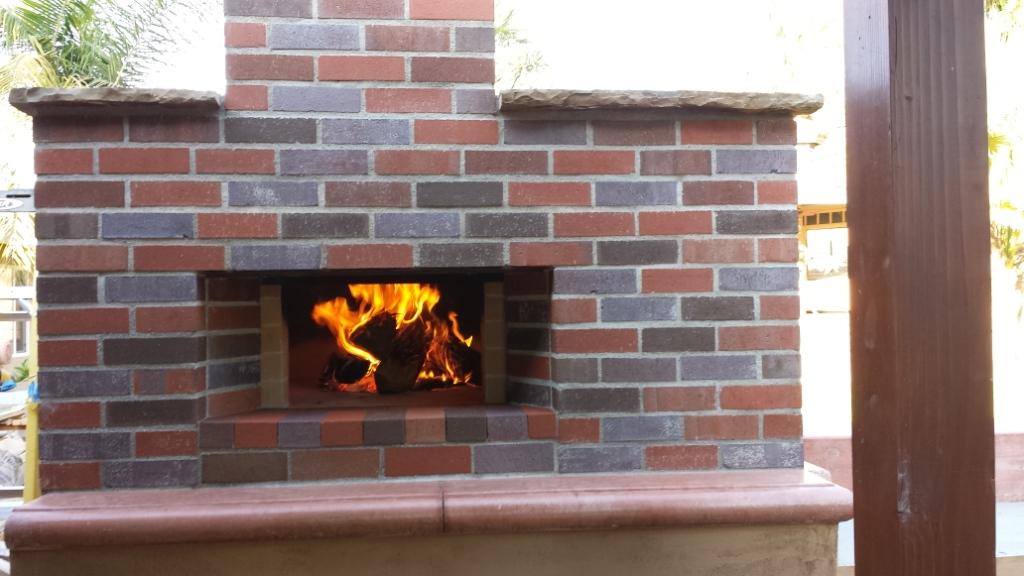

    Just finished my oven/BBQ island/fireplace build, I have posted a few pictures of the results. I had an oven door built by a welder that looks great BUT the metal door is sucking the heat out of my oven, the entire door gets blazing hot except for the handles. My neighbor suggested putting a piece of wood on the front of the door, I would really like to keep the metal look on the front of the door.

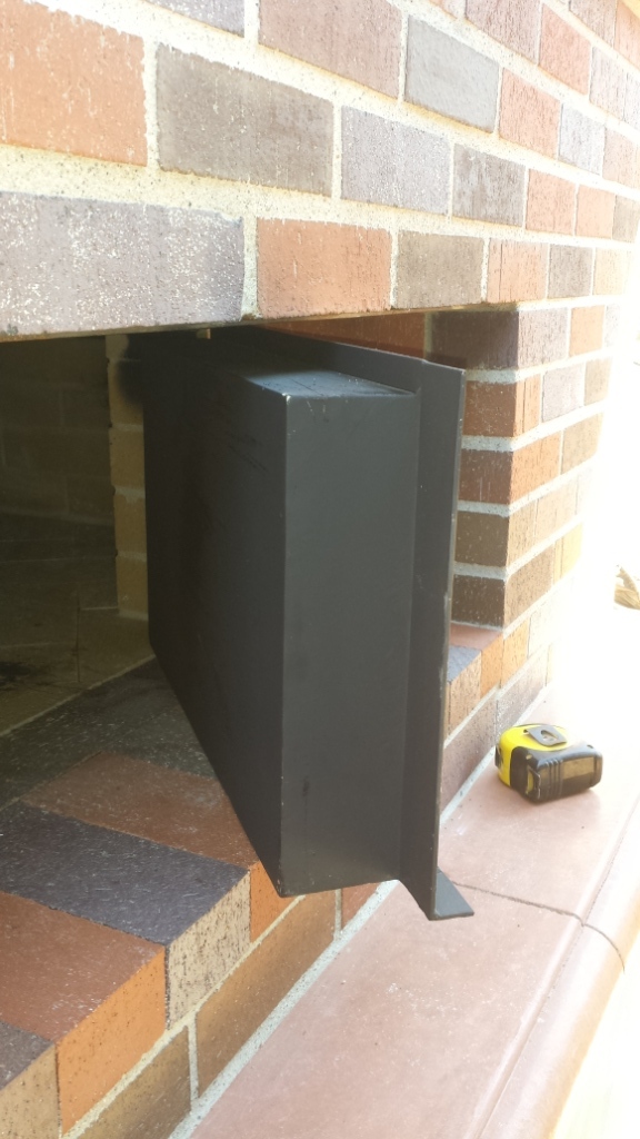

    The door has 4" insulation block sandwiched between the metal.
    What do you guys suggest to do to stop the door from sucking out all the heat from the oven?[ATTACH]Click image for larger version

    The door isn't sucking the heat out of the oven. It's holding it in. I have a similar door and it gets hot when I use it to snuff the fire - but I've never really thought of it as a problem.
    Carbon steel is a decent heat conductor, so the door is going to get hot, not much you can do about that. Looks like you have more than enough insulation inside of it to hold in as much heat as it can. What escapes is coming around the edges and conducting through the thin sheet (which heats up pretty easily)
    Wood on the outside might make it cool to the touch, but isn't going to do much to keep the metal from conducting heat. You might try putting some fireproof gasket around where it touch the opening if you want to reduce the airflow out of the oven.

        The only improvement you could make is to have a thermal break from the oven with a gasket around the door and then have a thermal break from the internal part of the door to the external part.
        Some kind of gasket between the internal tray and the flat face of your door.
        Pretty sure the difference would be minimal though.

              It wouldnt really matter how much insulation you had in the door if the front is attached to the back with the same material the bit nearest the fire will get hot and transfer heat to the the rest of itself.

                Totally agree so if he wants to prevent the heat loss he would need an insulated panel outside the door and independent to it , I don't know how long he hopes to keep the oven hot but do me it sounds like a lot of effort

                  Its possible to do. I have 2 ins of airated cement block carved to fit the oven mouth. 10 mm ply sheet glued with silastic to the outer face, hardwood face and handles on that. Handles and outer face never get hot.
                  Disadvantage,its heavy roughly 10 kg, there delicate its possible to chip them and I cracked my first and it still worked.
                  Advantages, they work and work well, no hot face. Cheap and easy to make, my oven is in its secound in 4 years.
                  They mighten suit everyone but they work well. Not my idea either, came from another member who had made on as a temporary measure and it worked to well to bother to replace
