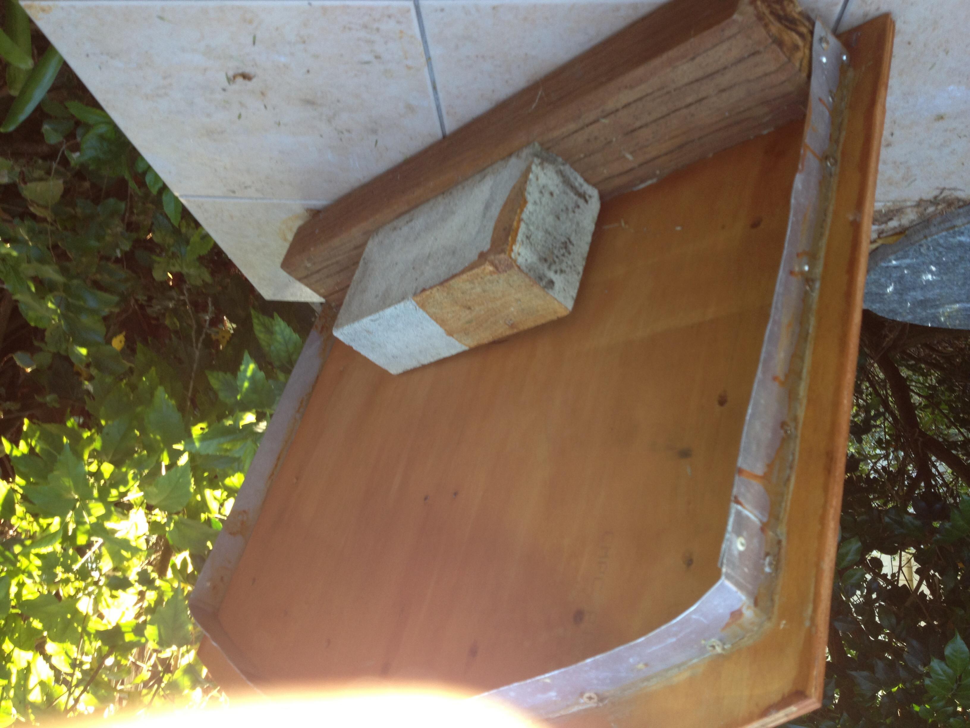

      This is my experimental external door. The aluminium collar fits in the entrance and prevents rain from blowing in around the face which sits flat to the oven entrance. The block of wood and the fire brick are angle up slightly and the weight keeps the top of the door hard up to the entrance. It needs a proper rebuild now that it works. But like most things that work I'll get around to the rebuild in time.
      If you outer brick is firebrick they are not waterproof in any way and will soak up moisture. A non membrane type sealer would help, one of the ones designed for brick and sandstone. They might need reapplying from time to time as I don't know how they are effected by heat.
      Hope something helps
      Ps sorry about the upside down pic I've only got the phone at present
