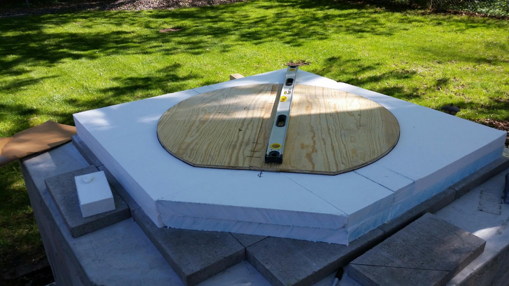

    I am almost done with my 40" oven. I did go with 4" of ceramic board insulation. I used 6 24"x36"x2" pieces to do the job. Other than the corners I couldn't have gone with much less than what I used. It was nice to not have to deal with the vermicreete, but your buget Wil dictate whether that is do able. From my quick math you would need almost twice as much. But if you angel the corners you might be able to save a little. From my early useage I am very happy. I have no door and was 375F 24 hours later and 175F 40 hours later. I have to think the floor has at least a little to do with that.

          Journeyman,
          I notice you have concrete pavers under your 4 inches of ceramic board. Can you tell me why you decided to add them? I have some laying around, if needed.
          Susan

            Susan,
            I can't answer for "Randy" but, it is an excellent idea! Getting the insulation high and dry above any place that water may pool is a great idea! I've preached moisture barriers between the floor insulation and the structural hearth for a while. Now, I will preach "elevation" and "moisture barriers" .
            Joe

                If the structural hearth is flat, they should just lay there just fine. No need to glue. If they are rocking, a little sand with a notched trowel should be all that is needed to stabilize a level. (But, I'll let Randy weigh in on what he did). A piece of polyethylene plastic, a vinyl floor covering remnant, scrap pool liner etc. or painting with a commercial water barrier will do. The barrier should be placed directly under the insulation imo.

                  Sorry I missed the question. There is a simple answer for the pavers. I wanted to have my floor at a certain hight, and I'd did not want to poor another 1.5" of concrete as my support slab is already like 6" thick. So the cheapest and easiest way to get the height I wanted was paver stones. The biggest added plus is that if water gets in the insulation does not get wet and just sit in the water. I am glad that people like my idea,.
