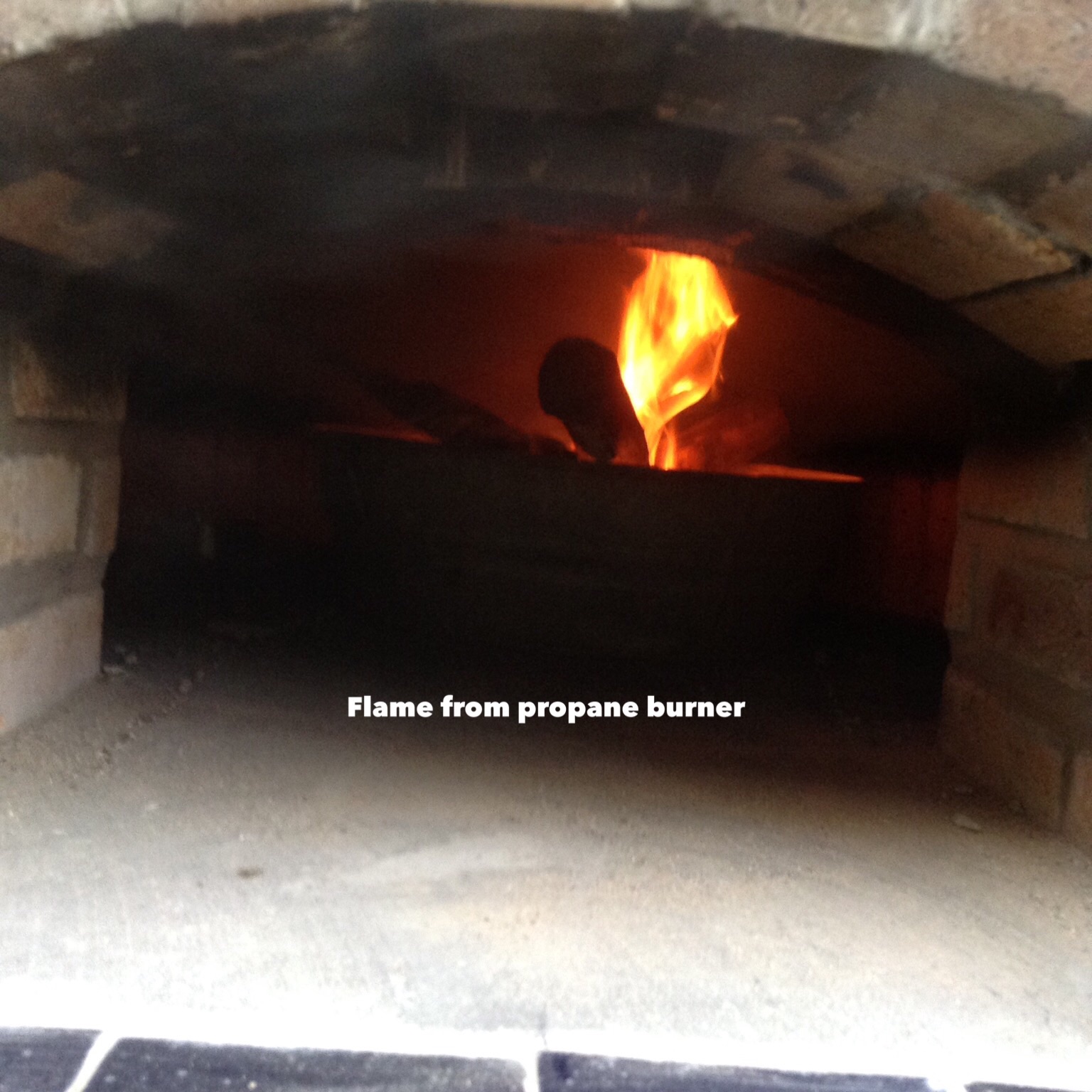

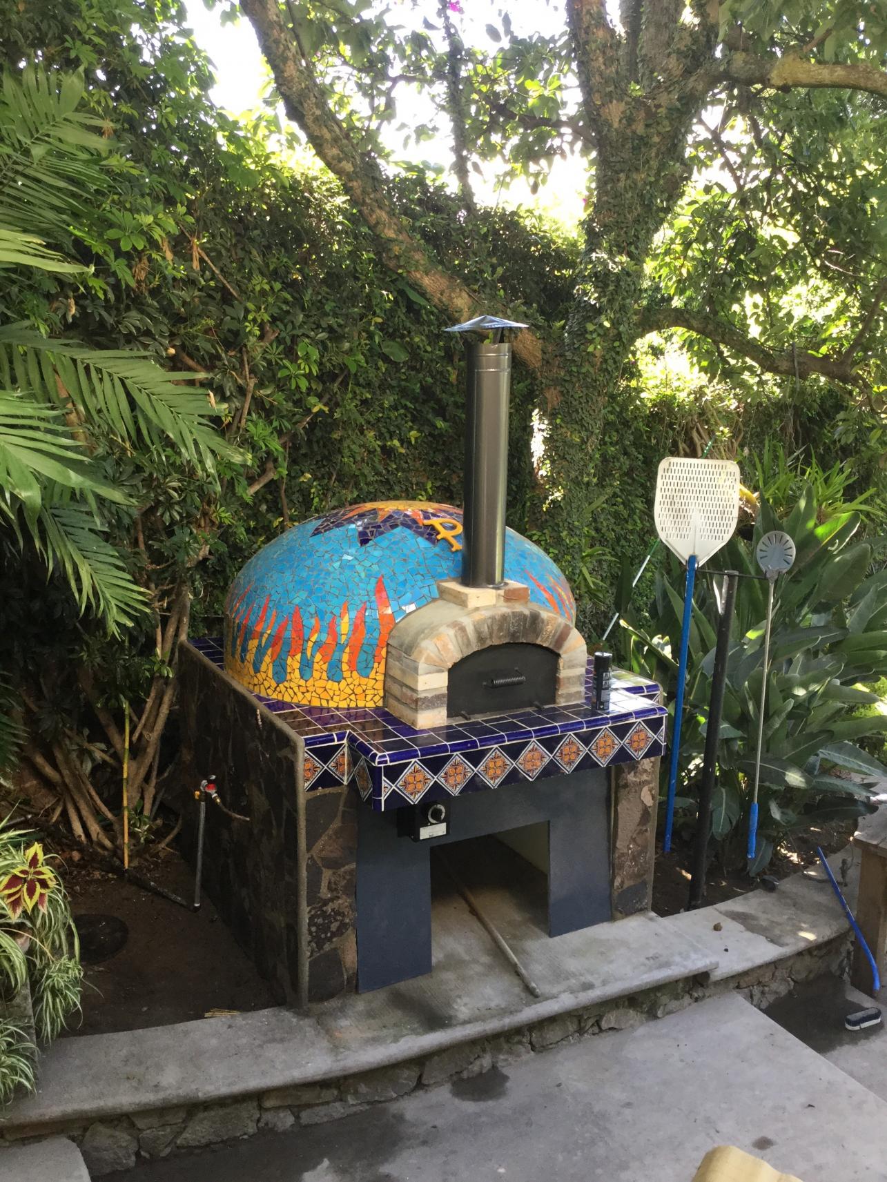

    Enclosed is a photo of my Pompeii 36 inch converted to gas. This is my third dome that I put on the oven. The first dome was 30 inches high, which didn't produce enough top heat. The 2nd dome, I made a mistake and heated it too quick. The dome cracked and was not insulated good enough. This dome has 3 inches of ceramic blanket, 2 inches verm, chicken wire, etc.

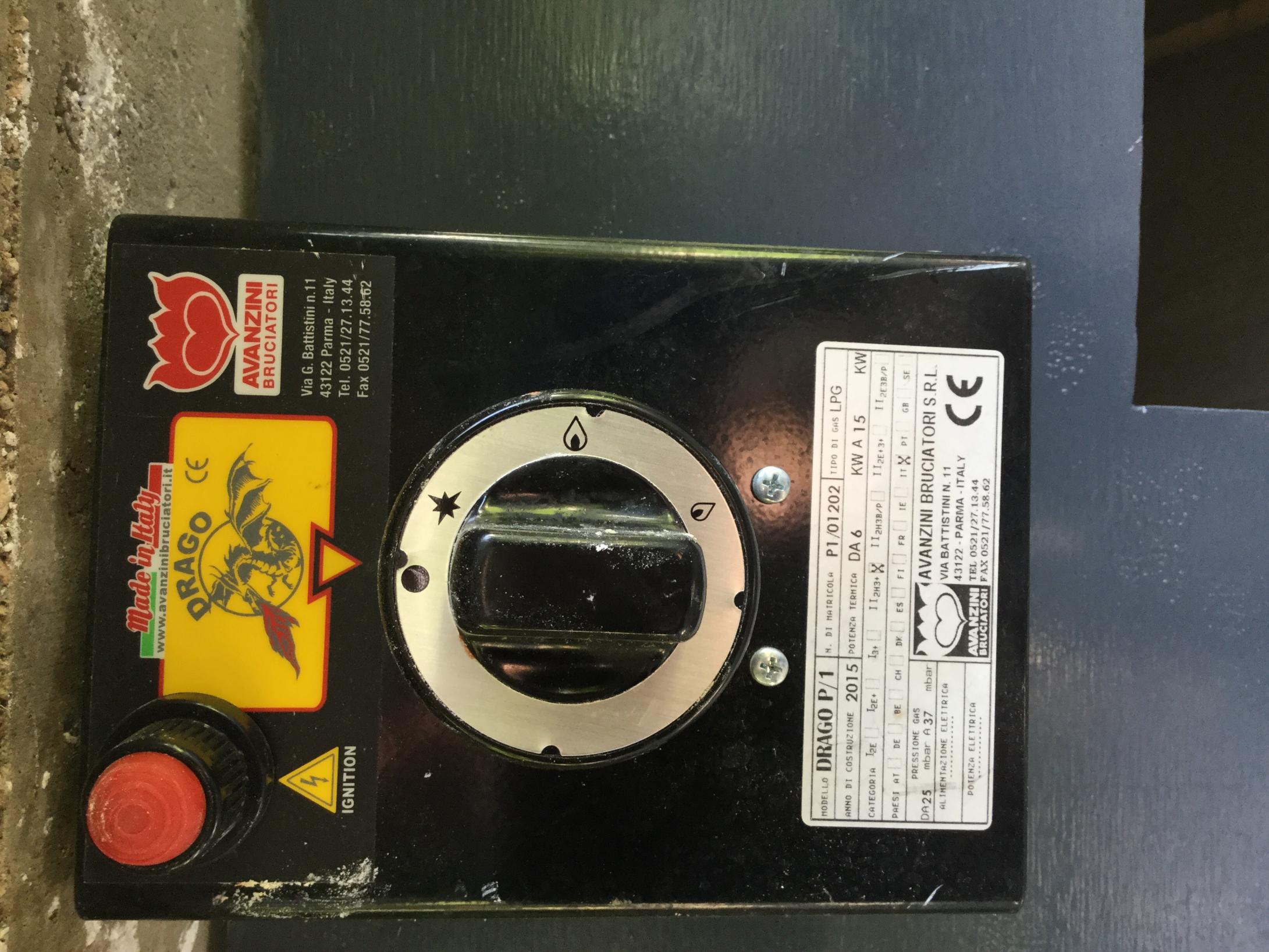

    I also installed a Drago P1 propane burner.
    I've had it to 830 degrees about 10 times with no cracks so far and the outside dome temp is around 85 degrees.
    Love the way it cooks

    That is a beautiful oven, Mexman. The mosaic is excellent! I'm sure that "the third time is a charm" for you. How are the pizza nights coming?

          Very impressive mosaic tile work.

                    Mexman, I'll jump back to this post so as not to further hijack Rocket's post. I see your flame in second picture of post #1 above, but can't tell if the burner is built in, sitting on floor or even sitting on a brick. I have natural gas piped into my patio and was thinking of trying place a burner in the oven for heating then removing for baking. Was wondering what your setup was.
