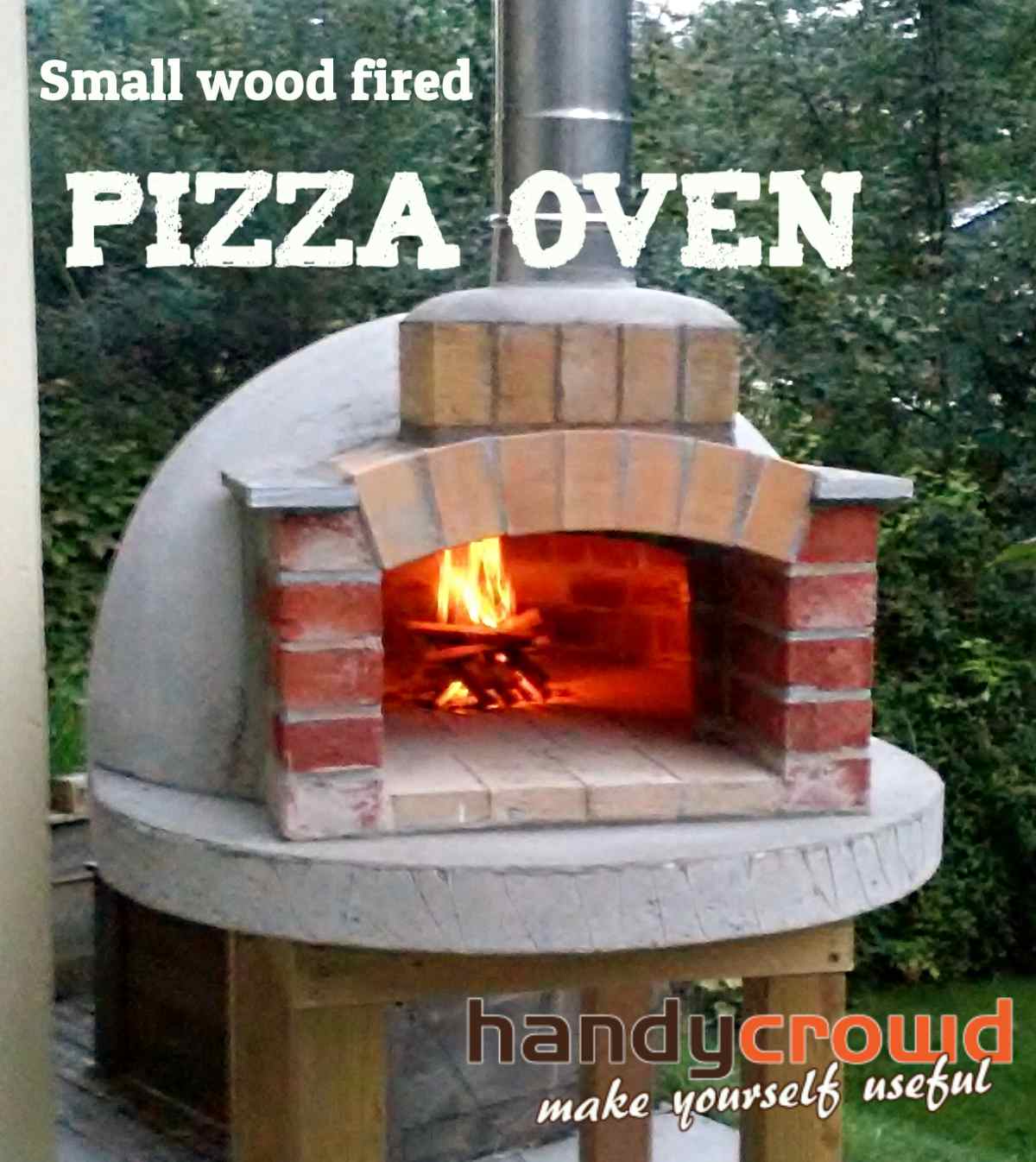

    Finally got around to posting my oven here after about ten firings! All good too, definitely happy that I built what I had in mind rather than a huge oven of the style often described on the net. I just didn't want such a large thing in the location I had available, so I came up with a minimal design that works just fine for an evenings cooking.
    I figured that you can buy tiny little precast ovens so why not build a smaller one? As a bricklayer I was amazed at the amount of overkill I saw doing my research, massive support walls filled with concrete and re-bar etc. I just wanted an oven to use of an evening to cook great pizza with a few bread loaves or a nice roast afterwards.

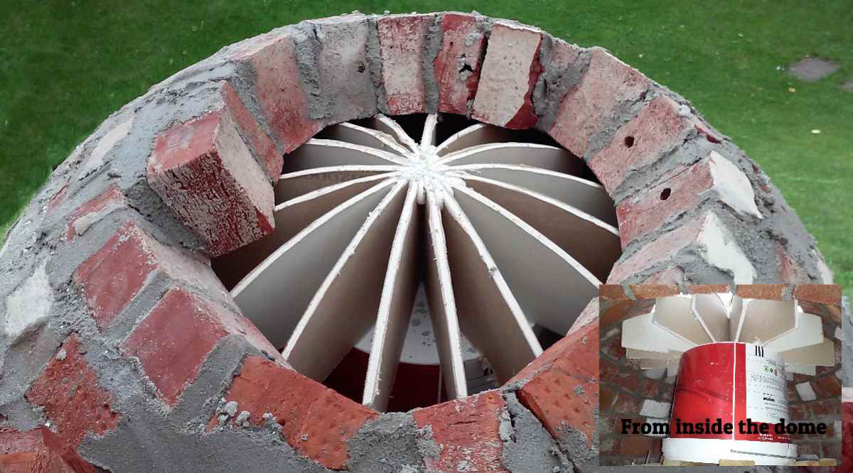

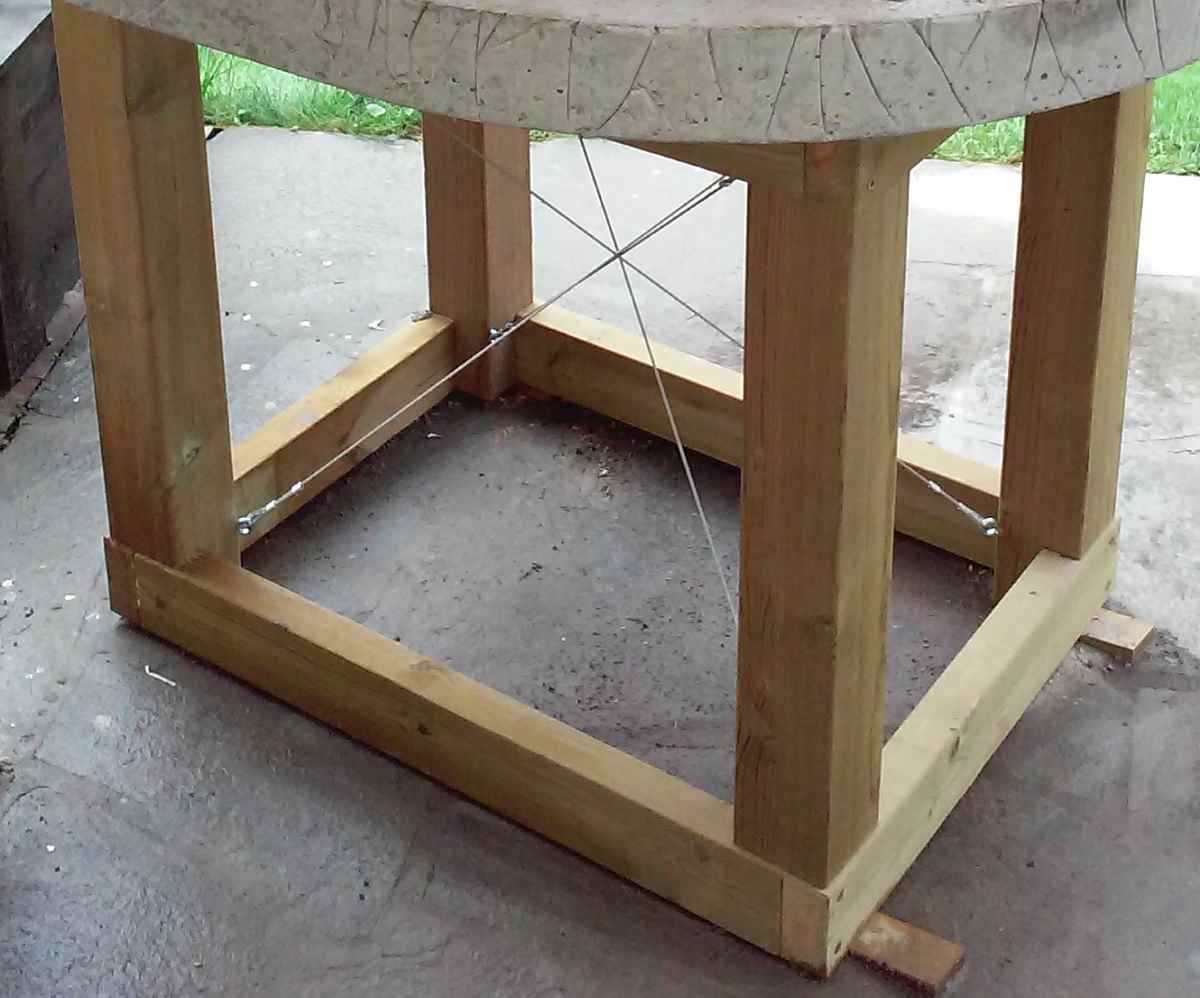

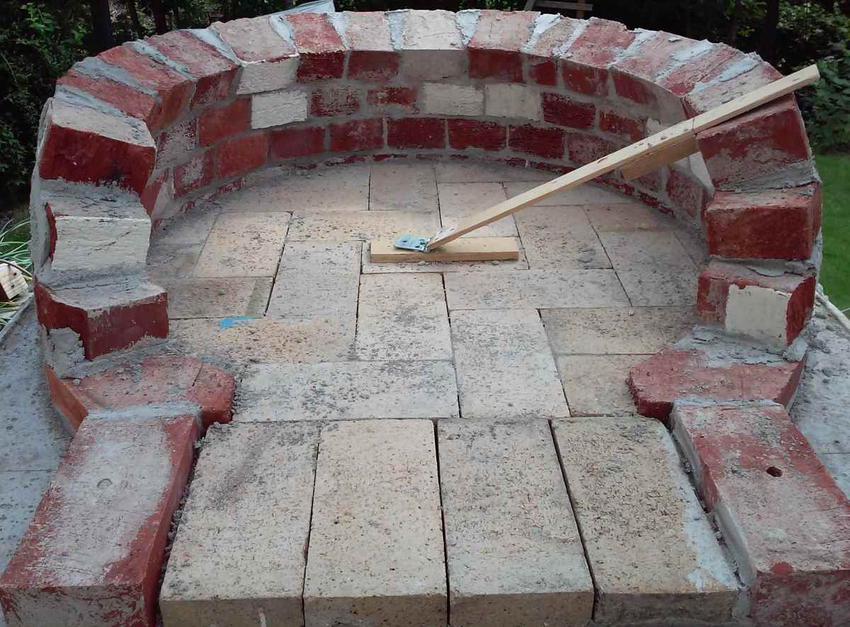

    I posted pictures and descriptions of how I went about building my pizza oven on my blog. I cast a special lightweight, insulating concrete for the base by replacing the stone element with expanded clay balls, worked a treat!
    Here are some pics of the build, hope it's useful to someone, I know how many hours I spent researching before starting to build mine lol! Click image for larger version

    Building a minimal size wood fired pizza oven (75cm/30"). An insulated concrete base, sitting on a wooden frame with a brick dome and firebrick cooking surface.

      I think it's going to be difficult to keep water out of any oven exposed to the elements. You know how water is, it dissolves battleships eventually! Living here in Norway, I couldn't find any proper insulation so I used a few fire blankets. This proved to be a mistake as it didn't provide enough separation between the super hot internal dome and the exterior rendering, causing a few hairline cracks. If I left my oven not covered I'm sure it would soak up rain causing a problem on the next firing. But sure, waterproofing additives can be added to mortar to make it 'waterproof'...... as long as there are no cracks! It might pay to research how stable waterproofing agents are in the presence of a few hundred degrees temperature though.......
      Maybe if I'd used a decent layer, (say a couple of inches) of insulation, the render wouldn't have cracked, but even then, water could get in somewhere. I think in retrospect a pizza oven needs a cover, either a permanent one or a temporary one ( I use a BBQ cover).
      Re the size and materials you have: sounds good to me! Mine feels really sturdy and the timber is nowhere near as big as railway sleepers. Good call on the heater bricks too, super dense and ideal for the cooking surface.

            I totally agree most bases are over kill but in there defense it depends on the ground conditions of the country. (I have not cast a slab for my build just dug down to solid subsoil and no rebar either ) Really like your blog also the use of turnbuckles and wire to stablise the base.
