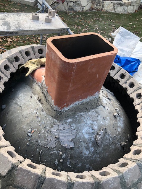

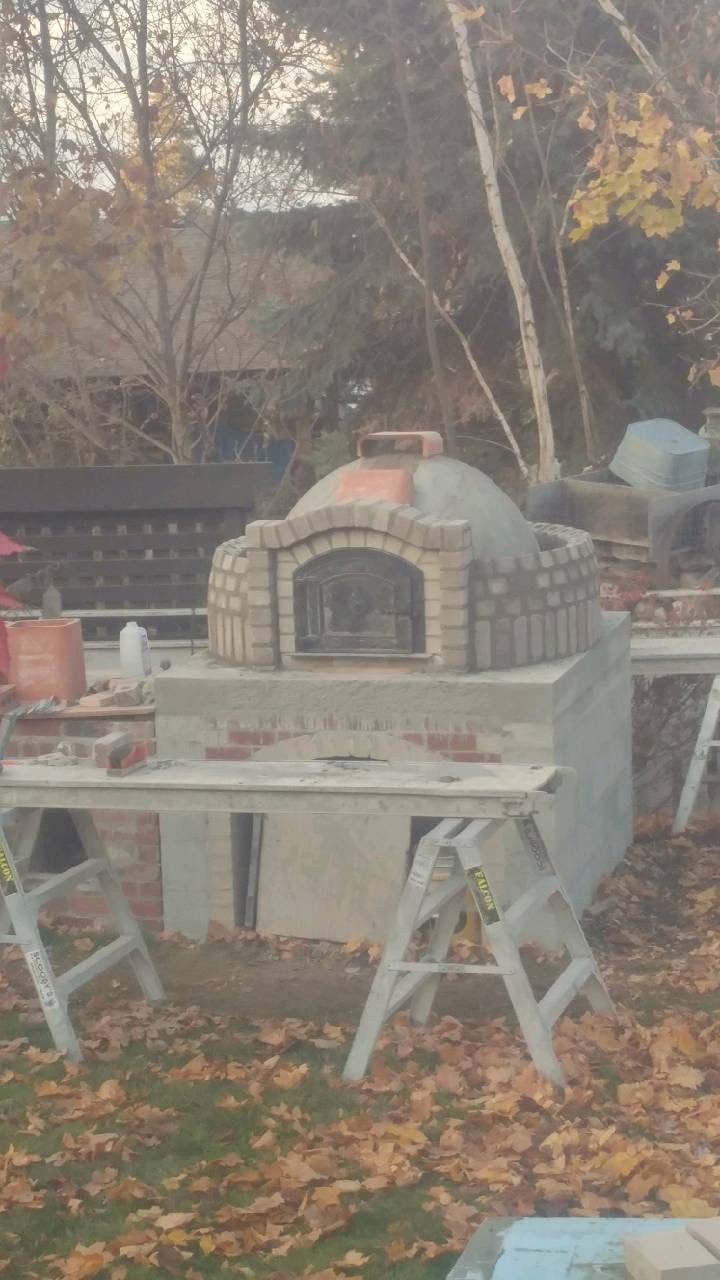

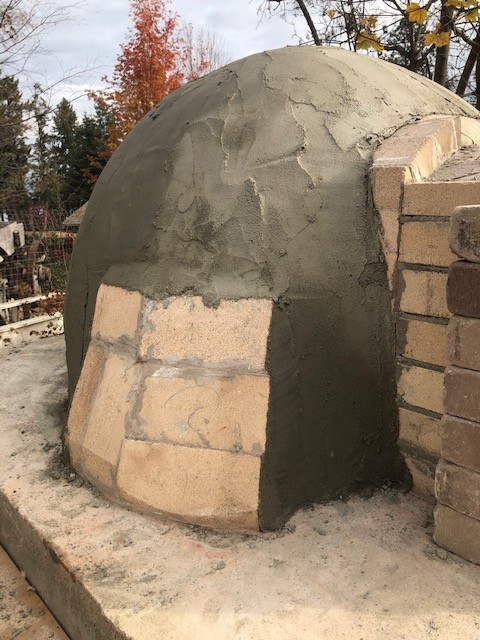

    My mason is finishing up the 2nd outer (cosmetic) brick dome over the initial firebrick igloo dome (that has already been coated with a vermiculite stucco 2" coating) .. and I asked him what he is going to put in the "void" between the oven dome and the brick dome... his reply was that he was intending to mix up the many bags of vermiculite and pour it in ... once he was about 2/3's finished the brick outer dome.
    Won't this be expensive and not at all useful? What about expansion & contraction of the heat of the day (sunshine) as well as contraction (winter) etc... won't this bugger up the outer brick work? Why not simply use R factor insulation (which I already have a huge parcel bag of anyway, as this won't expand/ contract) ? Please ... oh so experienced people here on the forums, ... give me your advice as he is going to be continuing his work tomorrow. FYI, this isn't his first pizza oven as he has built several (of the arch/barrel type) ... but this is his first igloo / dome configuration.

      Here's the update : as I am at work, I texted my mason guy and he said that he is simply pouring the bags of vermiculite / concrete into this circumferential void area as "dry" ... and I guess this means he ain't mixing it with water, etc , ... so it will be just "powder"

        This sounds better to me ... any advice from experienced pizza oven people on this topic?

          That is a lovely looking oven, it might not be the most usual way to build one but I think your masons idea will work very well.
          I am not sure how he will place the top bricks though but having two casements filled between with dry vermiculite will give a very good insulating effect.

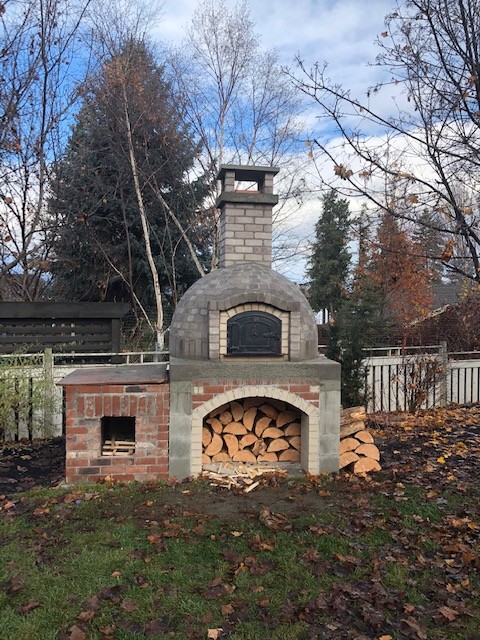

                      Here are a few photos of it at earlier stages to give an idea of construction. Yours will be fantastic.

                        And the finished oven..... How has yours turned out?

                          wow, your oven looks fantastic. I sure do like the prep station of black onyx granite (slate?). Mine isn't finished yet but it is fully functional. All i have to do in the spring is to place two countertops and the cosmetic stone masonry on the lower foundation, as well as mason in a cast iron door for the smoker, then it will be completed. Unfortunately, with the colder Canadian weather, masonry can only be performed in fair weather and this won't happen until March.
