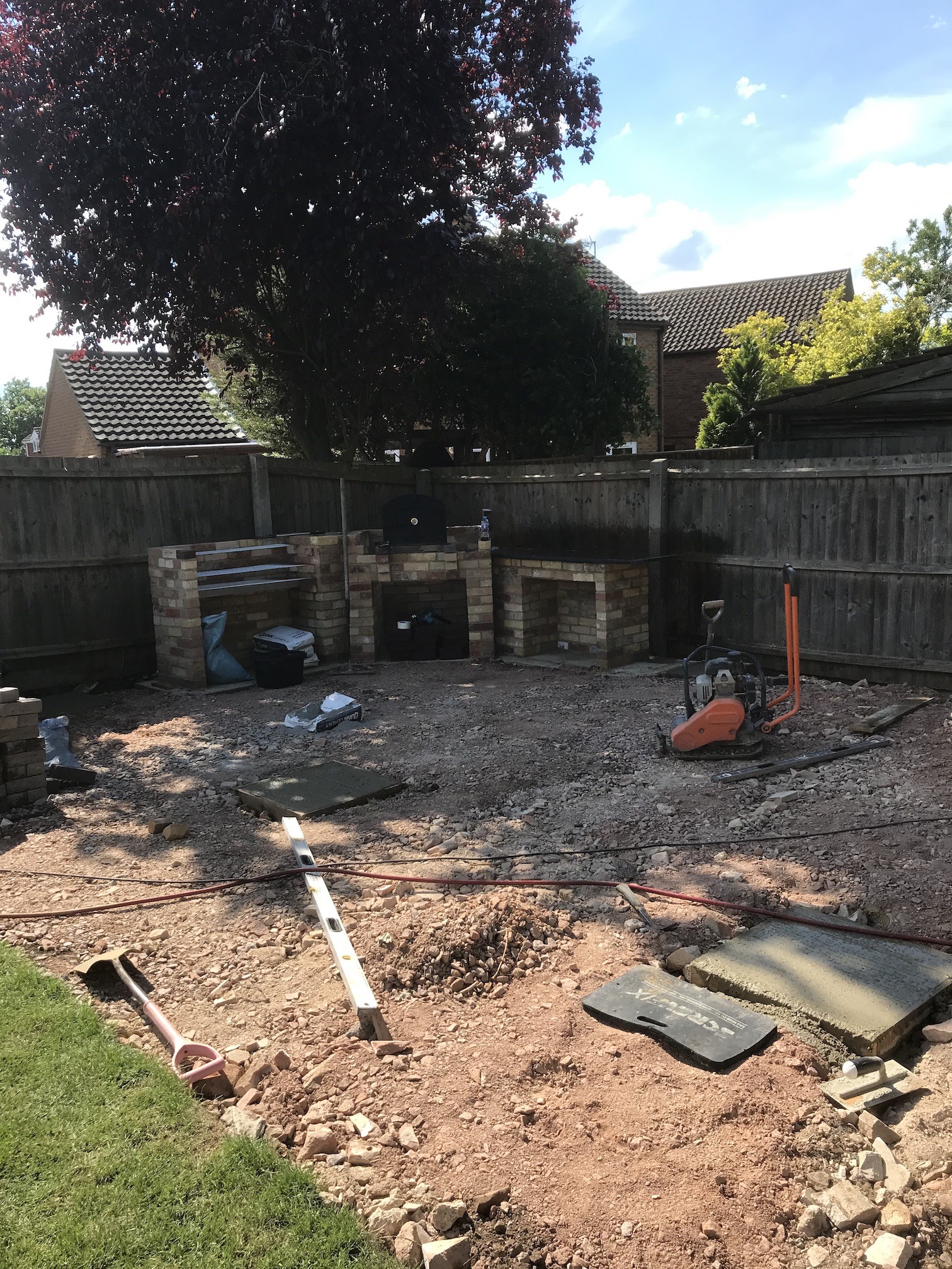

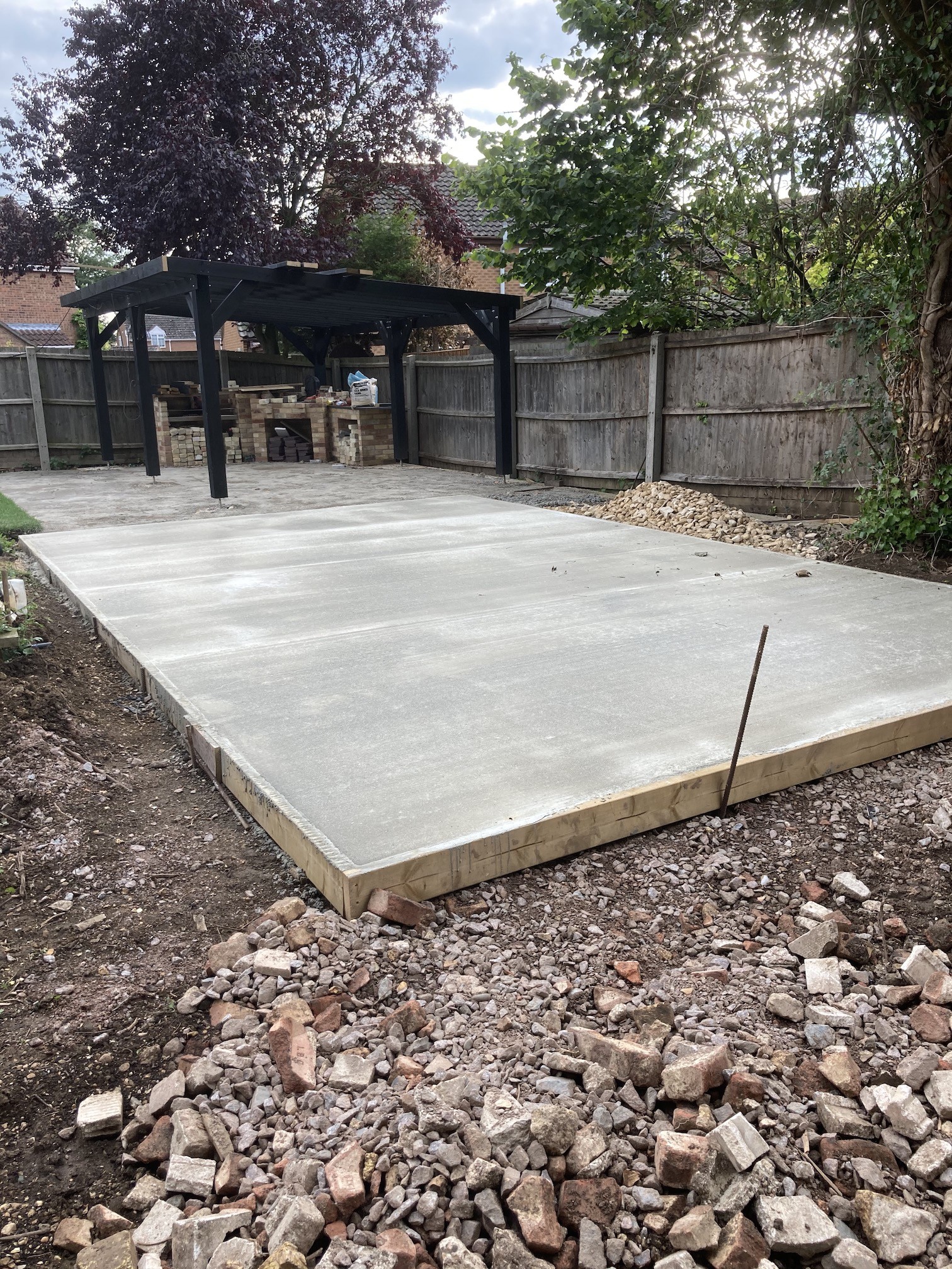

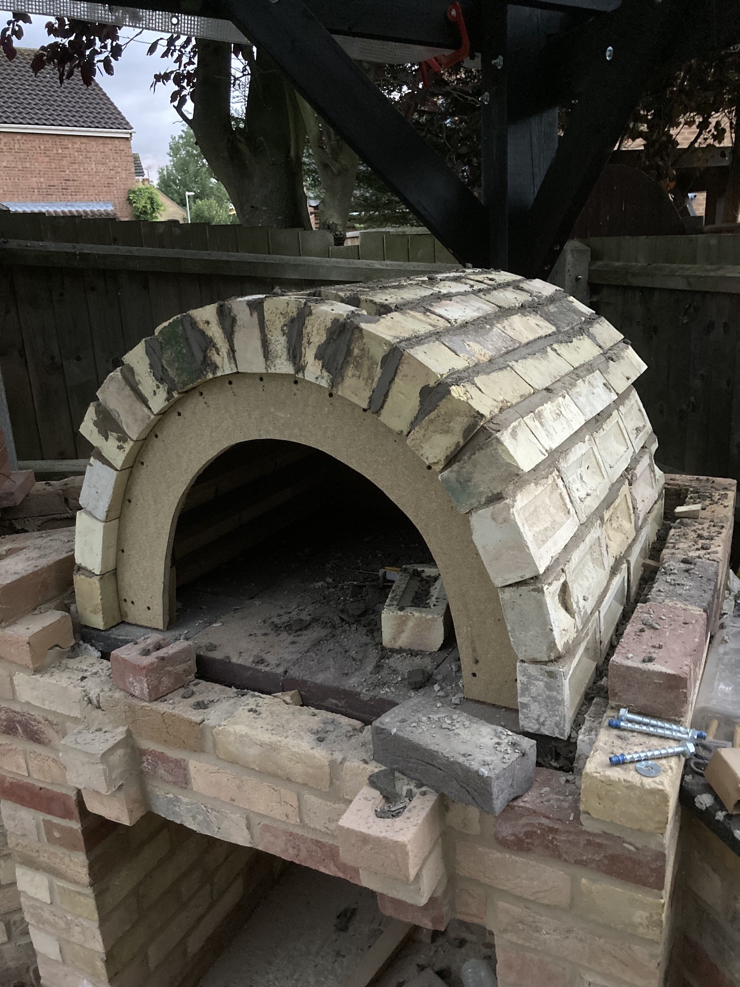

ID:	426730 hi all building my first oven more pics to follow

    If you have not already done so, download the eplans from Forno Bravo and review. Also, several UK cast builds going on right now under "other type of ovens"
      Removing your mould may be difficult. Be careful not to damage the brick vault. The normal procedure is to sit the mould on wedges so the mould can drop for easy removal.
