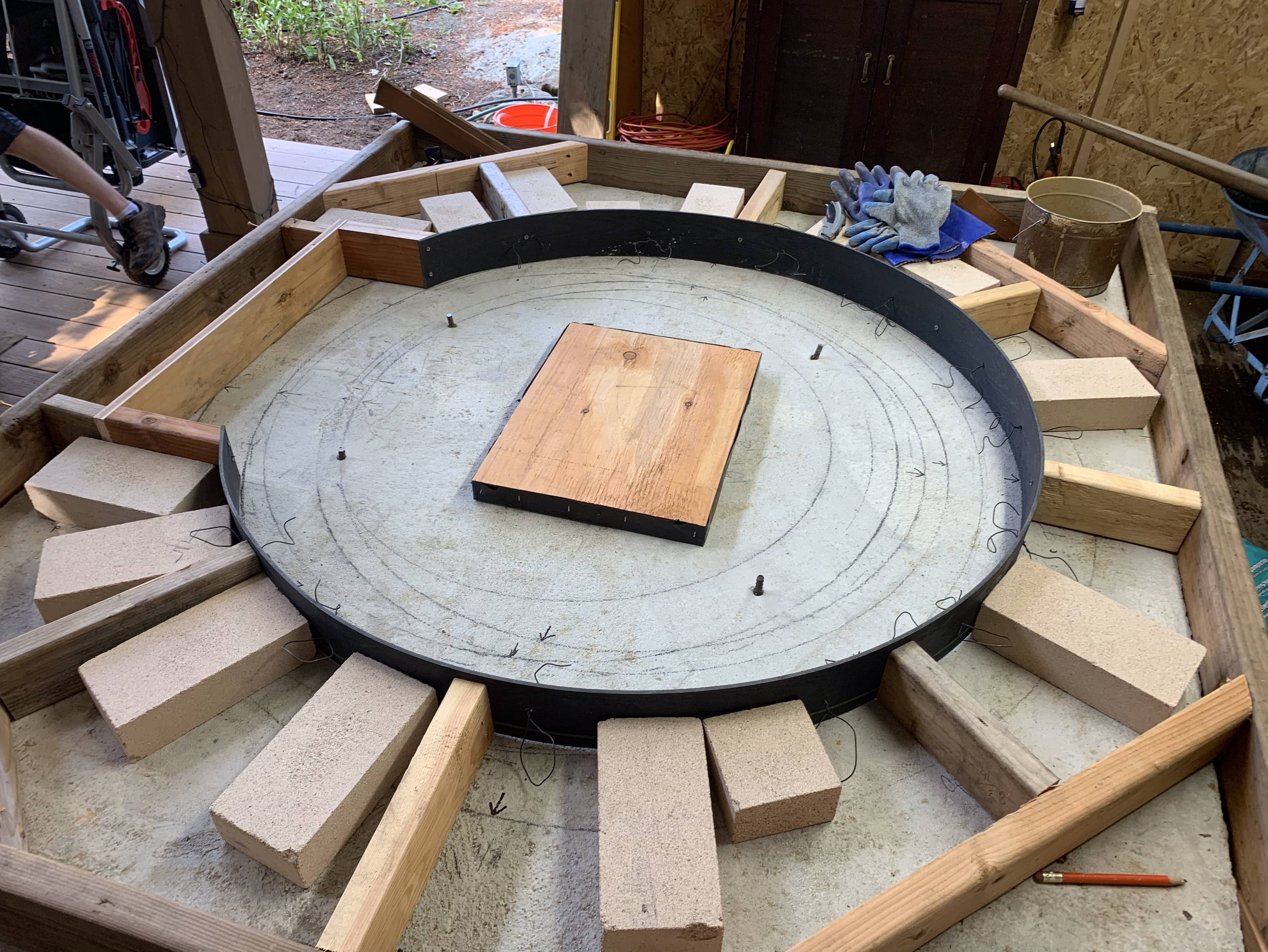

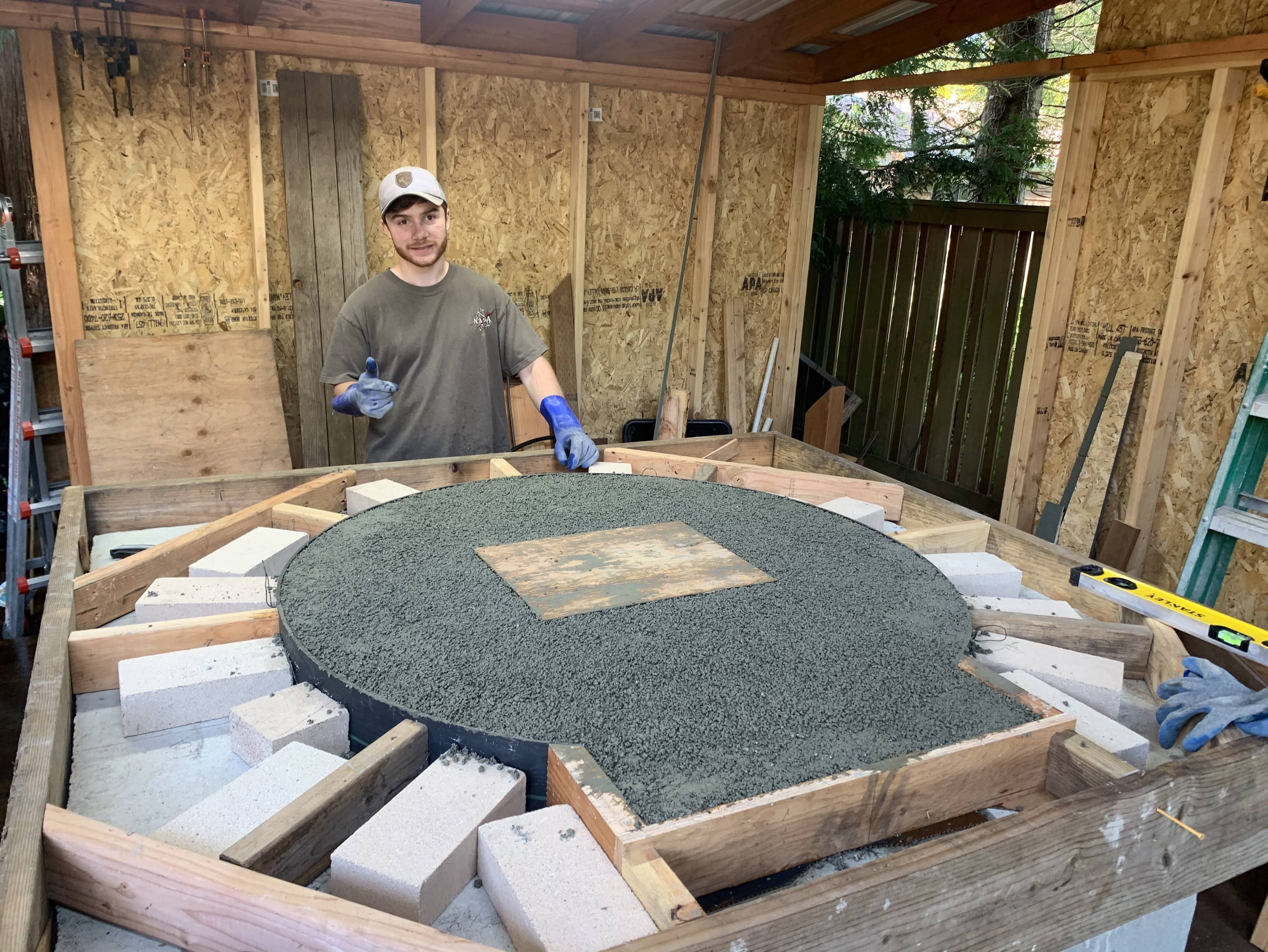

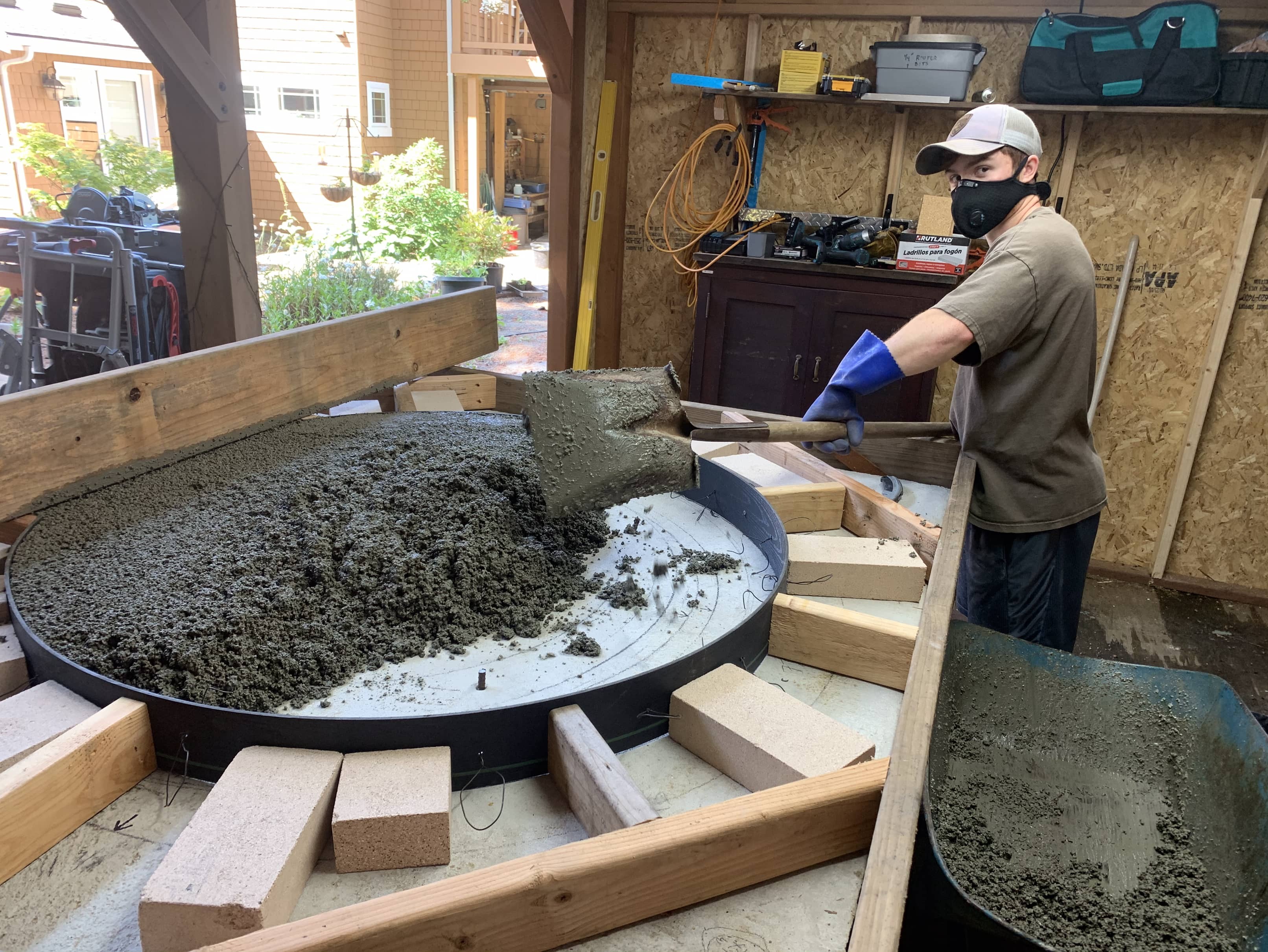

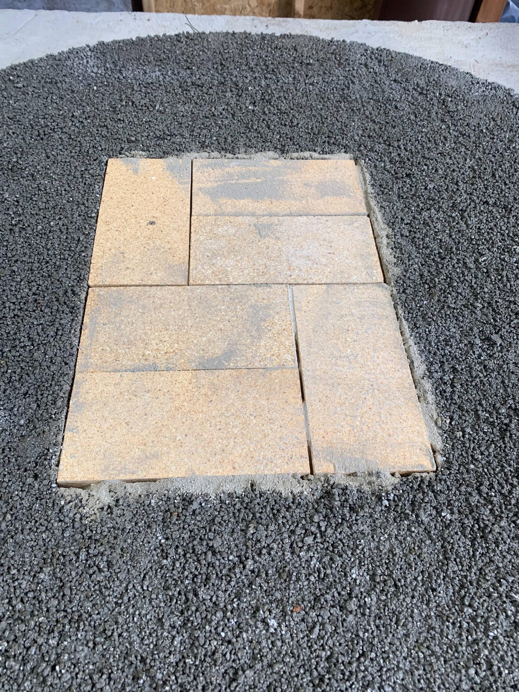

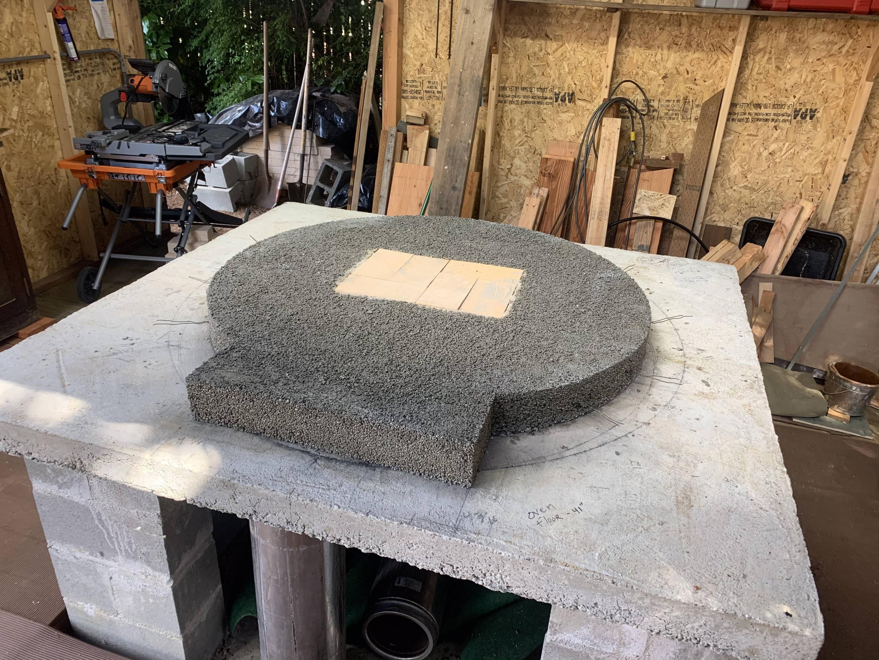

We mocked up the forms a week ago Friday and I pondered them while having my coffee Saturday morning... After 4 shots of expresso I realized I’d made the round form for the insulated p-crete pad a bit too large. Easy fix as my form material is plastic garden edging (ripped down to 4”) that cuts nicely with a sharp utility knife. Perhaps I overstepped my “serf” status by adding a cavity in the center for 1” firebrick but I’d read that having a little more mass in the center of the floor could be beneficial for baking breads. And my sweet wife is definitely planning to bake bread with her sourdough posse! The P-Crete was mixed 5:1, perlite to mortar and the forms were filled with 6 cubic feet of perlite and about 3/4 of a 90 lbs bag of mortar. We covered the entire form with 6 mil poly to slow the curing process in the summer heat. We returned to this project on Friday, stripped the forms, sprinkled some ground fire clay into the center cavity and laid the 1” bricks in to test fit then recovered with the 6 mil poly. Also note I added 4 rebar pins into the structural concrete base projecting up into the insulated base and added steel wire to p-crete form for attaching the wire mesh that will cover the ceramic blanket insulation later.

I'll be interested in how you like that thicker section in the middle of the cooking floor. It will be a cooler spot during shorter firings and present you with two different floor temps when baking or having pizza. I have put a lot of bread through my oven with just a single firebrick thickness on the cooking floor and not sure if I'd like to have to work around a cooler or hotter middle section. But if you're only baking a couple loaves, then having choices will be a wonderful option. My angle is that I load the oven with 8-10 loaves each batch and having to "hit" the right spot would make my load limit smaller each time...but that's me...

I appreciate the input particularly about the additional mass of the 1” fire brick under the standard oven floor bricks. I cast the space for those additional bricks in the insulated base a 1/4” larger than the bricks themselves and set them in fire clay with the idea that I could remove them if they were dysfunctional in my real world use. It might be a challenge reach in the oven door to pull up and the remove the floor bricks to get to them and replace with ceramic insulation board but I liked the idea for big batches of bread!
