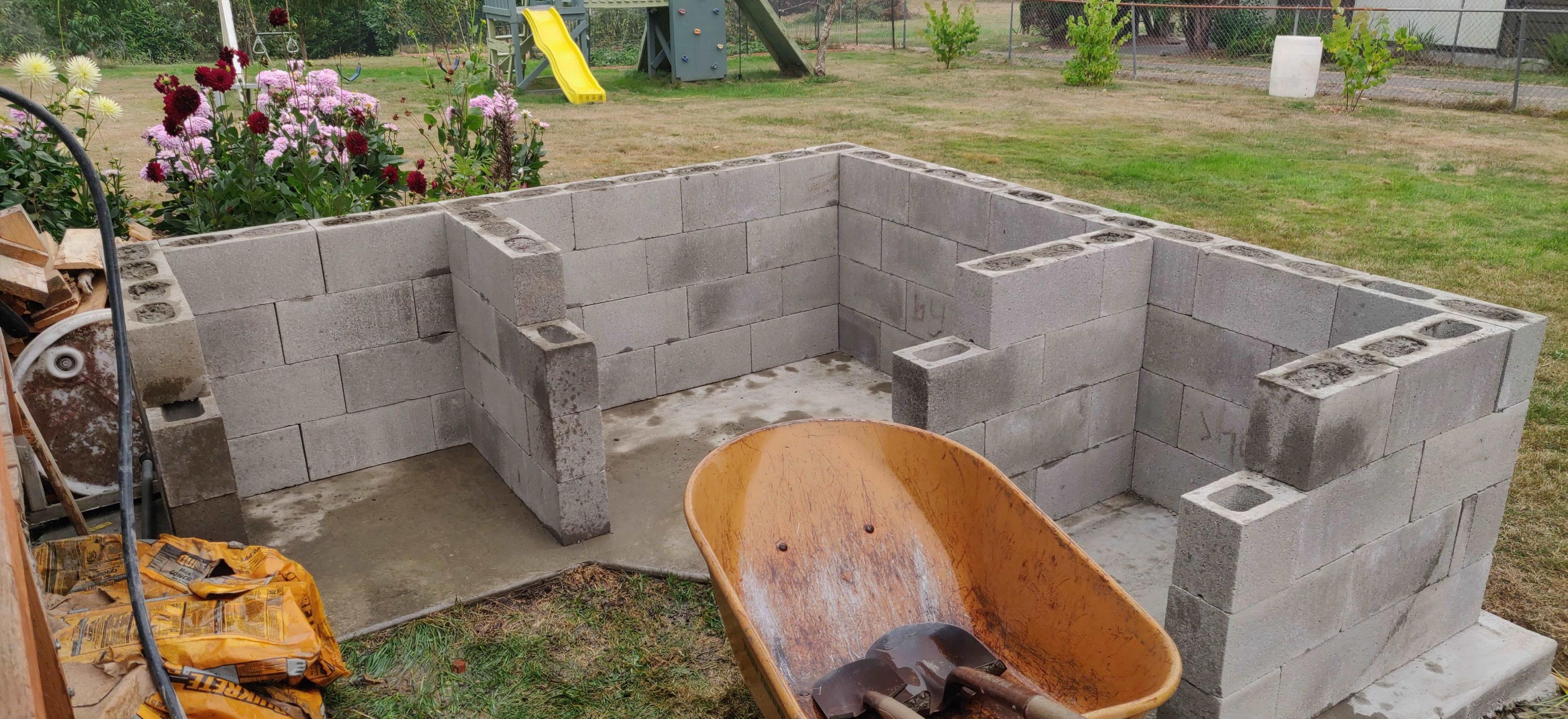

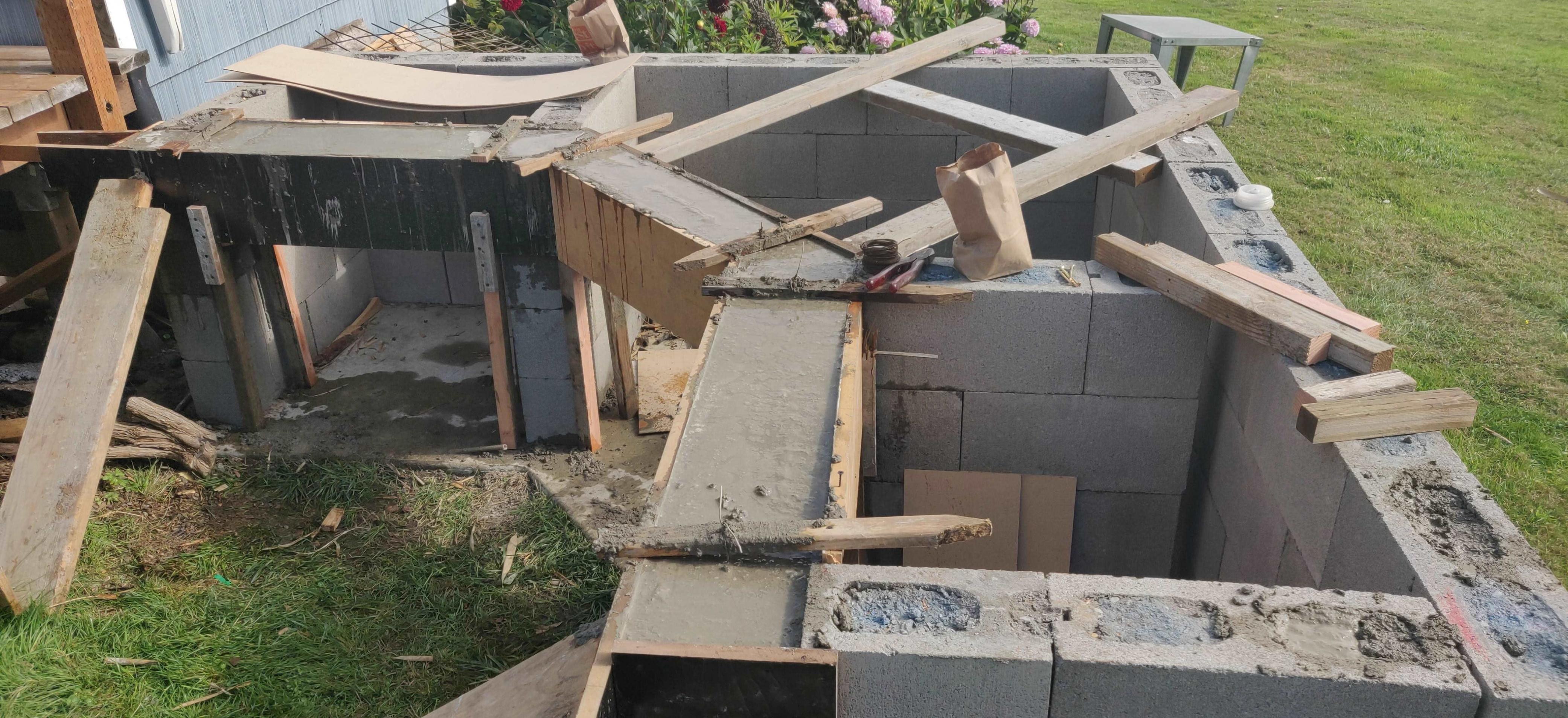

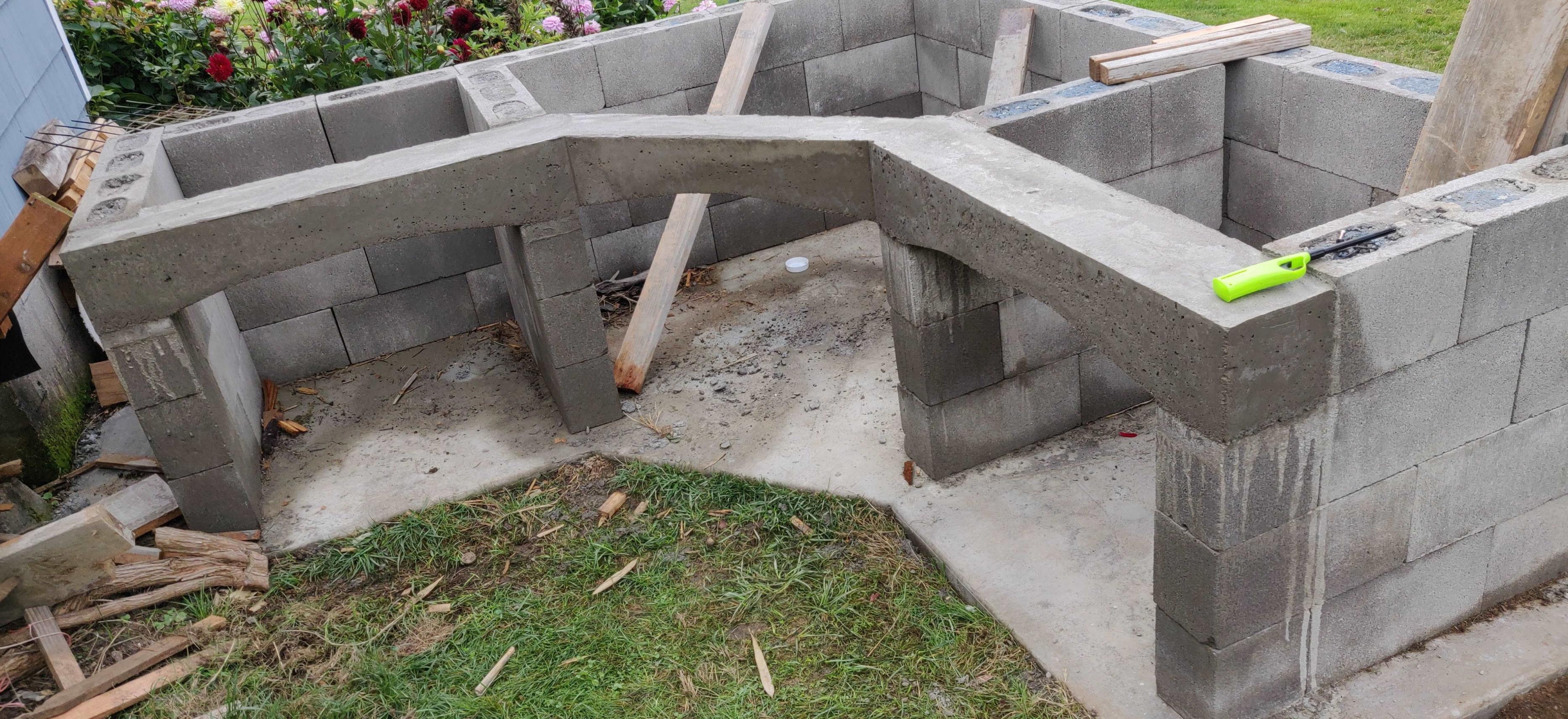

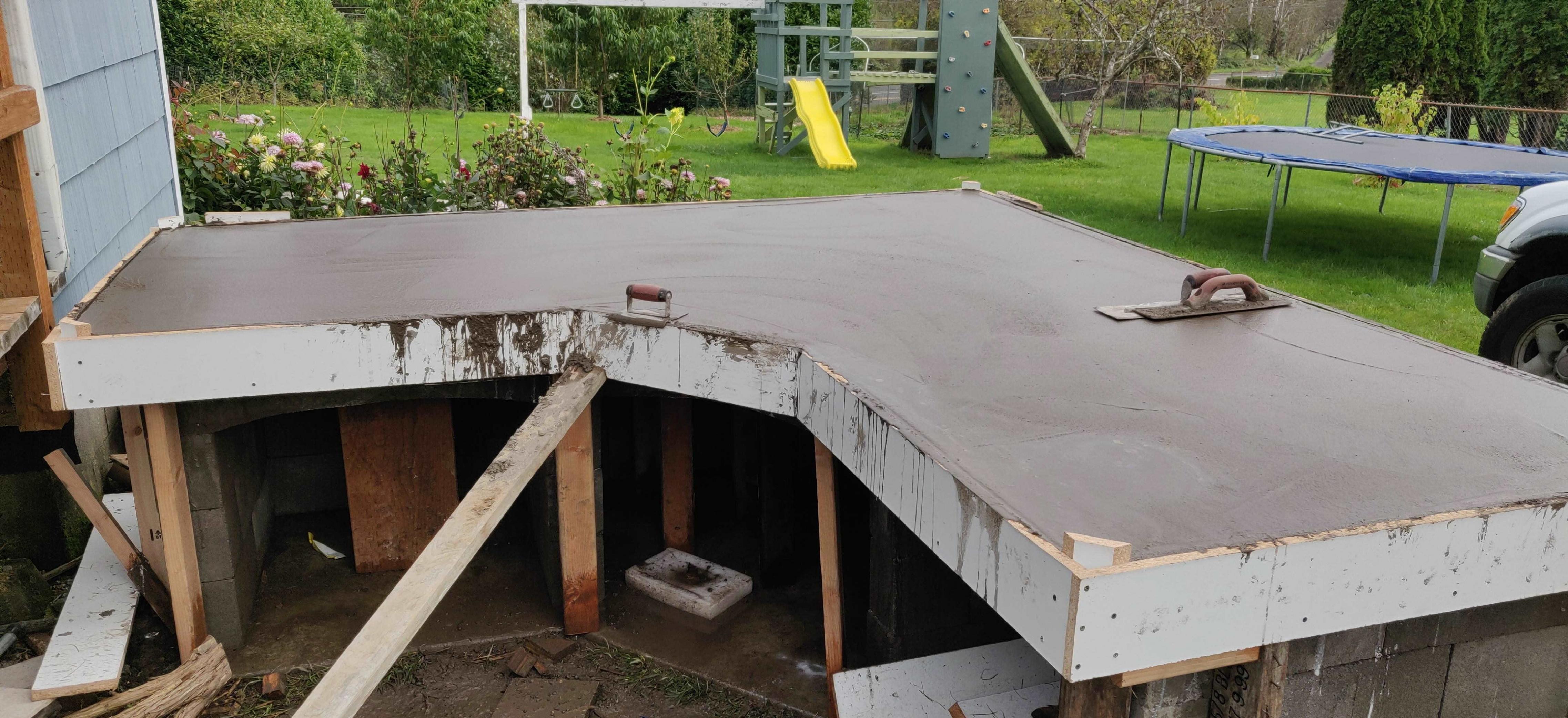

    Hello all, long time lurker, first time poster. I've been looking at building a pizza oven for years, and the time is finally here. I figured I could catch you all up on what I've done so far. I decided to build a 42" Pompeii oven on a corner installation. The stand is cinder blocks with three monolithic arches, which almost turned out perfectly. Keen eyes will spot that I failed to properly reinforce one the right-most arch so its a bit crooked. Otherwise success thus far!

    Looks like quite the set up! Very Nice work.

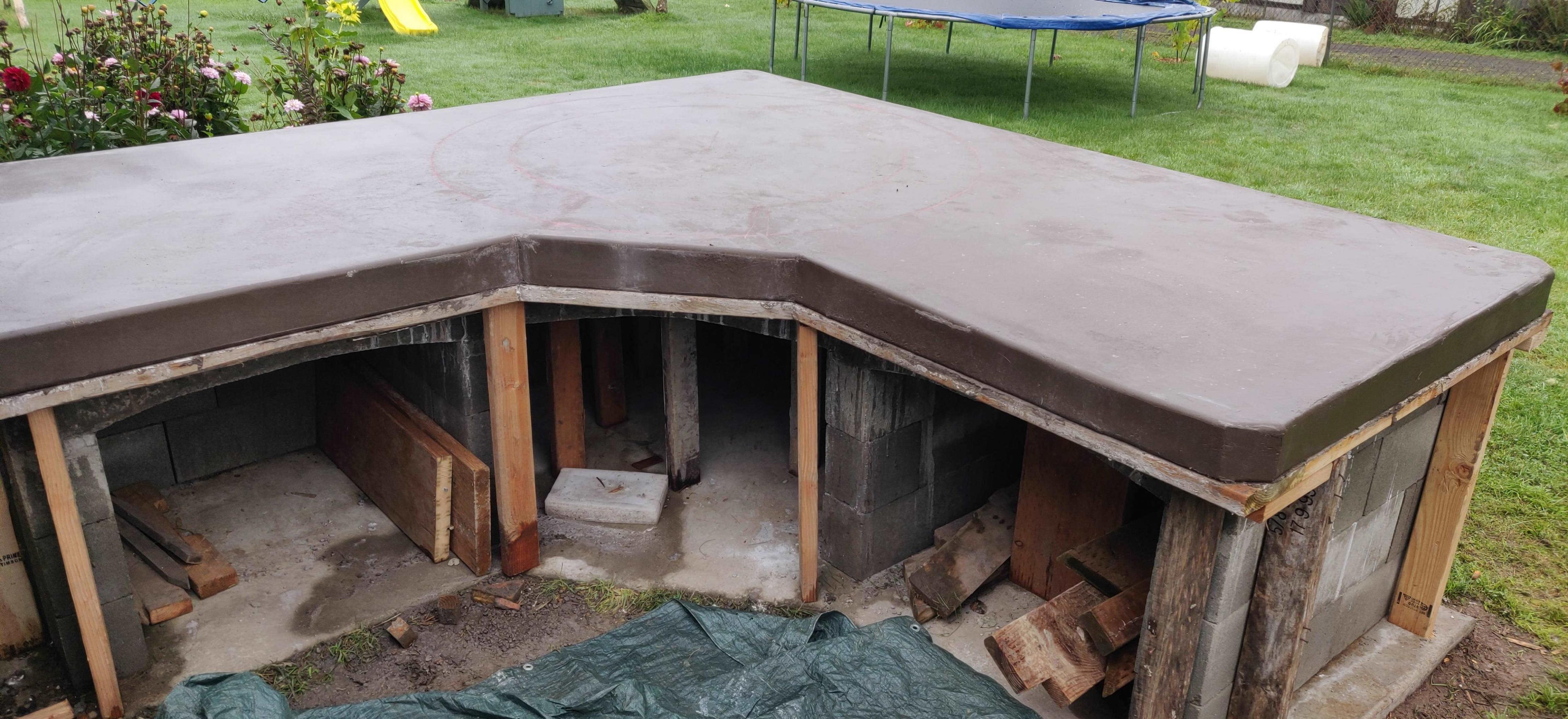

      From there I put together the countertop. This was my first time hand mixing in concrete colorant, and I think it turned out well for a nice chocolate brown.

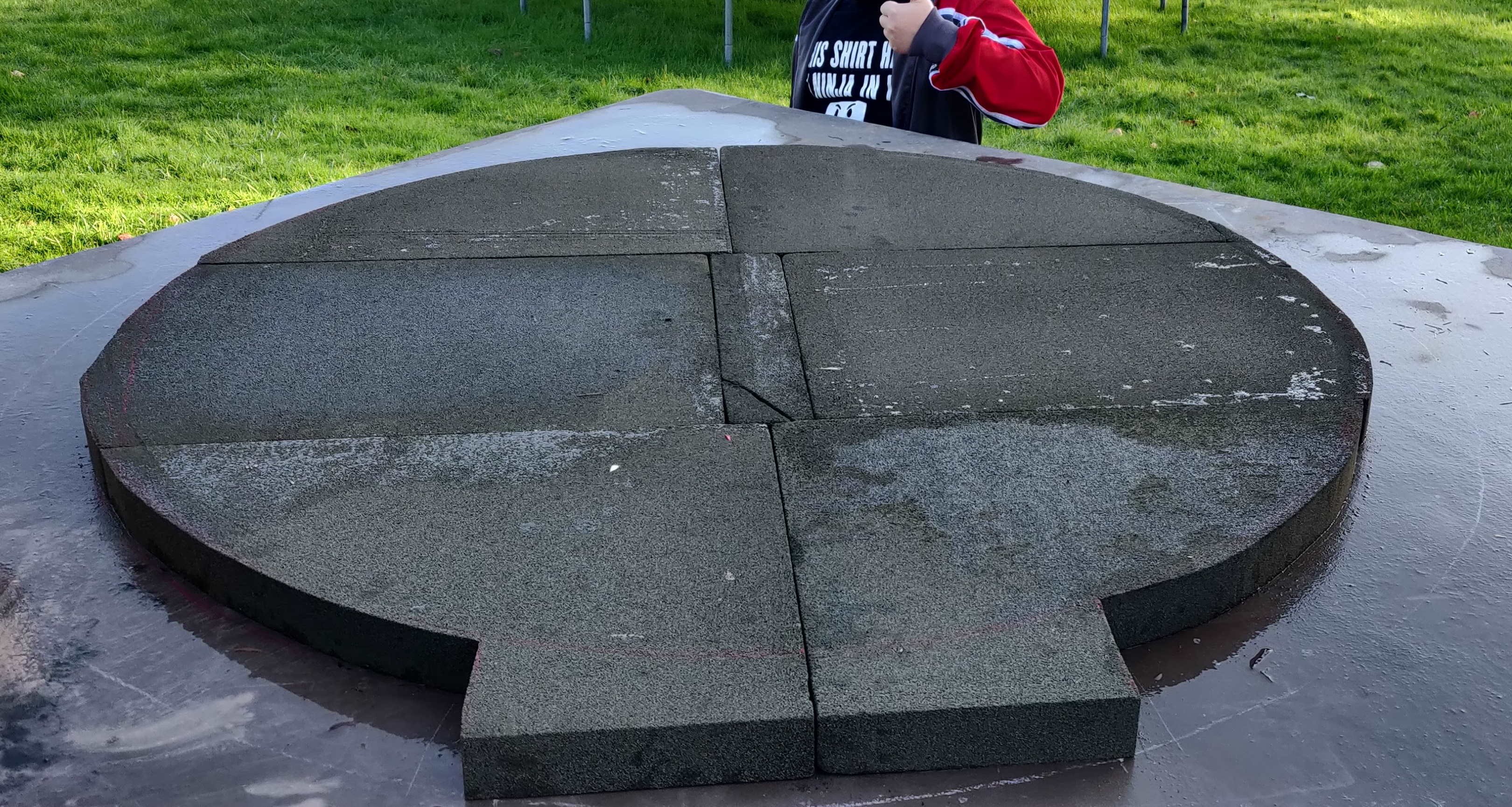

          I had a hard time finding a good insulation source, but was able to get a hold of some FoamGlas in the end, which I'm quite happy with. Next step is positioning and centering the oven on the table. I haven't really worked through all the considerations for the archway, vent space, depth etc, so now I see myself needing to move the oven back further than I thought initially. Hoping to work on it during my Thanksgiving staycation break.

                Hi looking good so far. Good pickup on the foamglas. Did you sourced some calsil board to out on top of the foamglas? Can't really tell but it seems you are using 1" foamglas so far that is rated for a service temp of 806 F . If you are not putting calsil board on top of the foamglas I would highly recommend it. Foamglas is good for a bottom layer on top of the structural slab as its moisture resistant but you will need something on top of that. Thermo 12 gold is rated up to 1200 F and the basic plans recommends 2" of this type of insulation if you are using calsil instead of vermicrete. I used 2" of foamglas and 2" of thermo 12 gold and I'm very happy with the results. Looking forward to seeing your progress.

                  Thanks for the information, I have seen several people who used the CalSil board on top of the FoamGlas but I thought that was because of the fear of crushing or breaking it... I don't have access to CalSil board at this time, so I was going for a leveling layer of fireclay then the brick floor on top... My FoamGlas is 2" thick, so I think I'm OK insulation-wise, but what exactly does using FoamGlas outside its service range imply? I am assuming I wouldn't be melting it...

                    I've been looking at it for a bit and all I can find is that its listed limits are "The melting temperature of FOAMGLAS® insulating slabs is above 1000 °C (DIN 4102-17) and the maximum application limit temperature is approx. 430 °C." However in another publication it's melting point is listed as "1350F." So while there may be some sort of degradation above about 800F, I can't seem to find anything that would make me think I am in danger of failure. However, a) I am the absolute opposite of any sort of material engineer, so much wiser minds please feel free to teach me, and b) many people here have built ovens while I have built exactly zero thus far.... so again, I wish to learn!

                      If you are concerned about the Foamglas melting of degrading, just use a thin layer (1" or so) of 5 :1 perlite/cement on top as a leveling layer for your cooking floor. Generally when you're firing and using the oven, the lower portion of the floor bricks won't attain the temps of the top side. Using a thin layer of insulating perlcrete (or vermicrete) will give you plenty of "protection" for the Foamglas.

                        I'll throw in my 2¢. I had used 1.5 inches of foamglas under the 2 inch CaSi board as the Foamglas is hydrophobic. Any water that were to seep under the base would not work its way up to the CaSi board.... that's the theory at least.
                        Actually, just looked at my receipt from the Foamglas supplier... it was 2 inch thick I had used.

                          Thanks for the feedback everyone, the forums are a great source of wisdom and experience! I just picked up a bag of perlite to make a 1" topping layer above the FoamGlas, better safe than sorry! I hope to spend most of today working on it, pictures to follow!

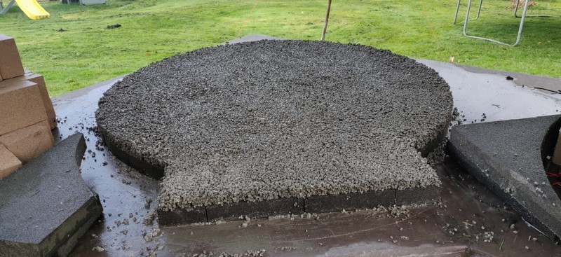

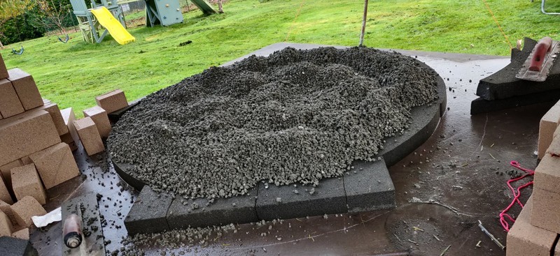

                              Well, I think I succeeded in laying out the 5:1 perelite cement mix. The perelite I purchased seemed pretty coarse, with chunks as big as pea gravel, so I'm a little worried about how well it will bond. I mixed in a bit of sand which seemed to help draw it all together...
