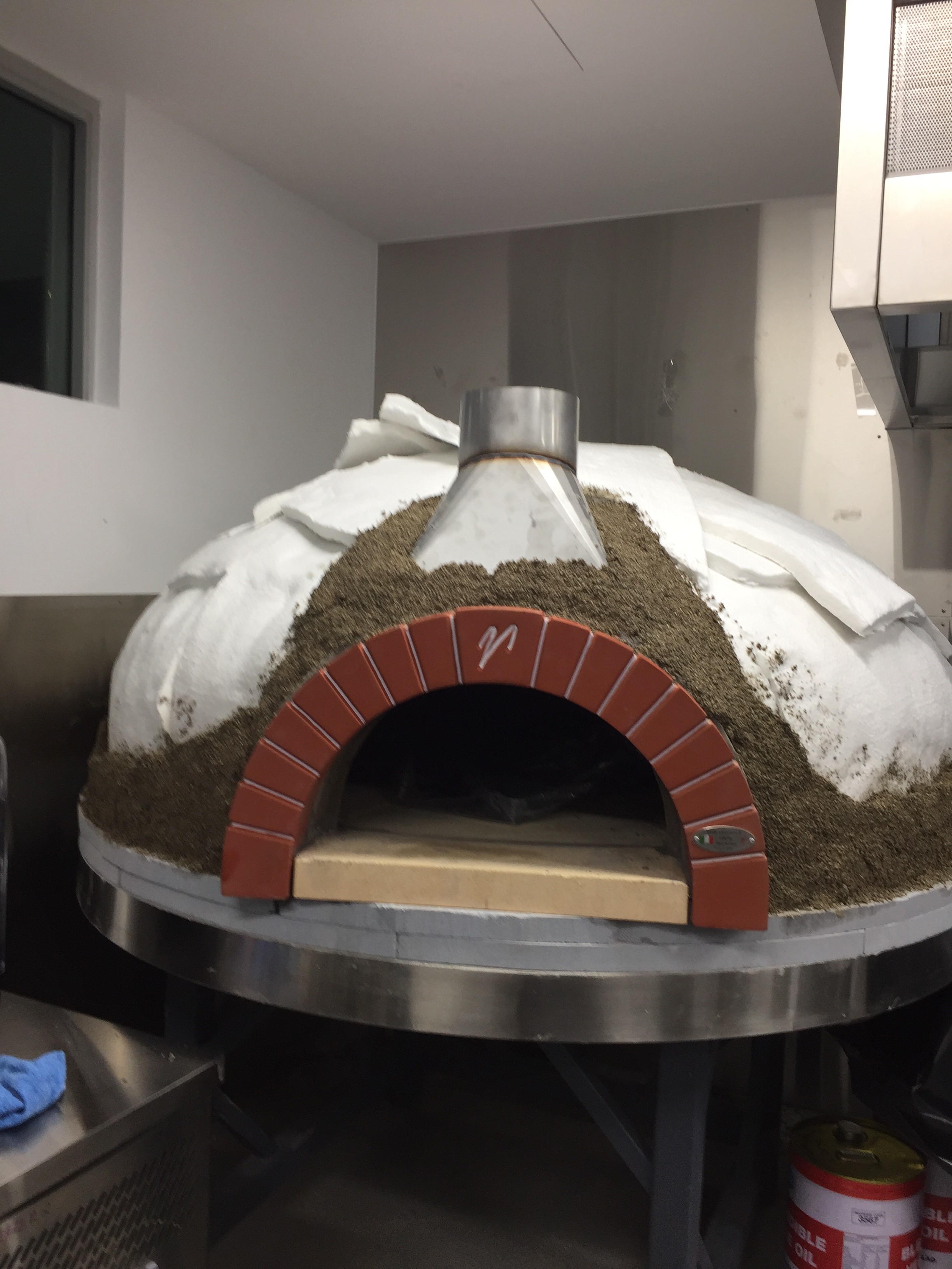

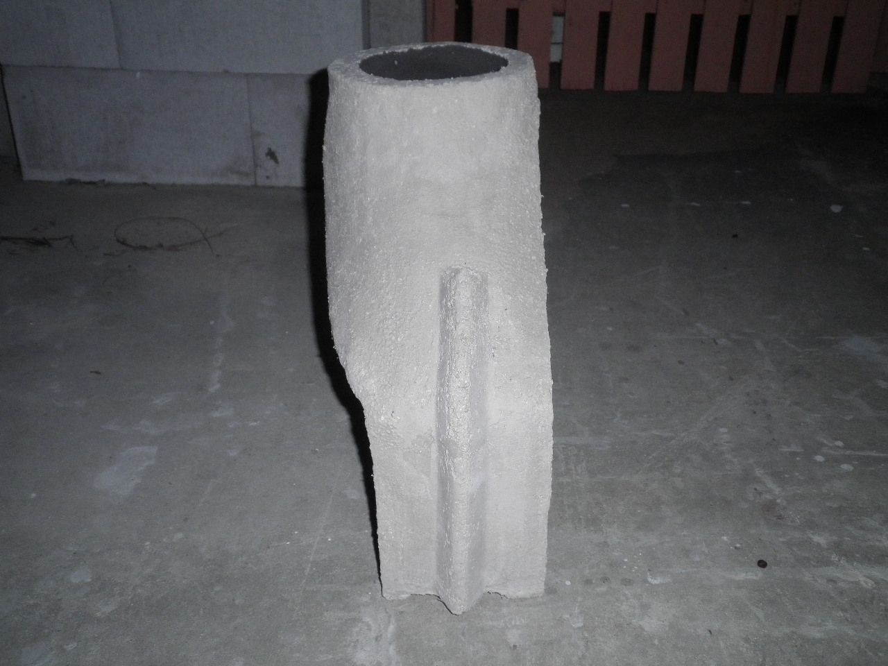

ID:	447340 The problem with a brick flue gallery is that it is extremely heavy, meaning high thermal mass creating a heat sink effect which can sap some heat from the dome. In addition it is extremely difficult to make compound curves with brick units. Casting a flue gallery with a castable refractory allows a far thinner and therefore lighter gallery as well as making the compound curves easily. Another alternative is to have a stainless gallery fabricated.

ID:	447341 Here's a link to a brick arch repair incorporating a cast in situ flue gallery that you might find useful.

        oops, my apologies, I didn't look back at your build. I see now you already have the gallery and chimney already built. Generally bends should not be any flatter than 45 degrees or the draw will be reduced. As Russell has already pointed out, if the oven is new it will smoke a fair bit, particularly on light up or if the chamber contains too much fuel. You can also increase the draw a bit by extending the flue pipe above your roof. However, if it were mine I'd be just trying continuing to use it as the smoke out the front will reduce as the oven dries out. Also start with smaller fires.
