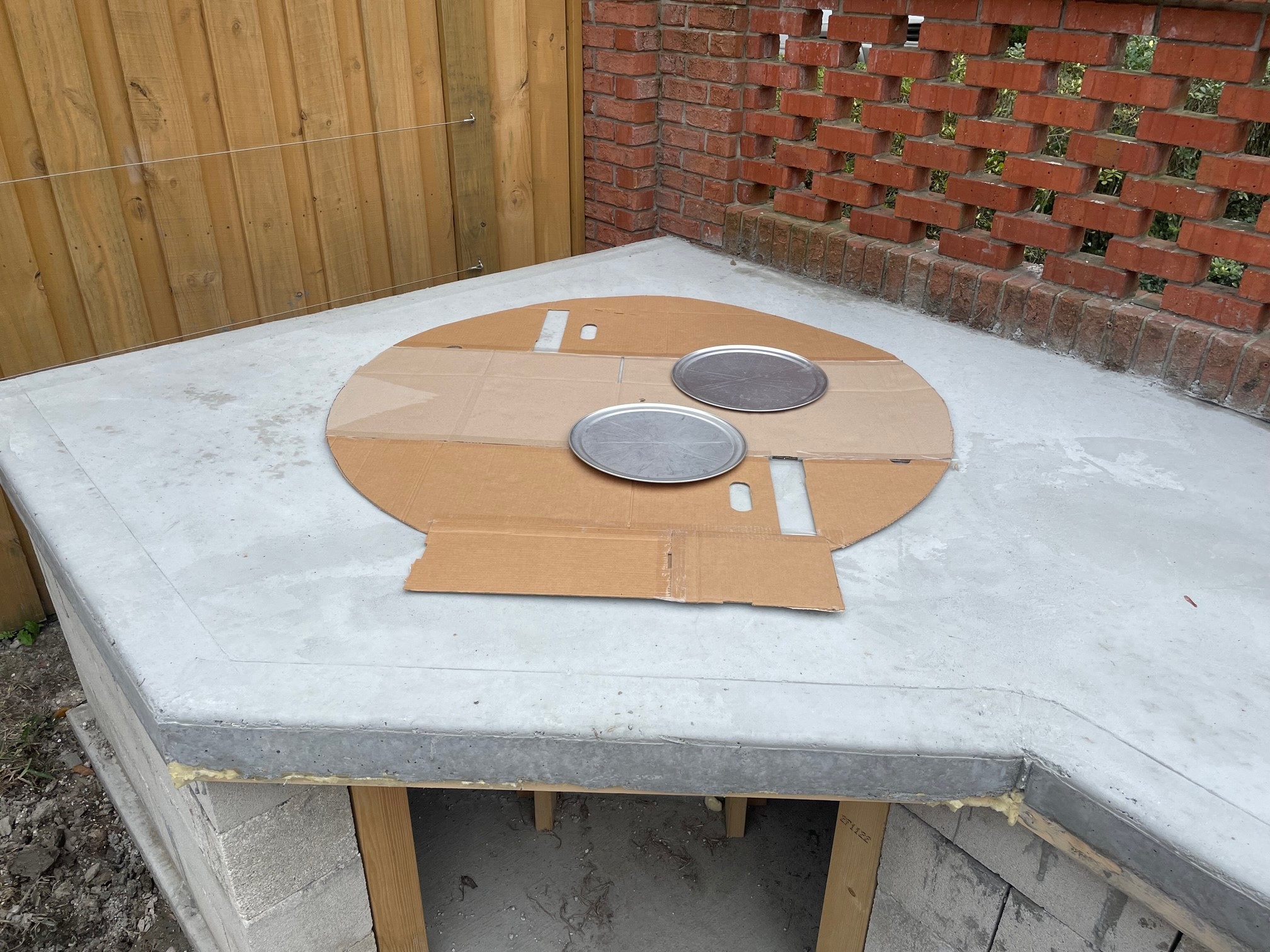

    I'm more of a woodworker, but love pizza and thought I'd try my hand at building an oven. My concrete work has not been what I would consider pretty, more along the lines of good enough. I have the materials for for the insulation layer between the hearth and the oven floor and will work on creating the form for that next. Here's my progress so far. Feel free to offer suggestions as I move forward.
    What is you floor insulation going to be and how thick so we can guide you. This is an important stage of the build, once laid down, no going back. BTW, good start, be aware it will be a little difficult to work on the back side with the wood and brick fence there.

      Thanks for your reply, I plan to make a form and then pour 4" of a 5 : 1 perlite : portland cement mixture before laying down the fire brick floor. I've also included some additional pictures which includes my latest progress.
        Drilling a few holes through the concrete slab from the base up will provide a drain for moisture to escape. When the hole reaches the top surface it will probably blow out a bit which is actually an advantage, leaving a slope towards the drain hole. Even better, although not essential is to lay some tiles over the concrete supporting slab (but not covering the holes). This raised the insulating slab so it won’t get wet feet and provides channels for steam to find its way out more efficiently.
          I am pretty sure David S will advise you to make sure the pcrete is "really" dry before laying the fire brick down on it. Removing water from floor pcrete is difficult to remove once the fire brick is laid on top. Also to be sure if you only pour pcrete in the shape of the oven, make sure all parts of the oven, ie floor, dome, wall, etc ) have insulation under it.

              Thanks for the comments. For the 42" interior oven build i calculated a 51" diameter circle to account for the 4.5" fire brick around the perimeter. I've also taken into account an 8" deep vent landing that is 26" wide including the thickness of the brick. I then would plan to cover the entirety in a 3" blank and then stucco/tile over the top of that. The 4" layer of perlcrete would be visible under the oven wall and landing until covered by the insulating blanket.

                What Dave means, that if you place tiles down on hearth with spacing so water can channel out to the weep holes then any pooling water will not absorb up through the pcrete from the hearth. The weed fabric is so the channels will not get blocked when you do the pcrete pour. Wet insulation is one of the key factors in poor thermal performance of an oven.
