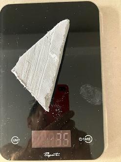

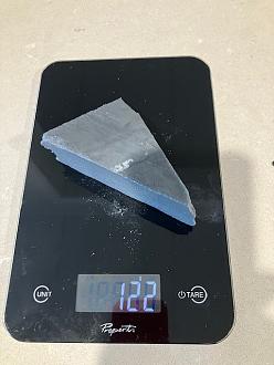

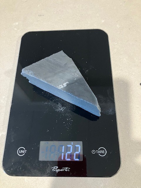

            I got to thinking about permeability so did a little test of how much water some calcium silicate board would take up. I weighed a piece first, then soaked it in water, not for 24 hours, but for 1/2 hr by which time no bubbles were rising from it and it was just floating with around 0.5mm above the water surface. I figured that was probably sufficient and I removed it and weighed it again. The difference in weight indicates an increase of 250%. (135-35=87 87/35=250%).
            I have left it in the sub and wind and will repeat daily weighings to see how it dries. I think this is a worthy and instructive test.

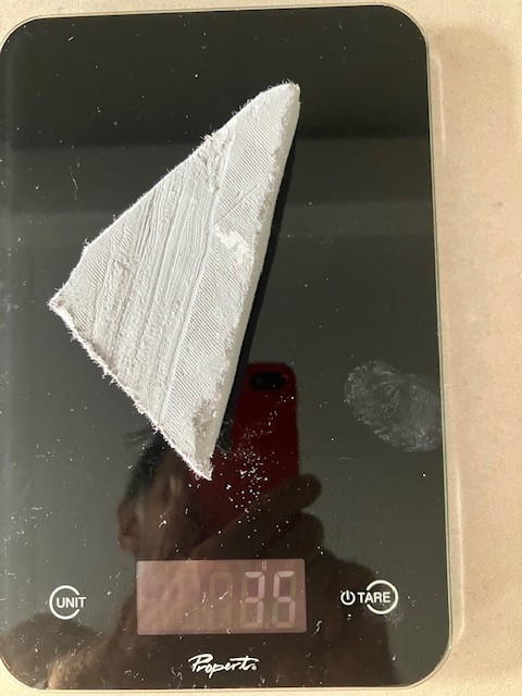

                    Click image for larger version  Name:	IMG_0946.jpg Views:	20 Size:	68.3 KB ID:	458080 Click image for larger version  Name:	IMG_0947.jpg Views:	16 Size:	70.3 KB ID:	458081

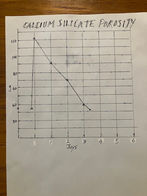

                    I've completed the cal sil drying experiment.
                    As previously posted the calsil took on 87 g of water from its starting point of 35g. The attached graph shows how it dried back to its original weight and condition in just 3.5 days.
                    During drying it was elevated from its base so 3 sides were exposed to sun and 4 to wind.
                    Bearing in mind calcium silicate covered on the base and sides, or totally encapsulated would take way longer to dry. The piece was restored to normal condition when dried again with no apparent loss of strength.
                    This simple method of testing porosity can also be used to test bricks
                    Click image for larger version  Name:	IMG_0952.jpg Views:	0 Size:	57.9 KB ID:	458099
