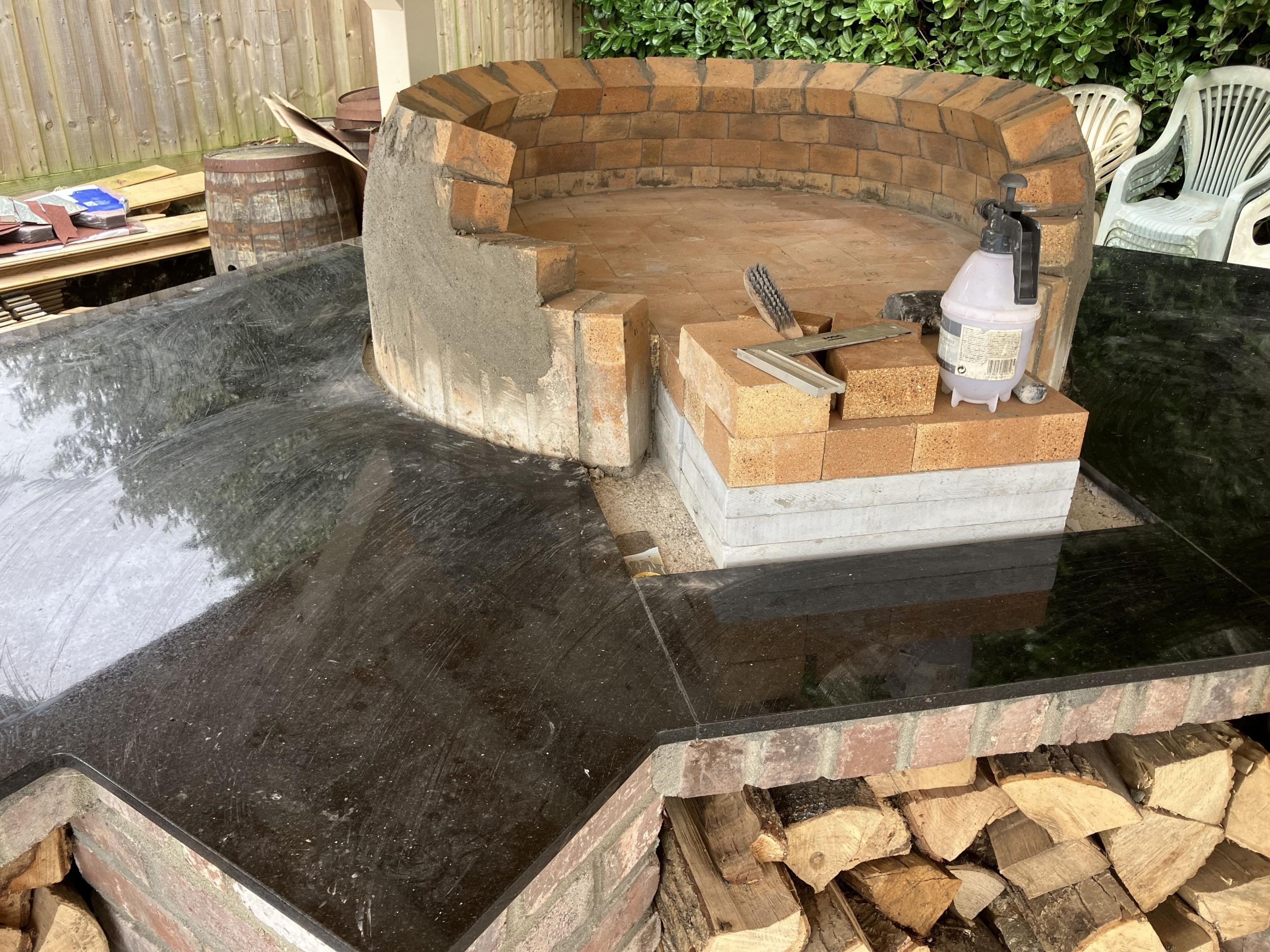

    If you are still set on laying the first row of bricks directly on the supporting slab, here are a couple of suggestions you might consider.
    Firstly, laying soldiers as a first course introduces the problem of creating long vertical joints between the soldiers. Because the most vulnerable part of any hemisphere is at its base (think of an eggshell cut in half), many builds using soldiers use a steel band around the soldiers. This is a difficult operation, especially across the oven mouth and introduces corrosive steel. A better solution is to use two half brick courses instead of the soldiers, so the mortar joints are staggered, eliminating the long vertical joints.
    Secondly, if the first course of half bricks is insulating fire brick, rather than dense fire brick, it will insulate the base of the dome very well.

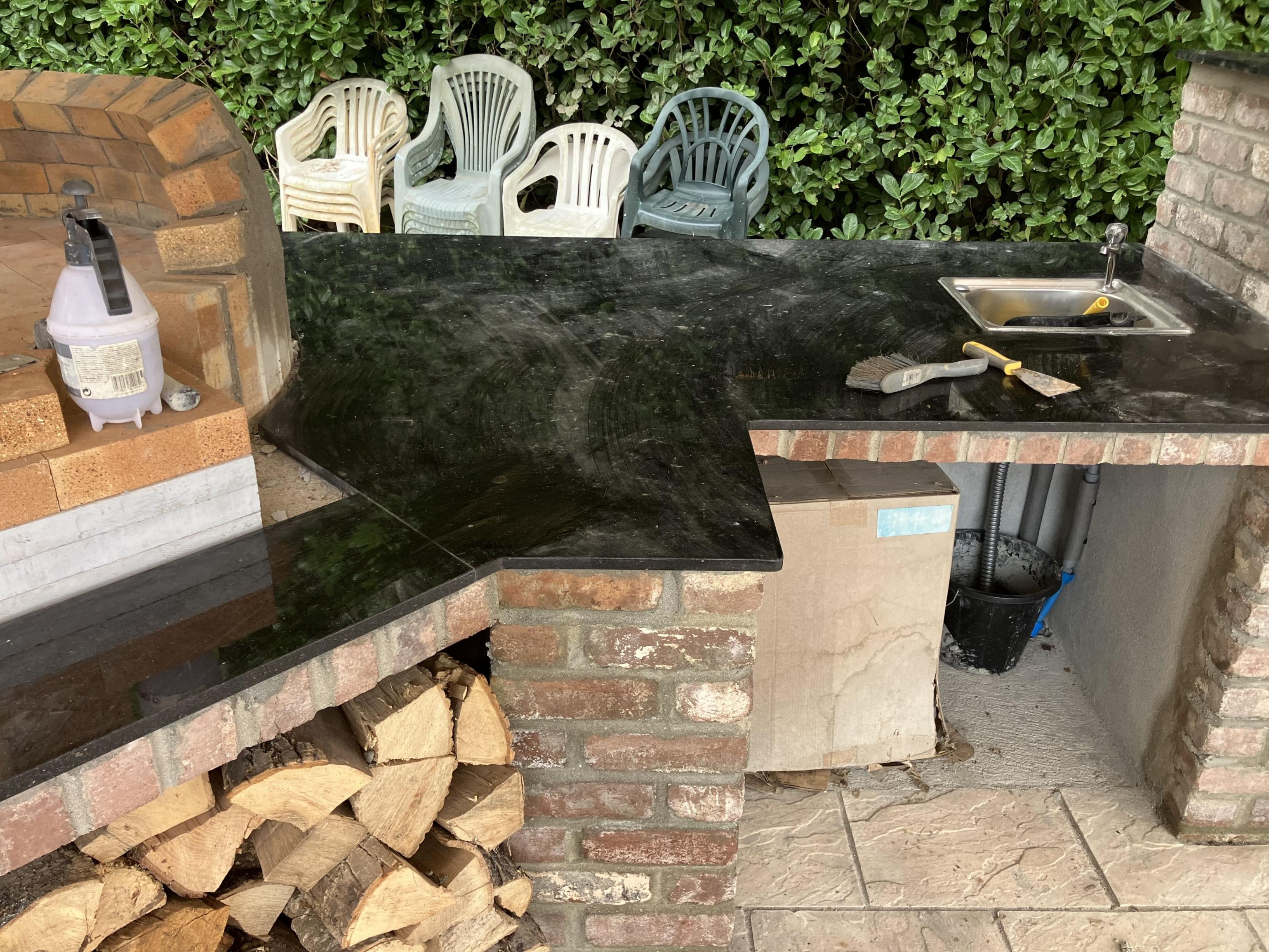

    Yeah it turned out the concrete polishing was going to be bigger than Ben Hur so I binned the idea and opted for the granite. It is expensive but I could outsource the job so I didn't have to worry about it.
    The main problem with the concrete polishing was I don't think I made the mix hard enough and so as I was polishing I was getting grit crumbling off the concrete surface. I only tried to polish one corner with a small wet polisher but even if I could hire a larger machine I think it would have taken about three weeks of very wet work, I simply couldn't afford the time.

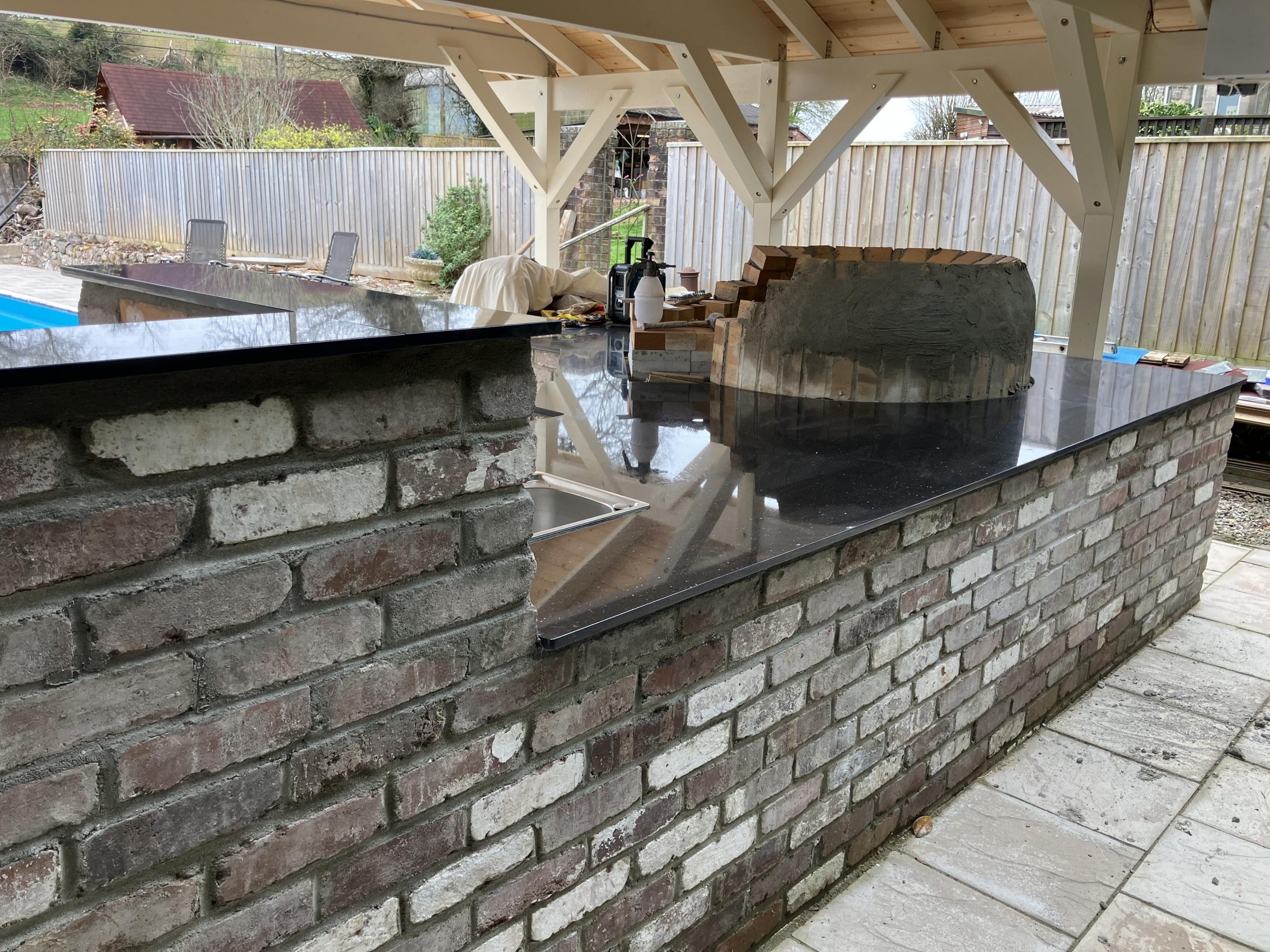

      #32

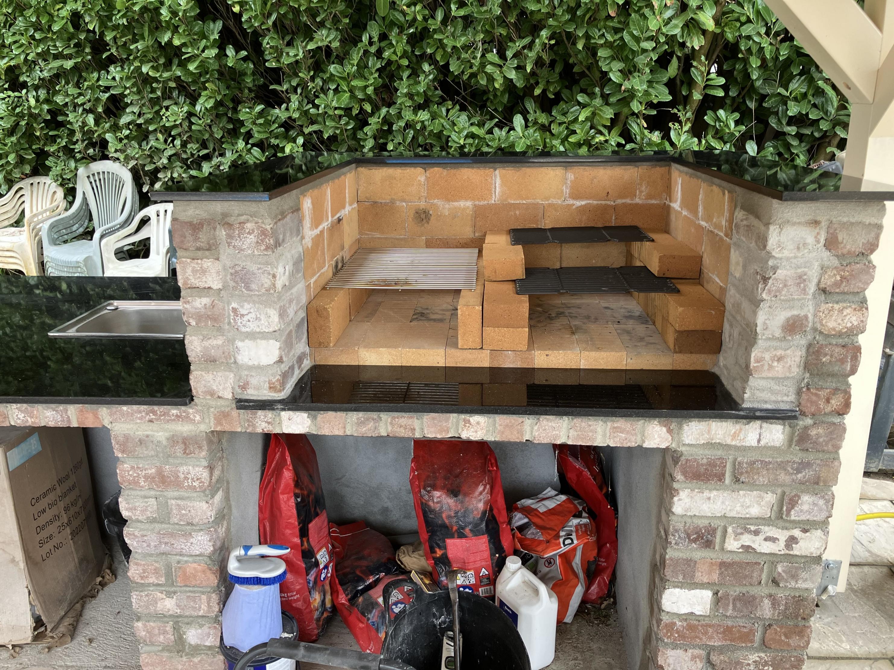

      Thought I would take a quick break and tidy up. Have finished the BBQ area and completed a few courses on the oven dome. About to think and contemplate the entrance arch and reveal so thats going to hurt a little. It's one of those things where I know what I want and just have to make it work by many cuts using the big brick saw and small adjustments using the angle grinder.

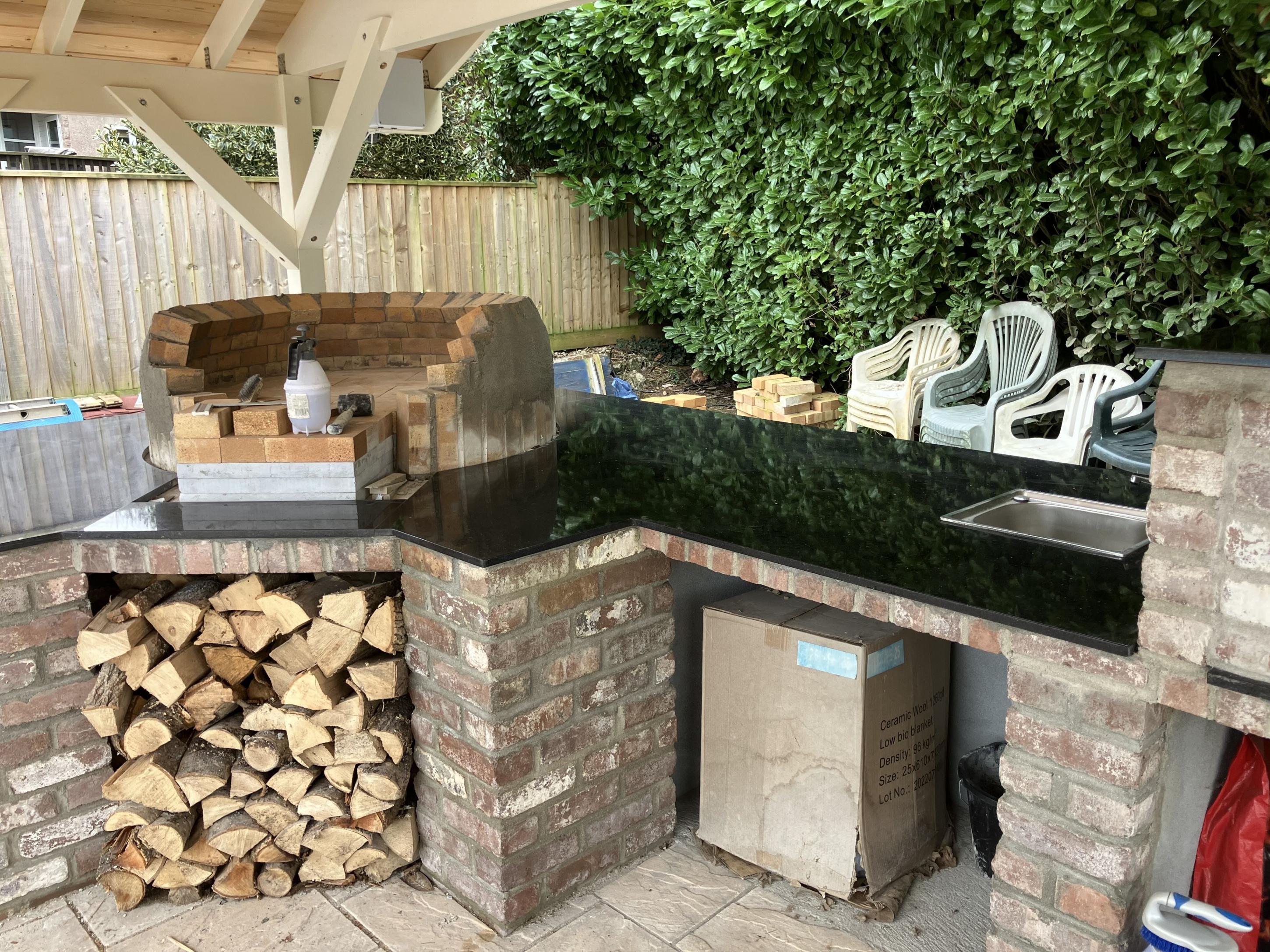

        #33
        So today in the partial sun but harsh wind I managed to get some brickwork done on the front surrounding the landing and casill boards. I am lucky as I have a roof over the top so I haven't had a problem of water getting to the casil boards but it is nice to finally encapsulate them.
        I still need to do the transition from the front landing into the dome but it's all planned . I think I will add another pier of bricks to the front to cover the weight of the archway once I build it.
        I did a few awkward cuts today which was soooo much easier with my big brick saw. I remember the last time I built an oven (8 years ago) I was simply using an angle grinder for cutting bricks- nearly lost my foot and some fingers a few times.

          The granite is already waterproofed and should last me a couple of years before I have to reapply
          Nothing underneath the bricks, they are laid straight on top of the calsil boards.

              I decided to crack on without insulating under the soldier course. No doubt I will lose some heat downwards through the length of the brick but I had already set the bricks in place and I wasn't going to remove them.

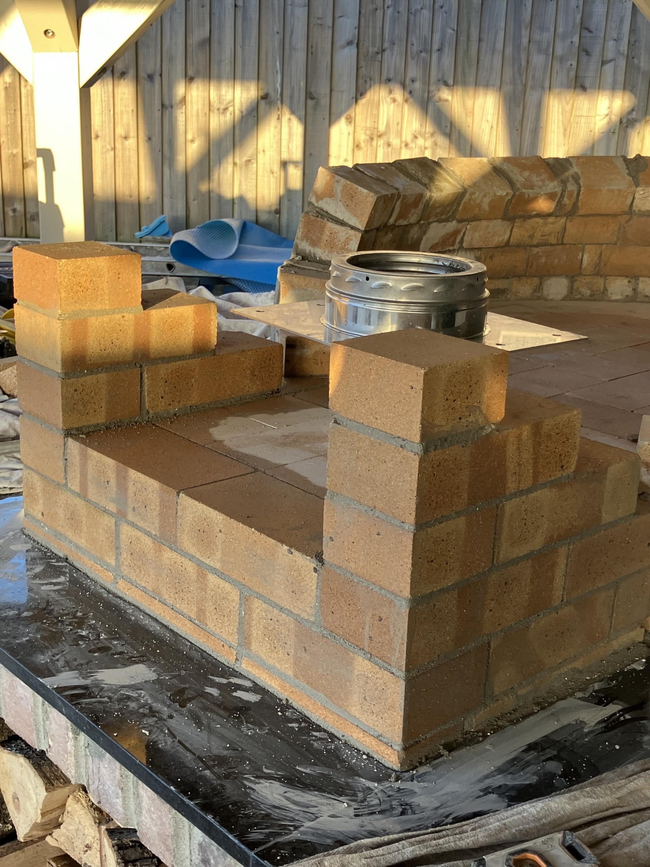

                #37

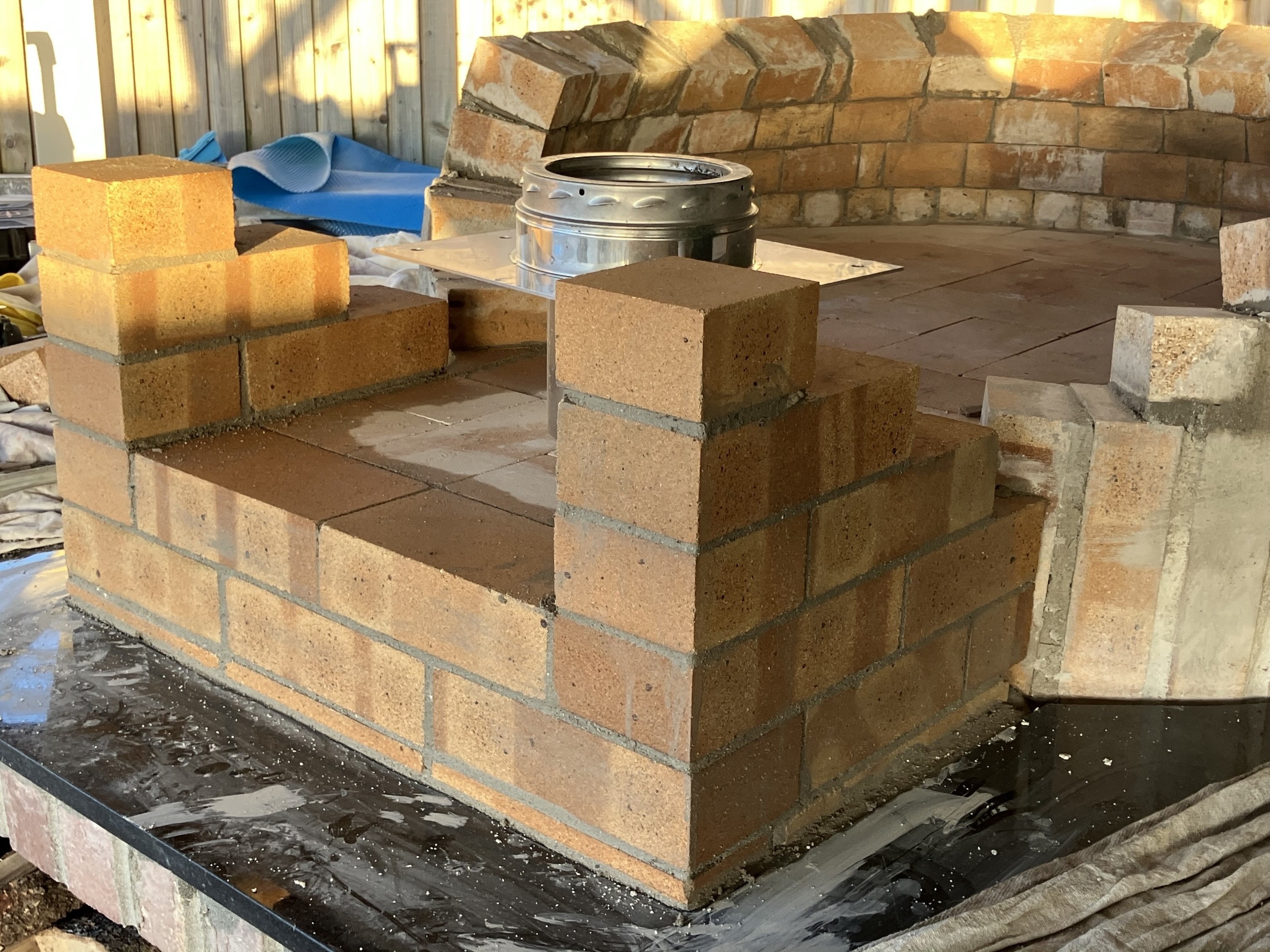

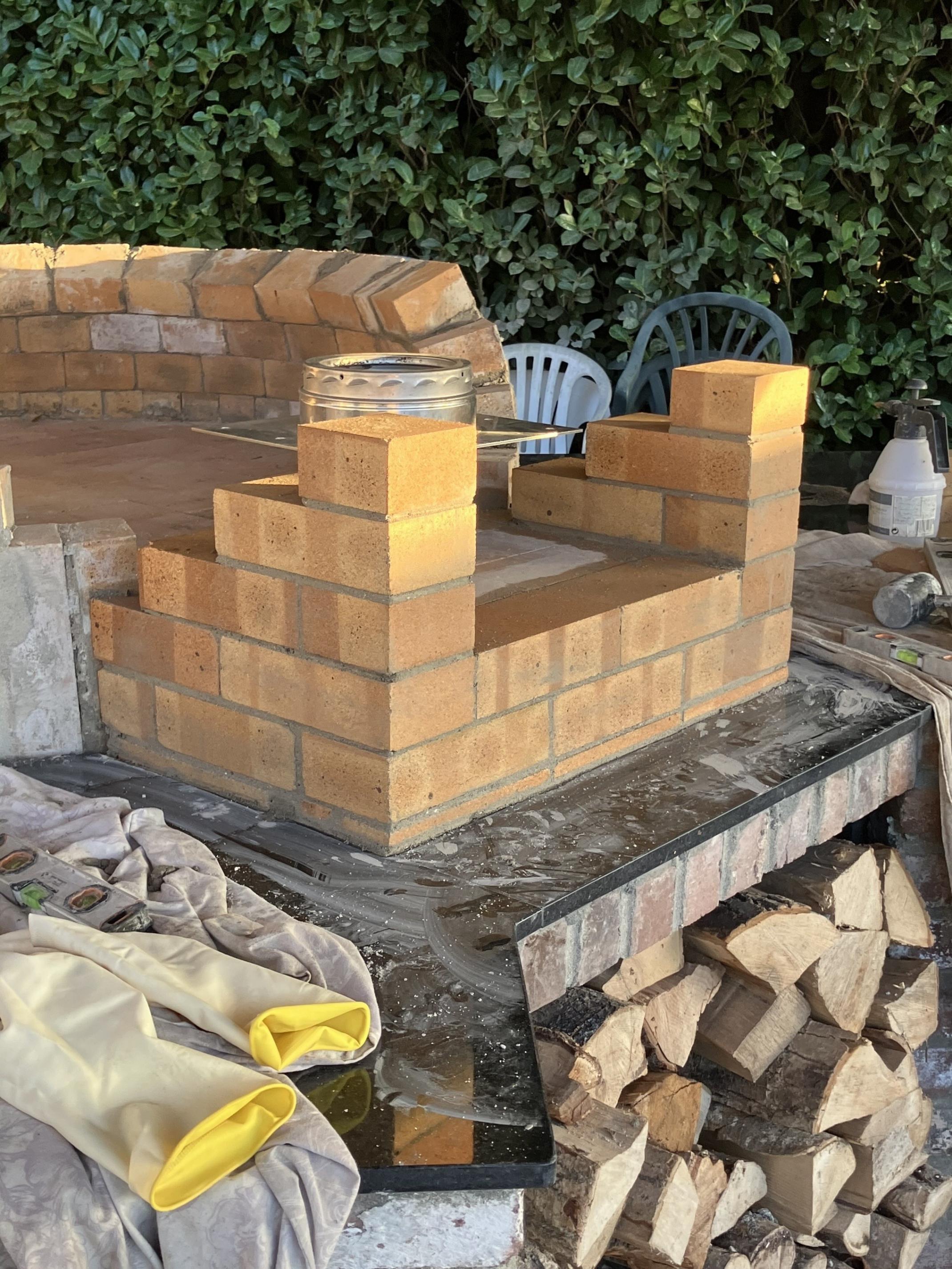

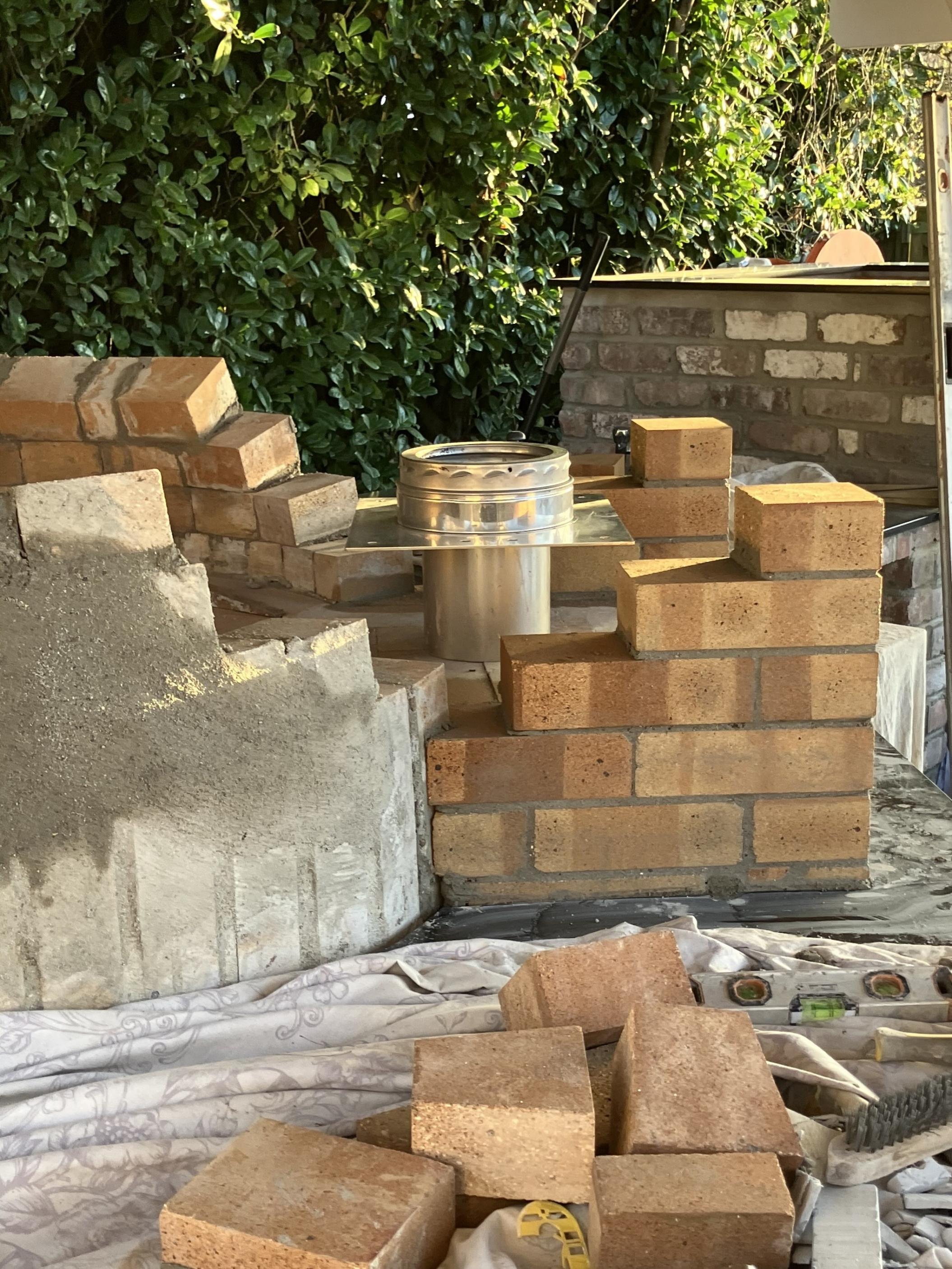

                Hi All,
                I have been busy creating the front arches and the smoke chamber and loosely set up the flue for size. Unfortunately I had to put a couple of bends on to make sure it missed one of the roof joist. I haven't cut the hole in the roof yet but as it is due to rain for a week so I shall leave it for now.
                I gave the internal brickwork a bit of a scrape off today so it looks a lot better than it did. I will give it a scrub with some brick cleaner acid before I continue with the dome.
                I must be cleaner with my brickwork.
                The flue is a twin wall 8inch internal. Hopefully it should be up to the job as I do not want smoke coming out of the front.

                    #39
                    Looking good so far.
                    Too bad about the flue position. You could go straight up by cutting that roof joist and installing header joists. If you decide to do that, not sure you need it in this case, but you may want to add temporary vertical supports to what will be the tail joists before you make the cuts.
                    As you've already discovered...cleaning the bricks at the end of each work session is the ticket.

                      #40
                      Gave the bricks a scrub, the eagled eyed amongst you would notice the different coloured bricks. The project took so long I used some of my supply of firebricks to line the BBQ. This led to a shortfall in brick numbers for the pizza oven and try as I may I couldn't get the same colour again. I used what I had left to create the front
                      I do like the paler coloured bricks to work with and they do cut well but as they are going to be on then inside of the dome I don't think it really makes any difference.
                      Managed to keep enough of the darker bricks to finish the front arch and supports.
