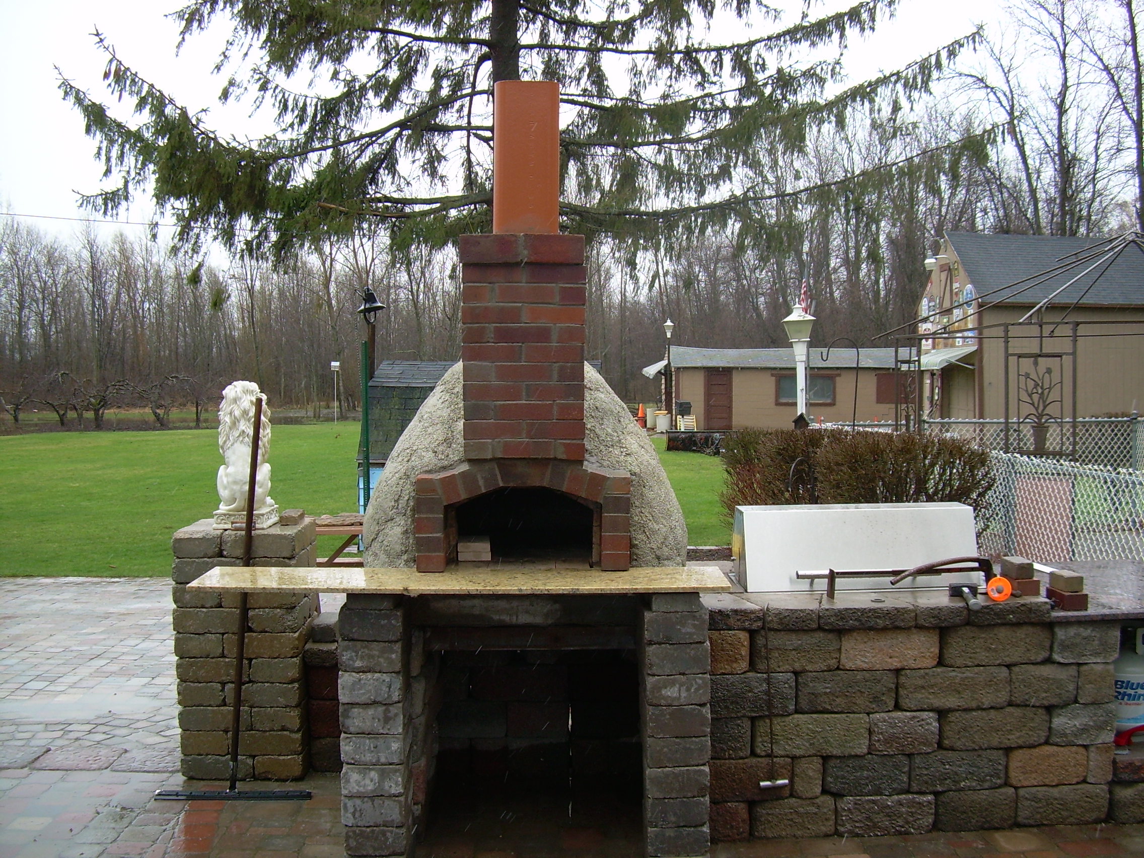

    landing in front of oven
    bought a piece of granite today need to cClick image for larger version
ID:	314892ut it test fit

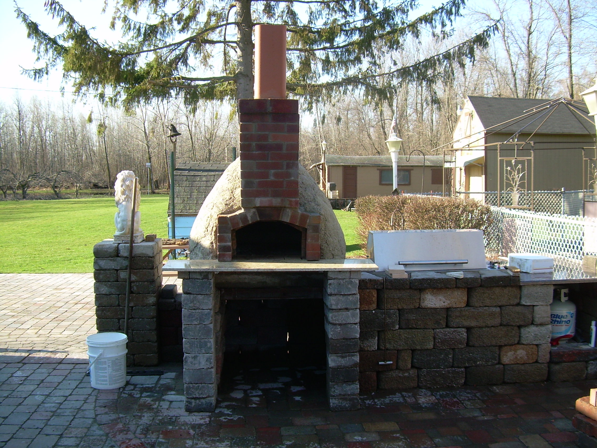

    Re: landing in front of oven
ID:	274680cut stone today need to glue everything down
        Sumu,
        Looking great! Could you elaborate "glue everything down"? When I placed my granite slab I sort of left it more or less free floating so it could expand and contract and in the event of a catastrophic failure remove and replace it. This isn't a criticism, I am curious how you are affixing the slab to the WFO.
        Thanks,
        Wiley
          I'm with wiley...mine was so heavy that it's held in place by gravity and then the surrounding masonry work
            all the stone caps or pillars are glued in place with a concrete adhesive i get it at the brick place or home depot it comes in a calk tube very strong . srw adhesive from the brick place almost like liquid nails but for concrete block.
