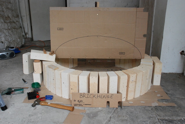

Inspired by the Forno Bravo site, I have decided to help to spread the wood-burning oven craze to the UK. I am building a 36" diameter oven with a 19" high dome. The first course of bricks will be single upright 9" bricks. The original intention was to have an 18" elliptical dome but with only a 9" rise above the soldier course, this resulted in a worryingly shallow curve over a large part of the dome (see photo). Current thinking is that the dome will be part of a sphere that will provide a less shallow curve.

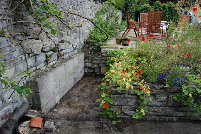

The oven will be sited close to the back door of our cottage to allow easy access during the Winter and those many cold and wet days that we have in this country! I am using a convenient space left by a redundant oil tank thus reducing the work needed for the stand. See photo. Extra supporting blocks were put in today and tomorrow we start on the frame for the hearth.
