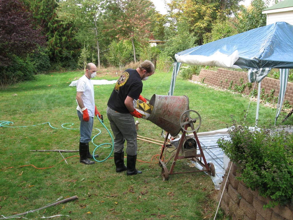

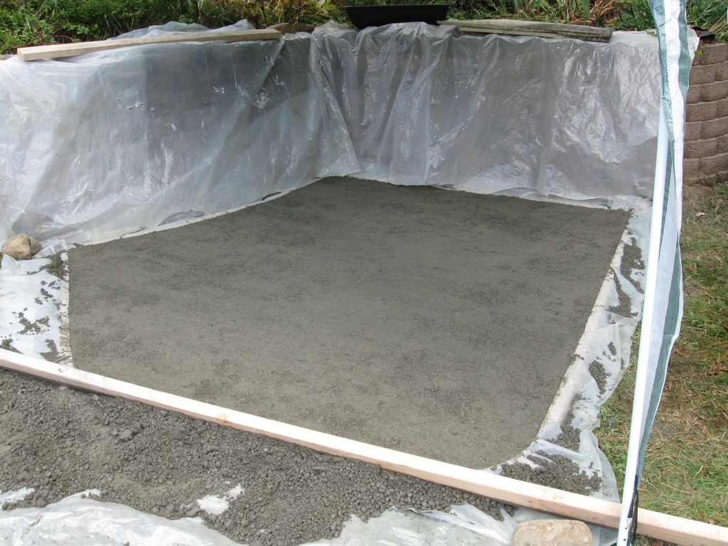

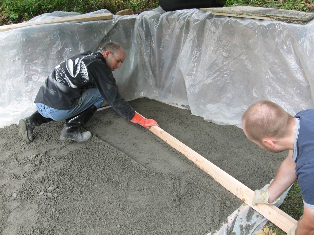

        That's great! I bet you're your relieved to have that milestone behind you. I remember preparing our site and pouring the slab to be one of the most brutal parts of our project. No stopping you now!
        Ken Morgan
        • #49
          Re: 36" in Seattle

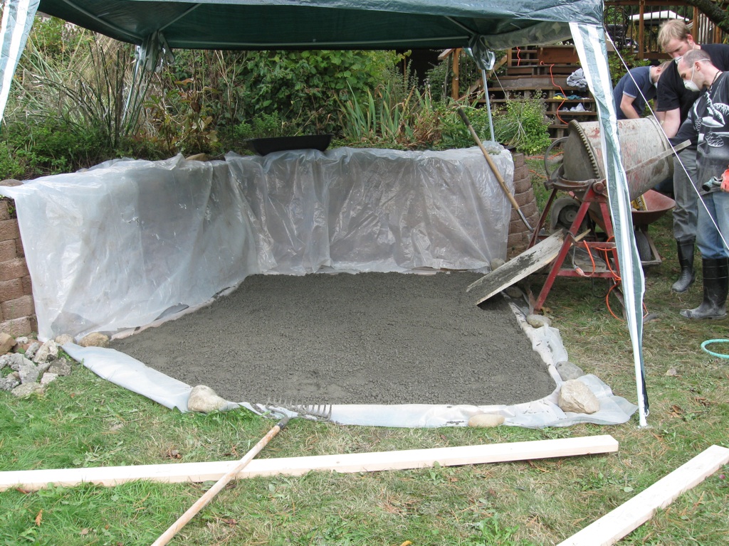

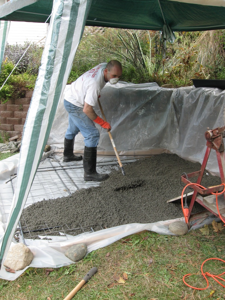

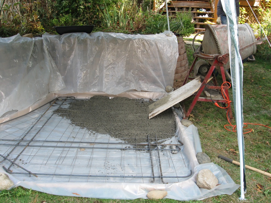

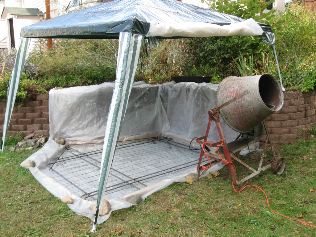

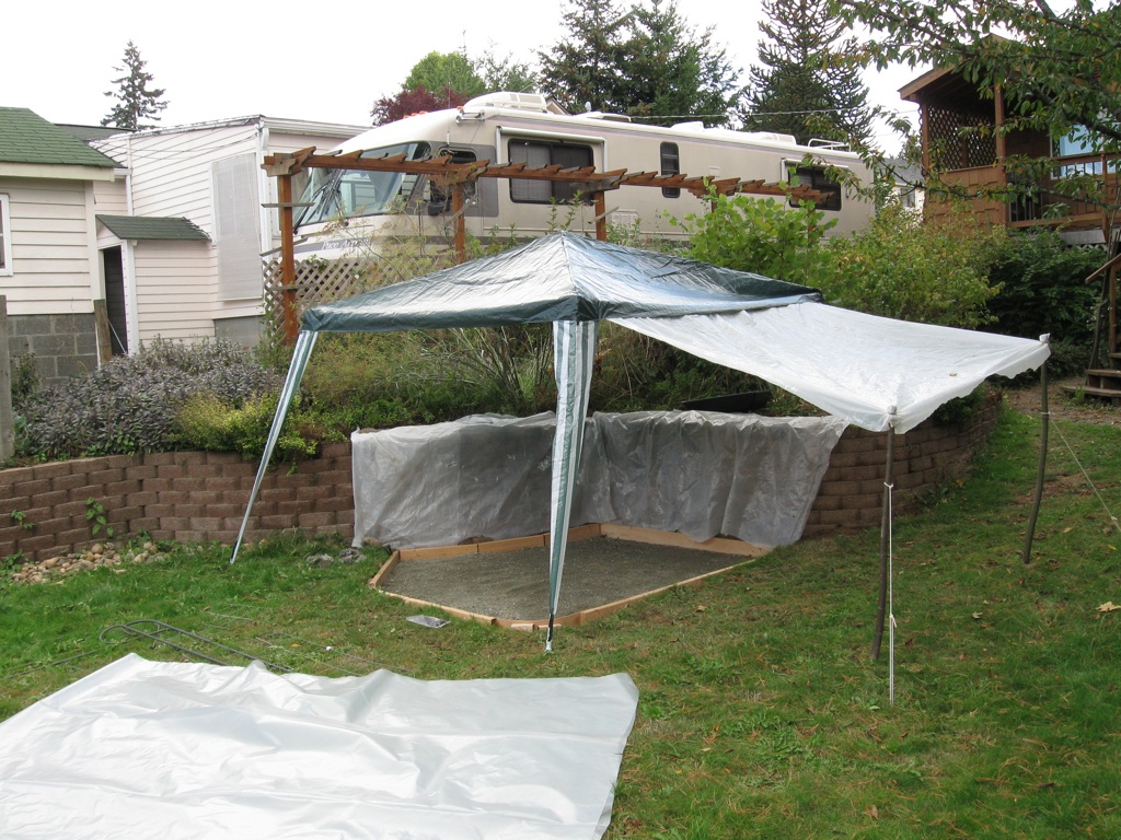

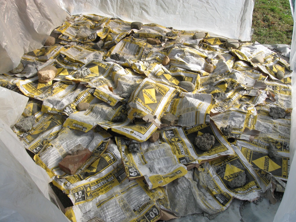

          Since this thread is the official record of my build, I will briefly reference another thread I posted last night in which I expressed some concern about my resultant foundation:
          Bottom line, I think I made the concrete a tad bit on the dry side...and if one were interested in aesthetics (I'm not w.r.t. the foundation since it will all be covered eventually anyway), floating it probably would have helped. I didn't float it because I couldn't imagine what floating would do...which in turn resulted from the dry texture I got in the first place: I just couldn't see how swirling a little toy plank around that dry crud would have done anything. If it had been wetter to begin with, it would have both reduced surface crumbling and motivated me to float by permitting me to believe such an endeavor could have a tangible effect.
          So, I'm keeping the surface constantly misted and covered by plastic for several days. I think it'll be okay, if perhaps a bit gritty and ugly as all heck.
          Lessons that will be applied to the wall cores and the hearth.
          <Sigh>
