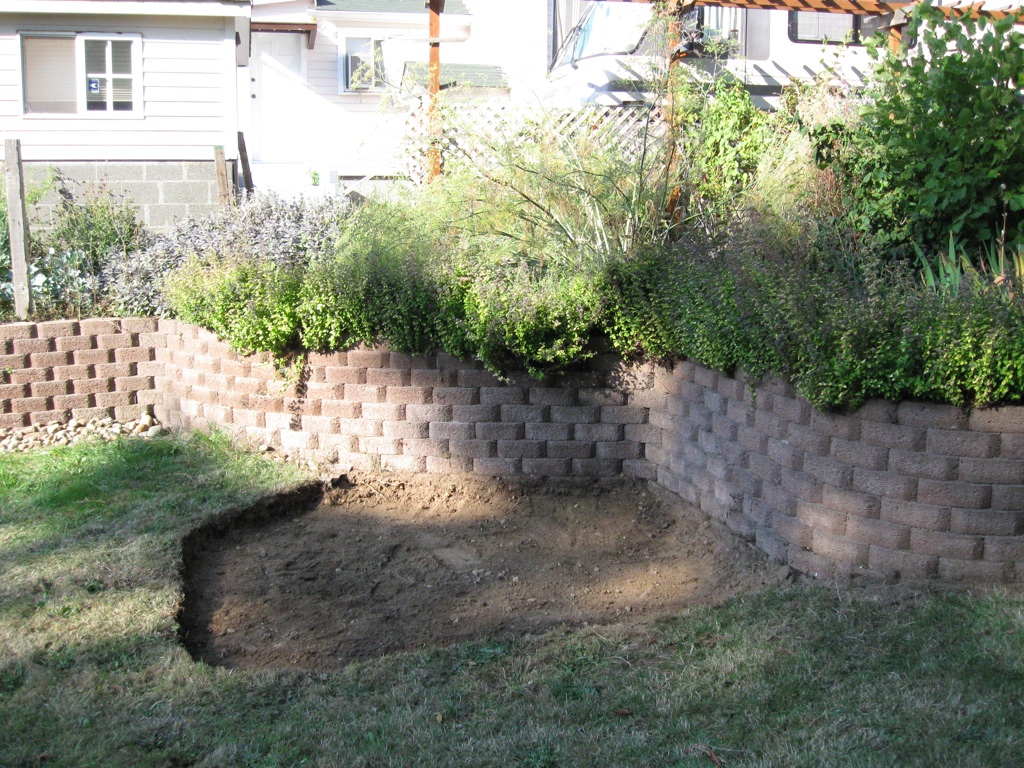

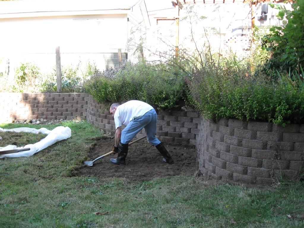

    It begins! It's hard to appreciate from a picture of a hole in the ground just how much effort goes into making such a hole. I haven't leveled it yet, and I suspect I may need to go a little deeper anyway (3" gravel + 5" concrete = 8" foundation, let concrete rise above lawn by about 2" means I need 6" deep level across the bottom).

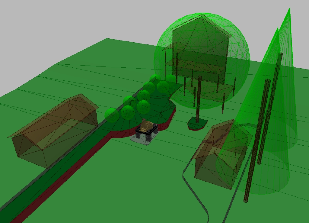

    Important question: you will notice that I am attempting a rather large opening on the right side. The opening on the left side is four half-blocks wide, 32". The opening on the right side is five half-blocks wide, 40". With angle iron and/or an extra rebar right across the lintel position, should that be okay? Remember, I'm only building a 36" oven and I don't intend to build a brick enclosure (going for stucco), so it should be amongst the lightest of ovens.

    Kebwi, the design I used for my oven stand has a 40" opening in the front between block. It has NO angle iron support. It does have two layers of steel mesh with 1/2" rebar grid (similar to your digital model hearth slab drawing). This design is to support a huge barrel vault oven, not a smaller pompeii style oven. I have never heard of a hearth slab collapsing using this design.
    I don't see your two gaps being a support problem, especially with your angle iron support.

      Incidentally, it is a little strange to include the interior angle iron when there is not a course of blocks above it. That interior angle iron is essentially embedded in the support slab. Does anyone have any thoughts on that? Since my design has no blocks above the angle iron should I only put it on the external face...if at all?
