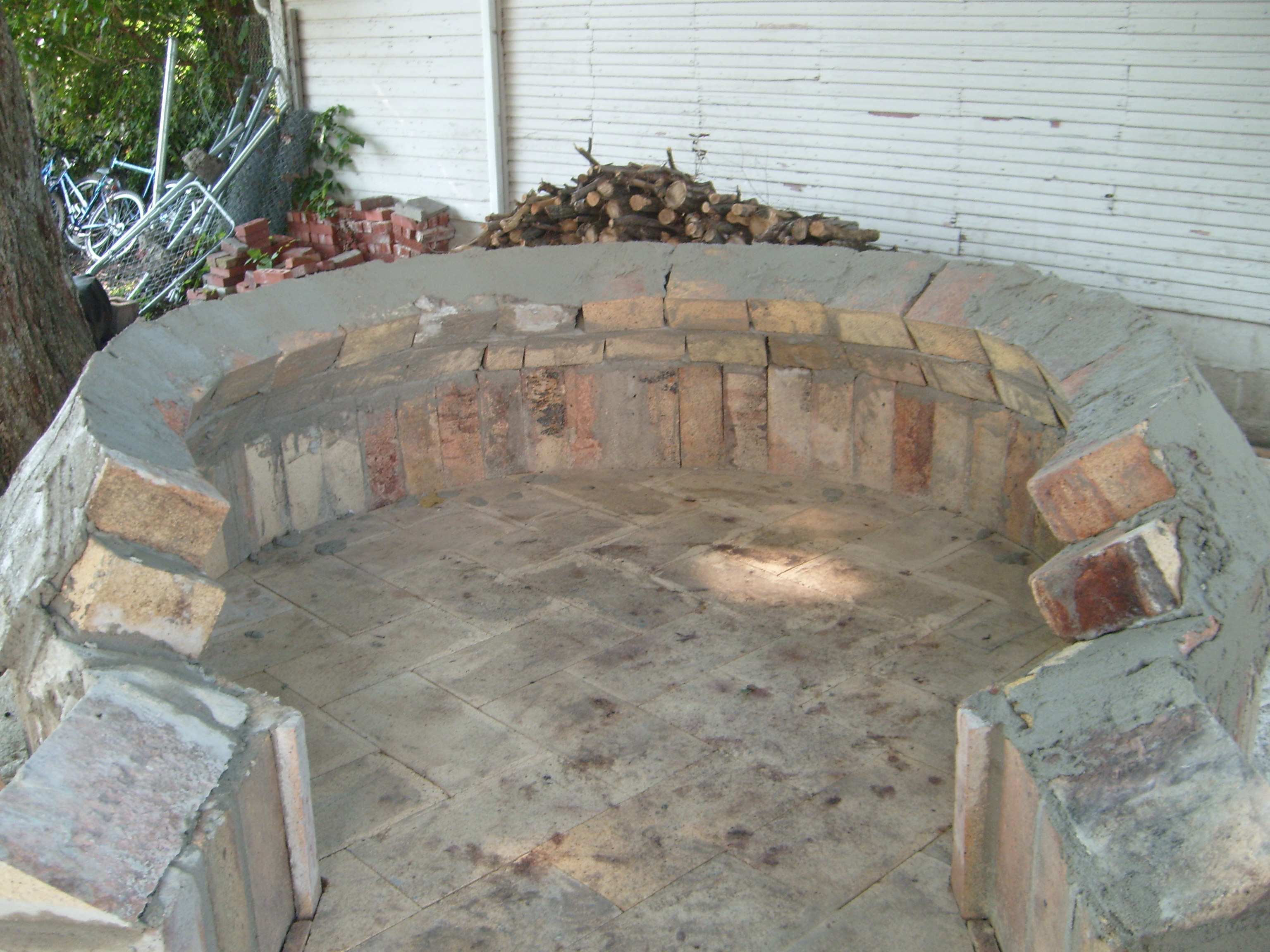

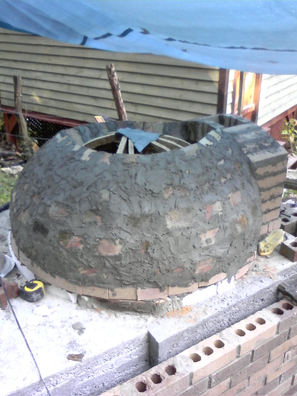

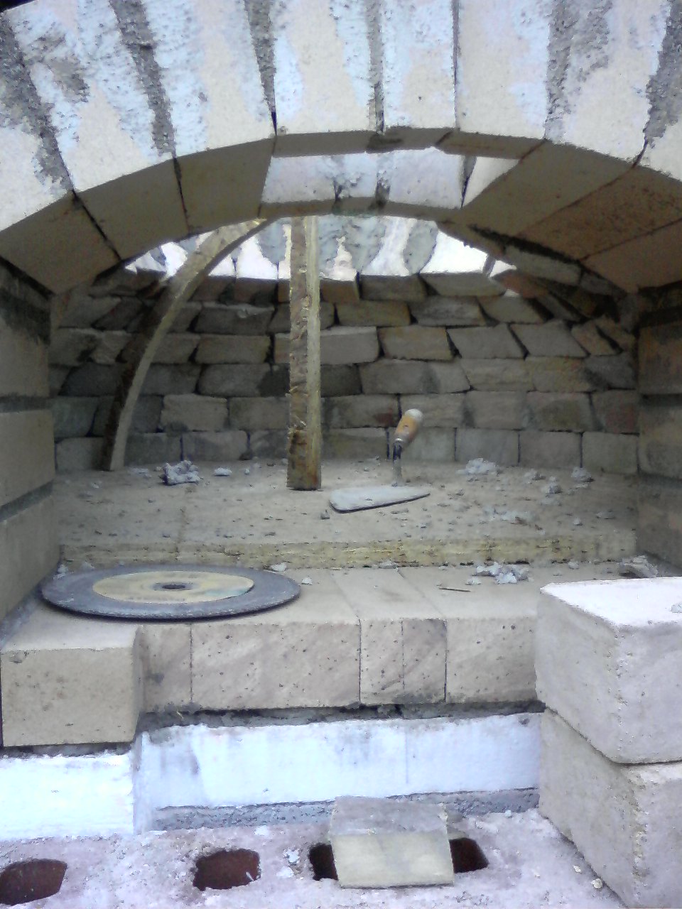

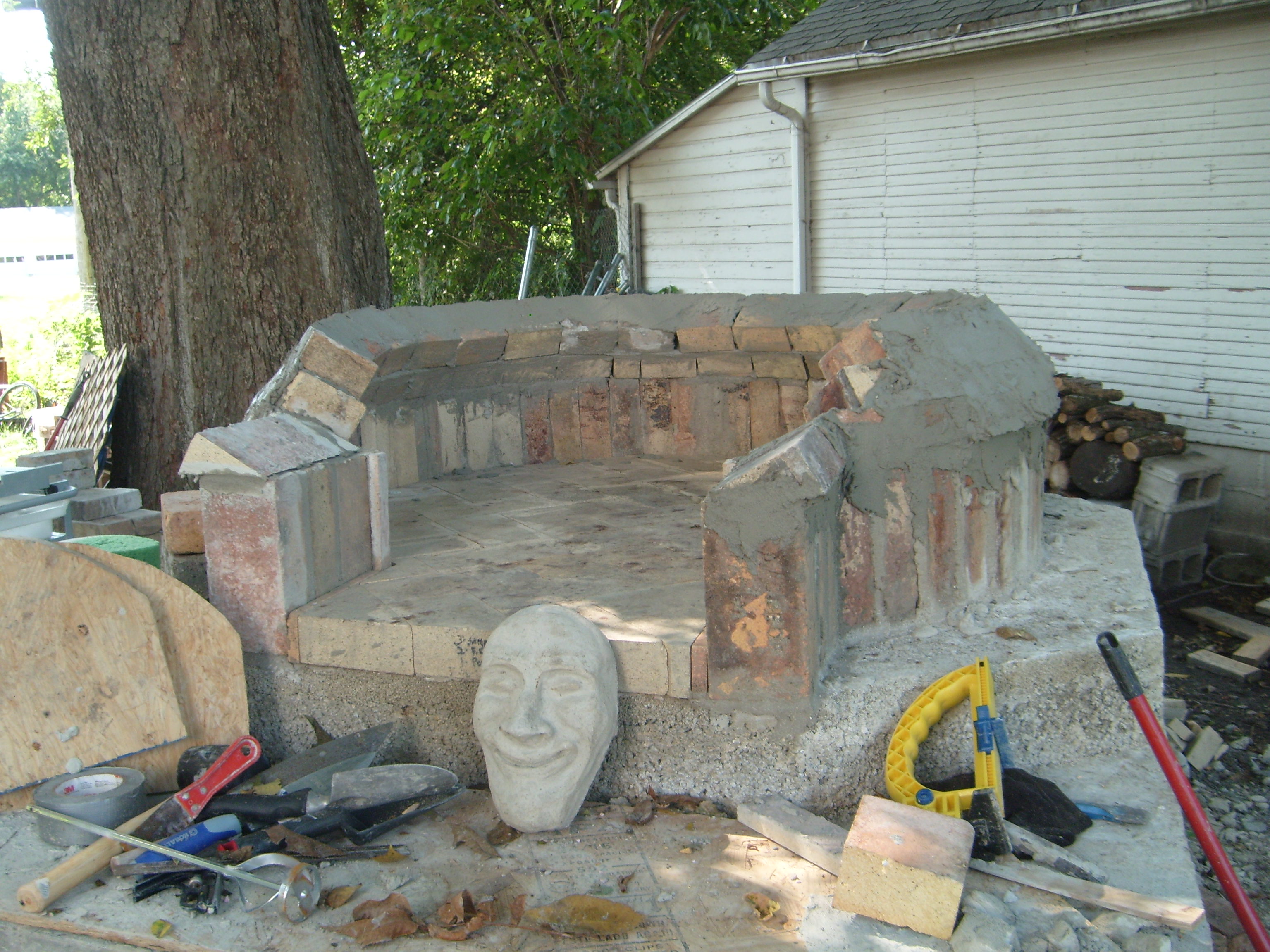

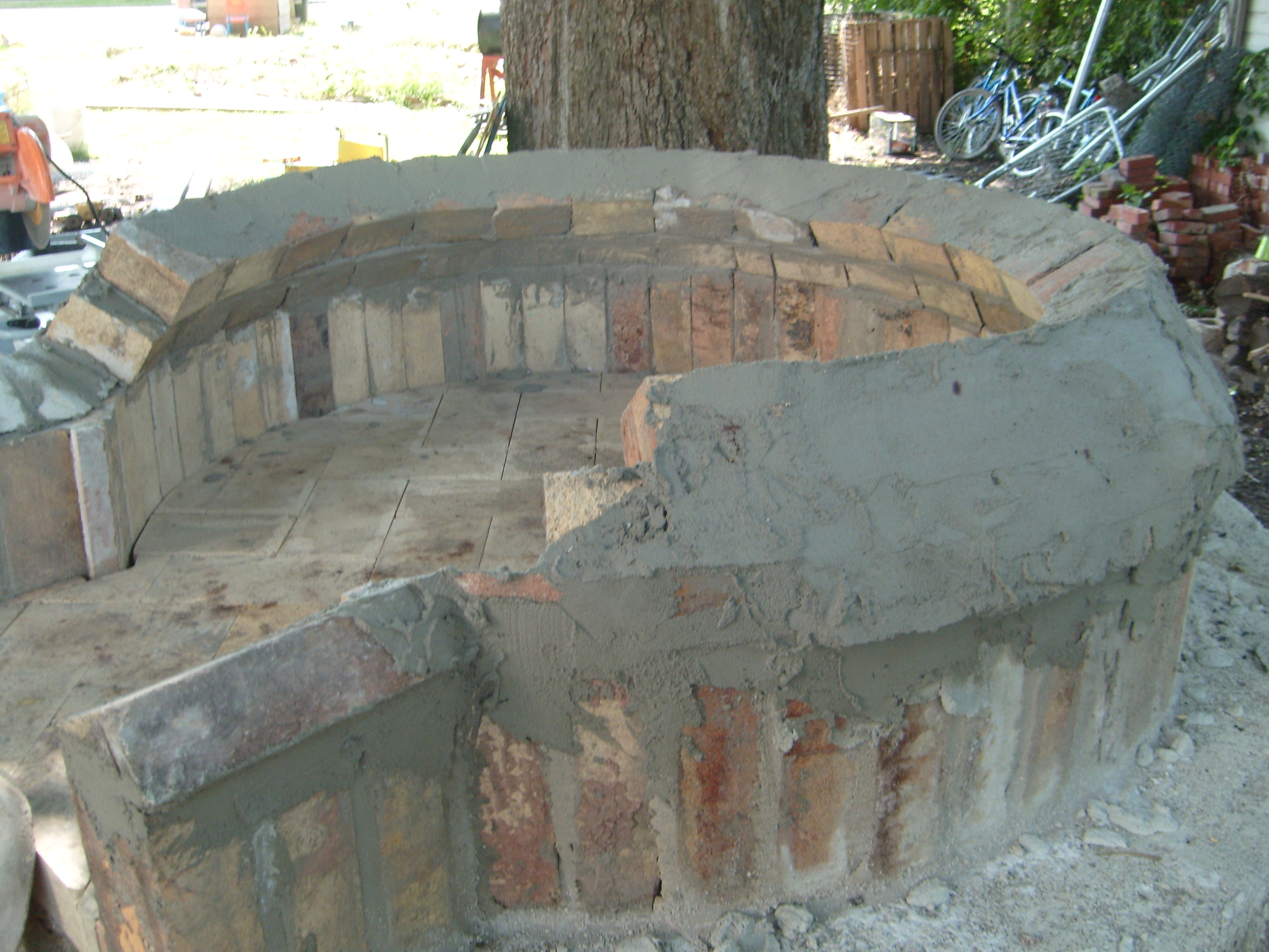

    I hope these pictures are posting.
    This is where we are in our oven progress. We put wedge shaped bricks inbetween the soldier and first ring. so the backs of them are sticking out on the back side of the oven. Overall I think ours looks kinda sloppy - I think our bricks need to to be closer together....
    That's where we are. The opening is my hurdle I must get over now. At first we started the walls of the opening, but didn't have something to put the door up against when - so we took down the walls of the opening, and added a tiny bit so we could shove the door against something. Does that make sense?
    Anyway, I keep looking at photos and that's where I get my ideas. If anyone has advice - I'm open to it.
    I wonder if sawsalls have diamond blades. I'd shave off the back of the dome...heh heh heh.

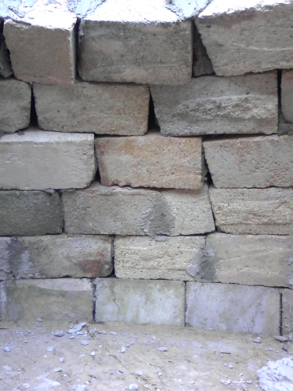

    Looking good so far! Your brickwork reminds me of mine. So I don't think it looks sloppy.
    If you are going to use a form or a hinged tool like http://www.fornobravo.com/forum/f28/...heme-2985.html, it will help you keep your bricks pointed more towards the center of the oven and minimize some of the gaps between the inside corners of the bricks.

      Thanks, Darius, for the boost of confidence! Maybe I'll see about getting that tool. I would like to order the blanket insulation and get my dome done in the next few weeks...
      I can't see the inside of your oven, but the outside is quite better than mine - I am not happy with my opening!
      I know I'm supposed to keep all bricks touching as much as possible - no gaps on the inside - but I never thought about having to keep the bricks pointing towards the center.
      I was looking through the thread about the indispensible tool - can one order that somewhere?

            If I would've used the indispensable tool, I'm sure I wouldn't have had these gaps and irregularities. But I had the same problem you did- I was ready to build my oven, not a tool. I'm trying to get this project done before it gets cold, and I'm sick of my electric oven.
            The outside of my oven isn't perfect either, I just smooth it all over with mortar. I've been using these old bricks that came out of a boilerClick image for larger version
ID:	277091 and I've been scoring and breaking a lot of them, leaving it pretty rough outside.

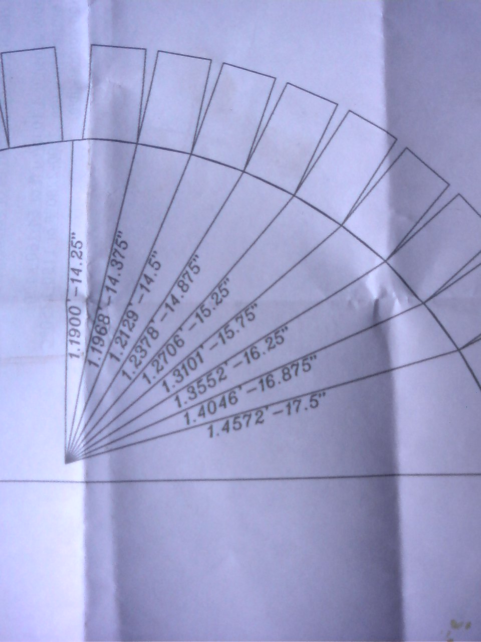

            Besides the forms, I have a profile drawing of the oven as a guide to help me stay within my designed dimensions-Click image for larger version
            I think I will put the forms back in today though, I'm getting pretty close to vertical with the chains and I would hate to set a few rows of bricks only to have them cave in!

                  Not that it's absolutly necessary, but those gaps could be avoided by cutting your bricks with a mild taper. Each course will taper a little more (its actually a compound taper) as you go up. It's not tough to do, but it does take more time. Here's a pic of what it looks like...

                    your oven looks fine,,,, You might want to get a mortar bag and point the inside bricks some more to fill the gaps, almost like grouting floor tile if your familiar with that,, a mortar bag is like a cake decorating bag, you fill with mortar and squeeze it into the crack and spaces.. then you can smooth it out with a dowel,,, or just use your finger, that will tighten up the inside of your oven a lot,, and if you have leftover mortar at the end of the day just apply it to the outside of the bricks,, I did that,, then used a sponge to smooth it out,, Keep up the good work, your son is doing fine
