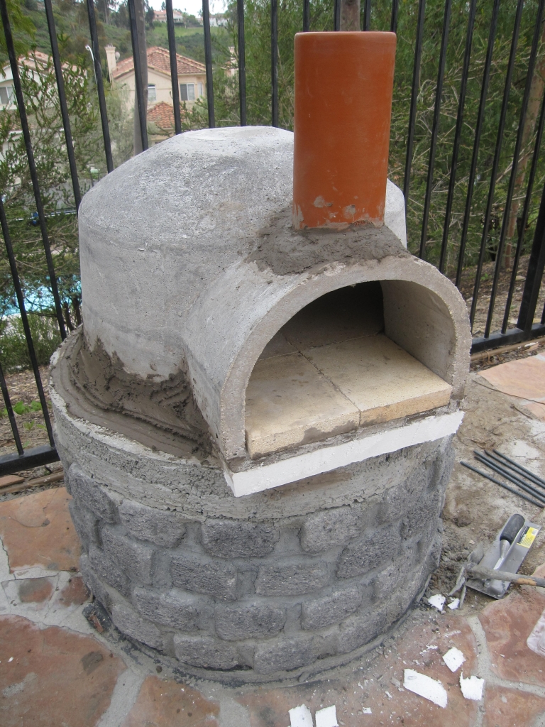

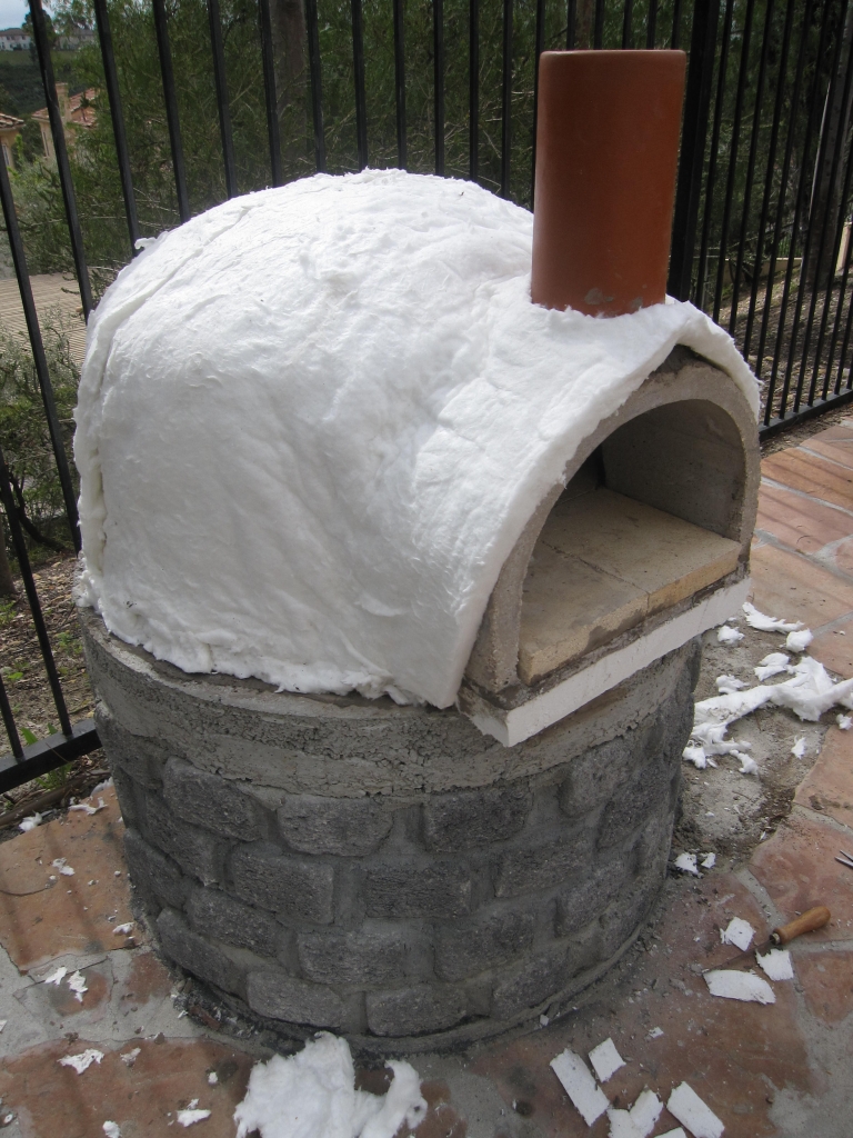

No rain this week-end! I was able to attach the chimney using the supplied refractory mortar:

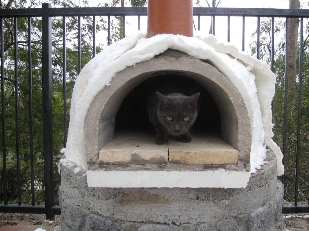

placed the first layer of insulating blanket. The blanket is fairly easy to cut and shape, although it takes a little bit of adjustment because of the dome shape and the width of the material:

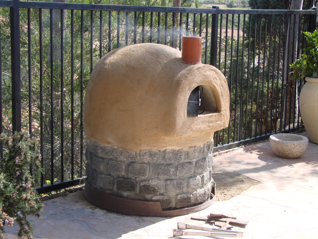

We passed inspection

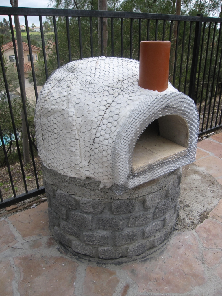

And had time to place the stucco lathe on the 3 layers. I ended up using chicken wire for the dome and a honeycomb structure for the front. Tomorrow, stucco!
