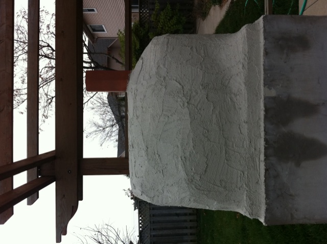

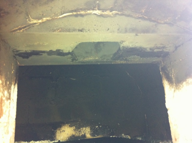

ID:	283411I will. Thanks again. Here are more pictures that might help.

                Good, the vent/chimney is fine. In your last picture, I can see dampness coming out of the oven and into the stand. You probably need to seal the whole thing, and maybe try a long medium fire to dry it out.

                  It was raining last night so I am not sure that it is coming out of the oven. What do you seal it with. I am doing a long fire tonight.

                    If it is cementious stucco use something like Prime-A-Pel, but that will not bridge cracks. If it has cracks use an elastomeric paint.
