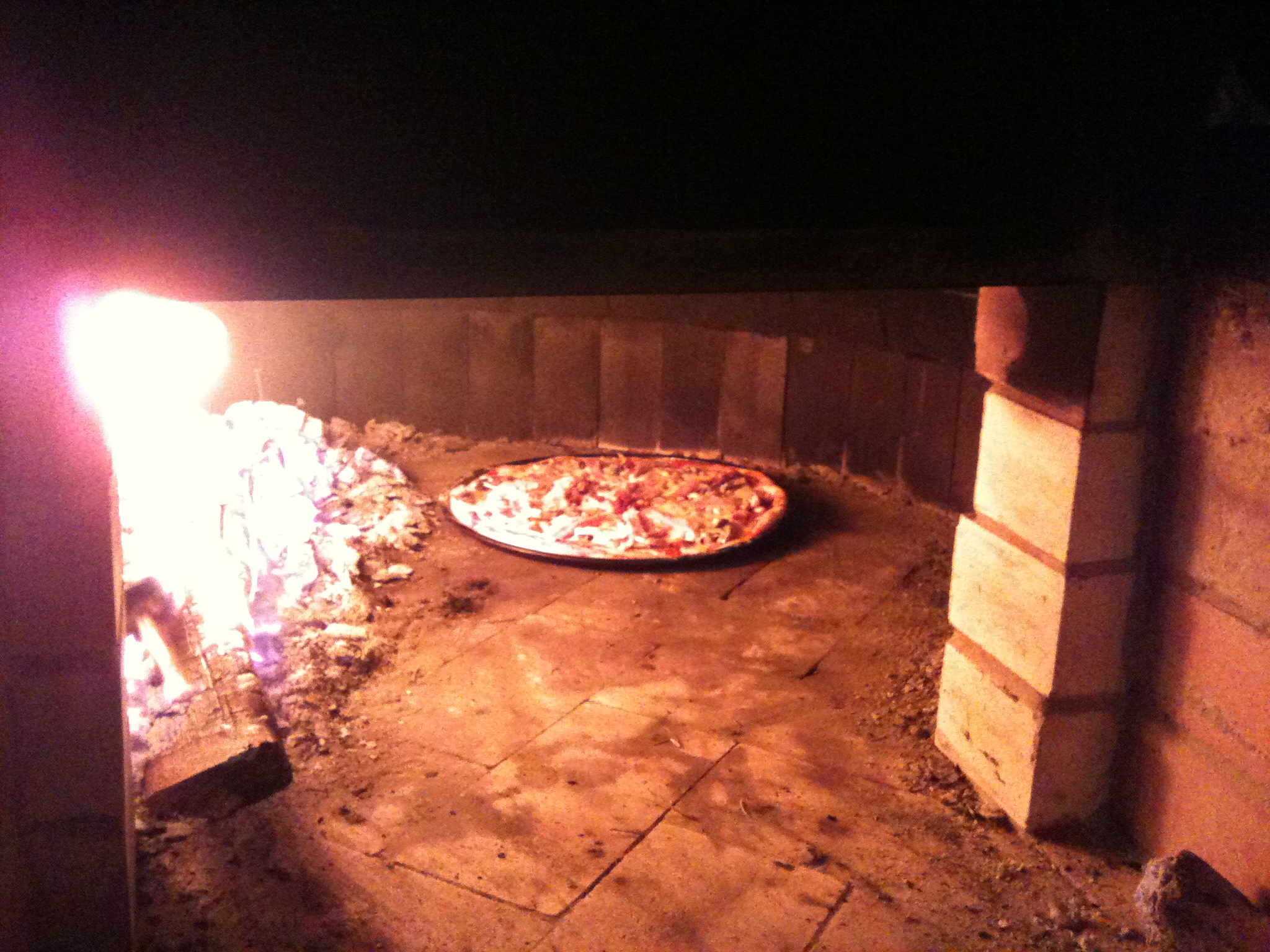

          I hadn't planed to cook so early but we had a good fire from the ply we had to add more wood and it was a slow cooked pizza so definitly not as hot as i cook now.... but tasted pretty good. The oven had been allowed to sit for a few weeks so the mortar lost it "greeness". Was I nervous that it had cracked....YEP you bet I was...checked it out next morning no cracks. I do have a few hairline ones at the entance /chimney connection but that ws not built at that stage
Name:	first pizza.jpg
          First pizza on tray handmade ply peel made on the spot.
          I did my insulation with ceramic and rockwool ...dry... no moisture to trap in the pealite layer. Only struck water problems later in the big floods early this year. My build called Cobblerdaves build in the Australian section of the forum
