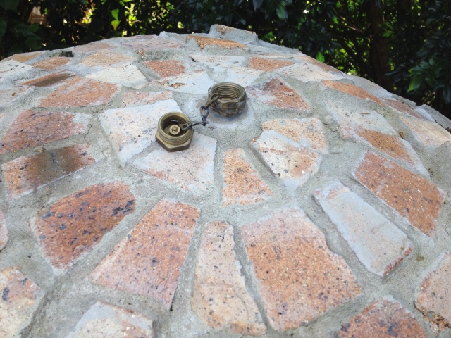

            G'day Rich
            Sorry for the late reply been a bit on the busy side.
            http://www.fornobravo.com/forum/8/mi...tml#post134013
            This should give you a link to Gulfs oven and also another discussion on the merits of a dome vent.
Name:	IMG_0898 (640x480).jpg
            This is mine take on a vent to suit my local conditions. Its basically an end piece for a 25mm (1in) copper pipe. I've added a bras chain to stop little fingers from taking the cap away. I can screw the cap down and seal the oven off as the local ant population head to the highest ground when rain threatens.
            To fit something like this in the dome its as simple as making a tube the right size from a piece of cornflakes box and rendering it into position. once the render "goes off " the cardboards wet and sodden and can be easily removed. let dry and what ever fitting can be easily silasticed in.
