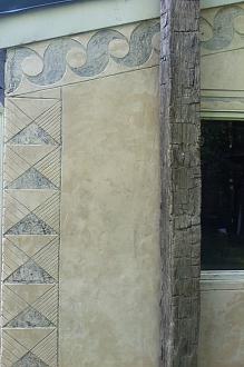

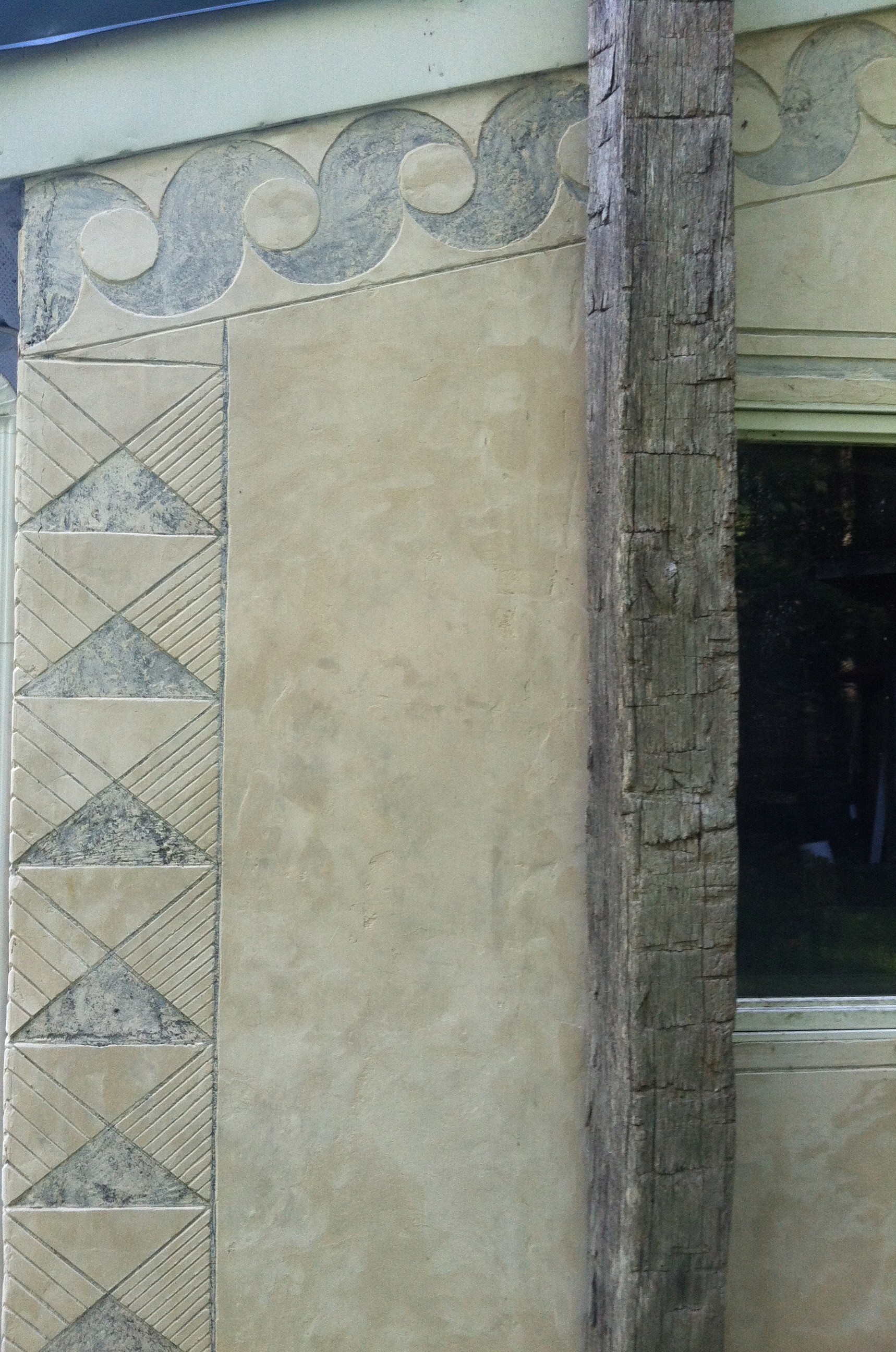

ID:	439095 btw, I plan on baking once a week or so, I'd say mostly sourdough boules, pizza once a month. My mom taught me to bake bread and make pizza when I was a kid, 7 or 8. Been doing it ever since, but never considered myself more than average at it. I just like making things...the process of it.(I'm an artist and craftsman. I prepare a lot of my own oil paints and media, work with gypsum plasters and roman cements, fresco, etc.) I'm looking forward to not having to beat up my electric oven baking at 500 once a month. I've got plenty of access to free downed hardwoods for firewood, mostly red and white oak on our property, so wood isn't a problem. I'd like to be able to bake a loaf with the 'right' temp and type of heat. Thanks again for the advice.
                      Last edited by scagliolist; 06-11-2021, 09:21 PM. Reason: I've added a pic of the back of my studio showing some sgrafitto done in roman cement
