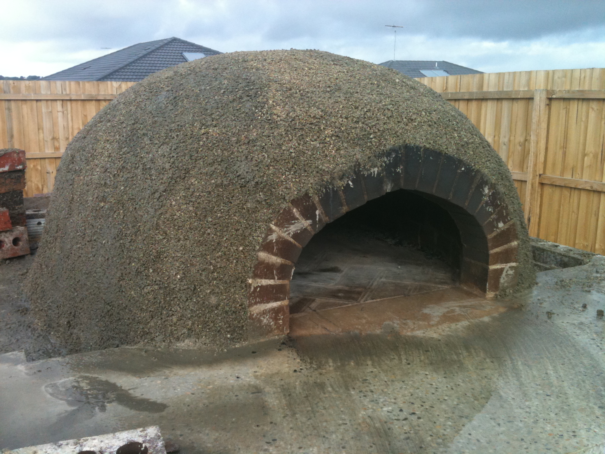

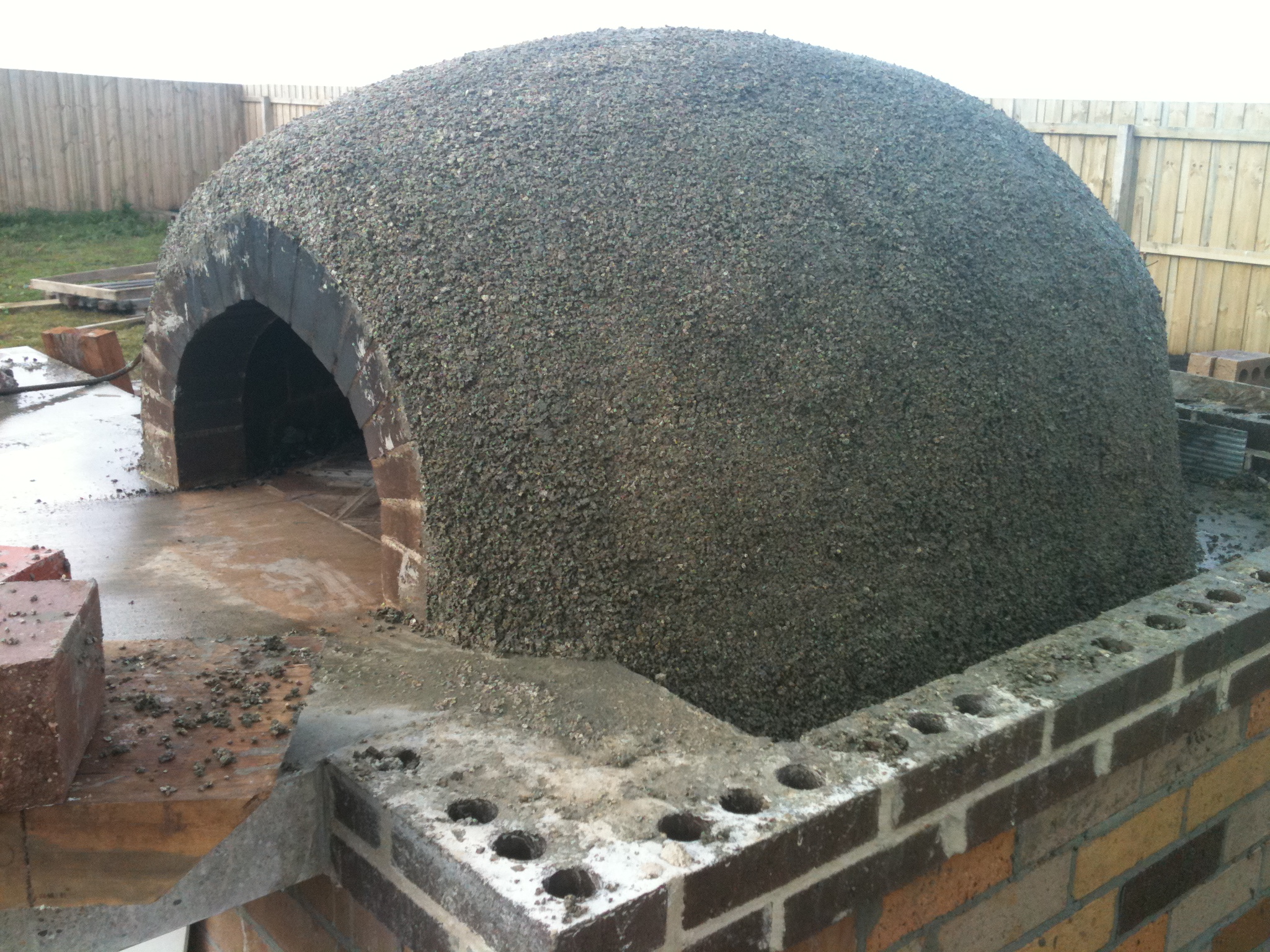

        pics of vermiculite insulation.Click image for larger version

        I'will be building a brick enclosure now and plan on a loose fill insulation. can anyone suggest a cheapish matierial to use?
        A friend suggested sand would this be ok? if so what kind of sand?
        • brickie in oz
          • Mar 2009
          • 3445
          #19
          Re: Hi, new Aussie
          Dont use sand, sand adds thermal mass and will not insulate.
          Get some vermiculite its around $30 for a 100 litre bag.
          Did you use some ceramic blanket over the top of the oven first?

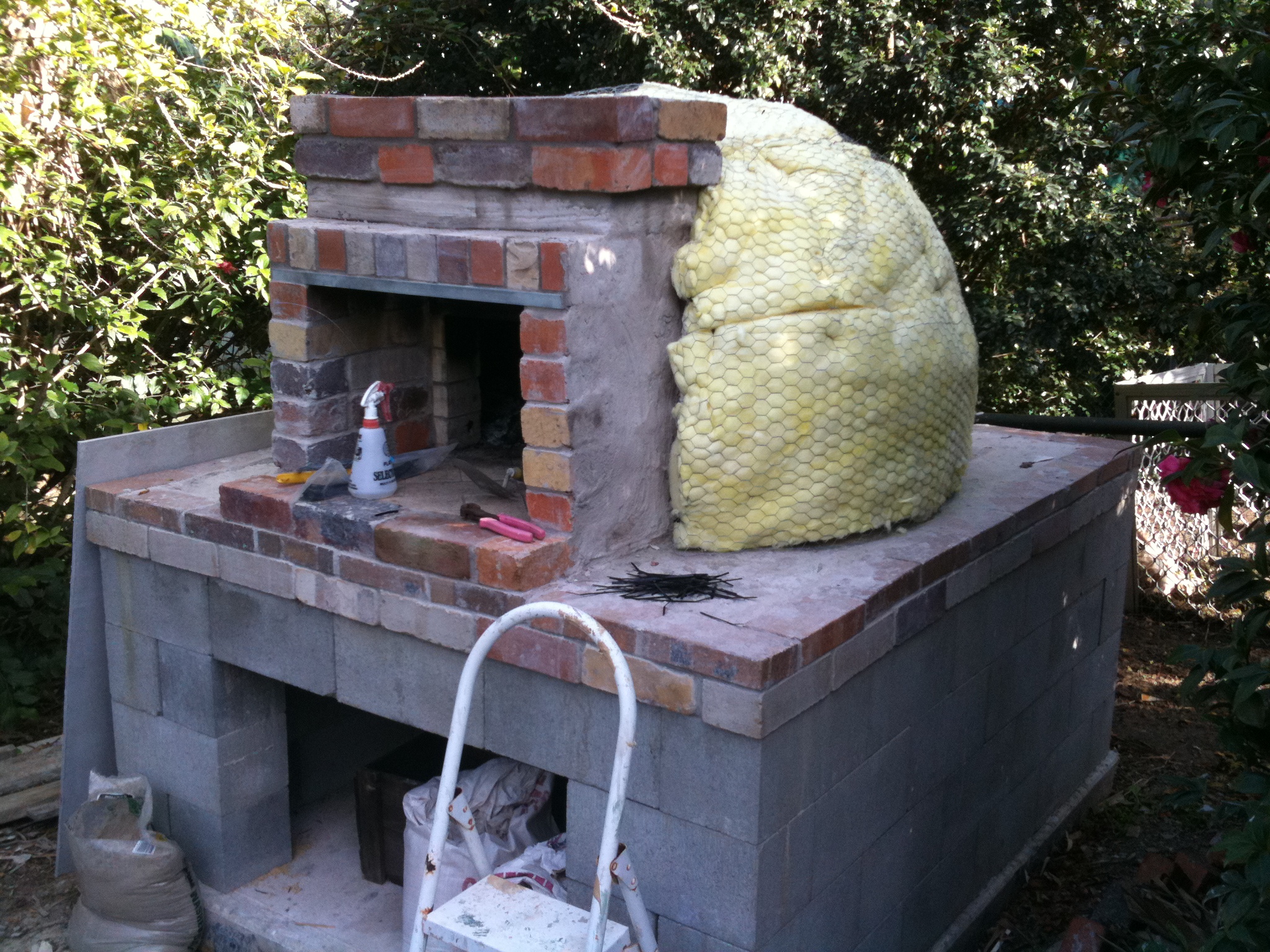

                              Dear Vicbrickie
                              I set out to bend a rule not break it. I fired this puppy twice and then pulled off a section at the back before i was happy. No smells, no melting... that ceramic blanket is amazing! was only warmish to the touch. It was only then that I rendered over it. Yes I used "rockwool" and the binder is sheeps wool.
                              Why don't you finsh the enclosure and leave the roof for a while? pack it full of rockwool and see what happens. If it doesn't work you can then change your plans with no damage done.

                                #30
                                Re: Hi, new Aussie
                                [ATTACH]25052[/ATTACH]
                                Im confused, which isnt hard to do , but you batts look like fibreglass batts, rockwool is usually brown and stiffer.
