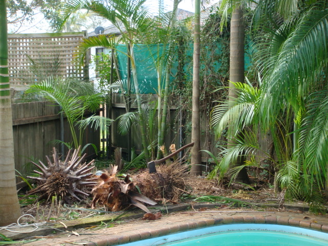

          Incredibly, my oven took 1 year to the day to complete.
          Cleared the space for the oven to go on 29/8/09
Name:	04 Cleared Space.JPG

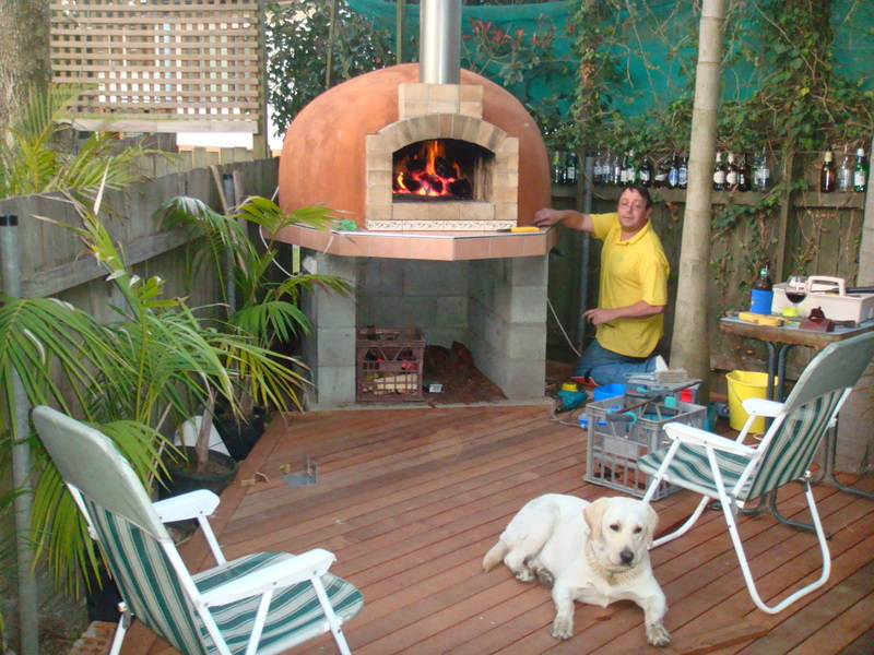

          Finished off the deck around the oven on 29/8/10
Name:	103 Nearly Finished.JPG
