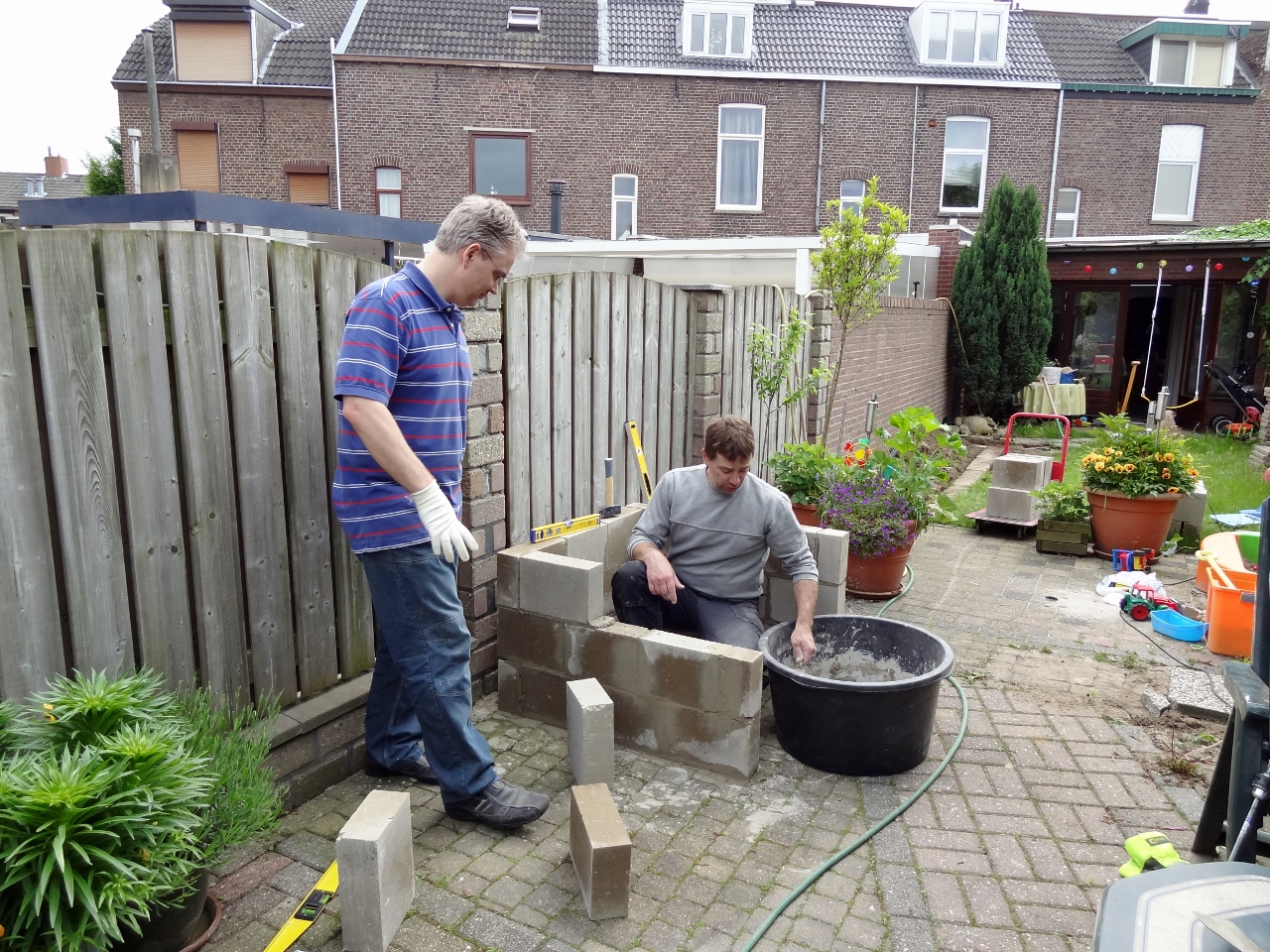

        Okay so here goes the first bit of our construction.
        Last week: building the oven base (and a flower bed along the wall), they'll both receive a layer of stucco later.

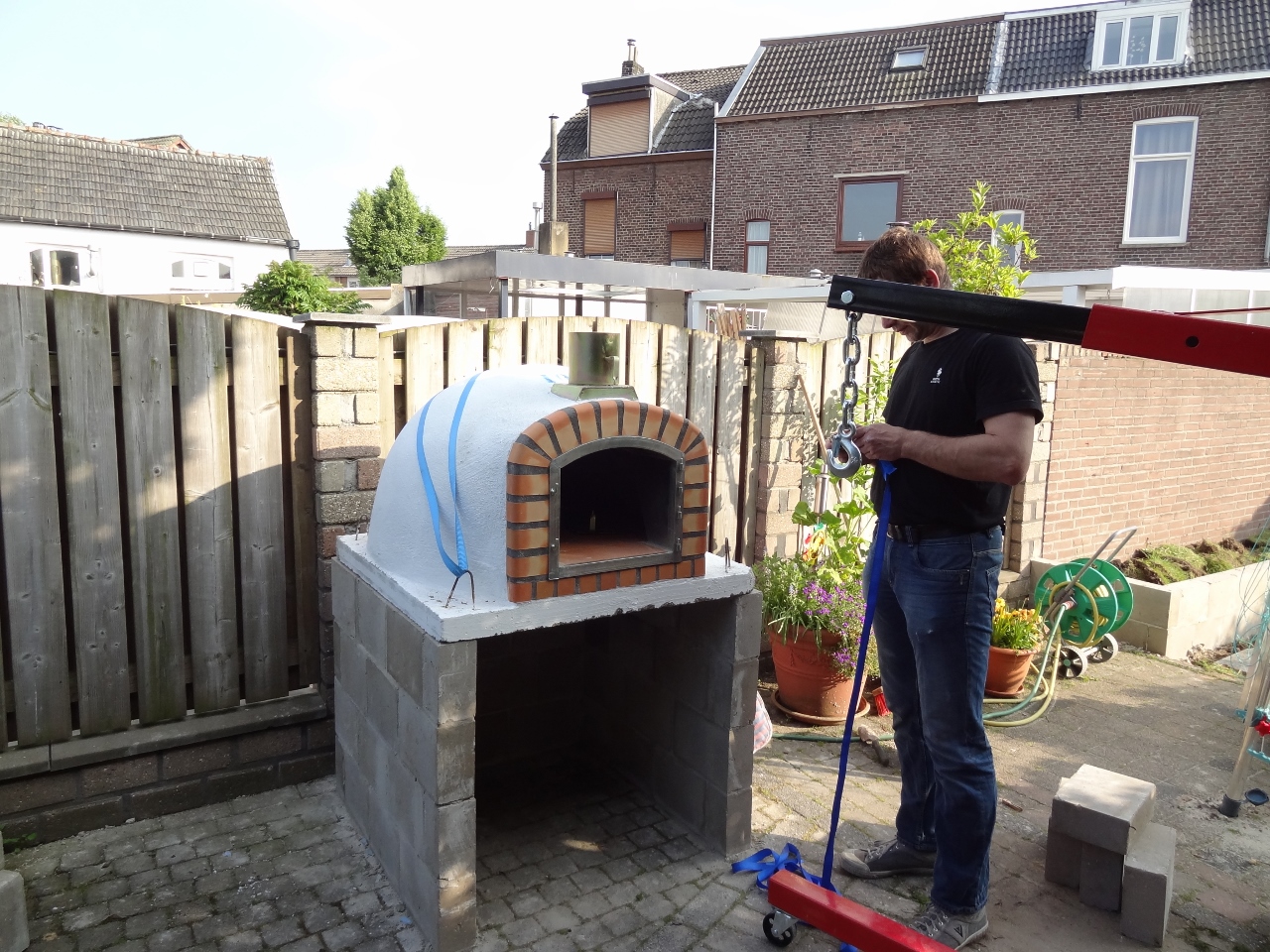

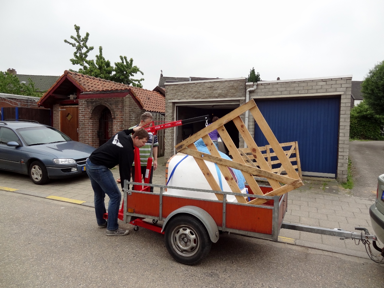

        The oven arrives
Name:	DSC00557 (1280x960).jpg

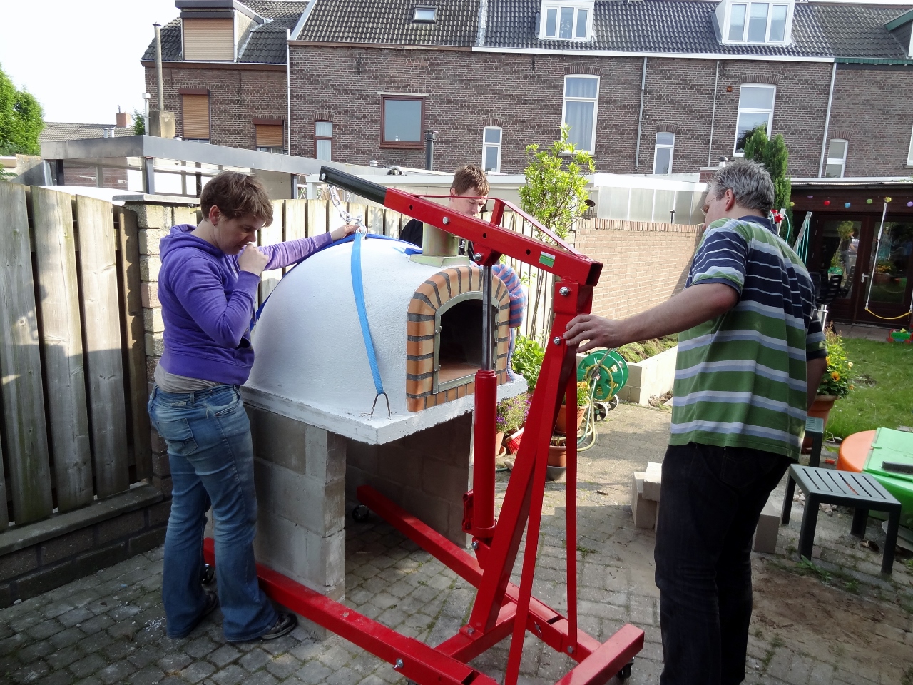

        Placing an oven takes some thought!

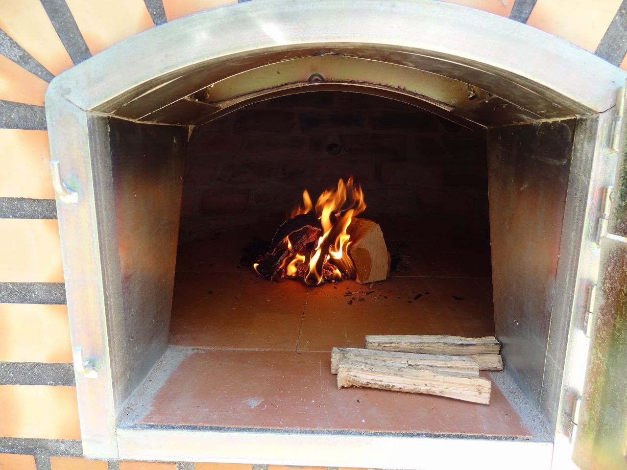

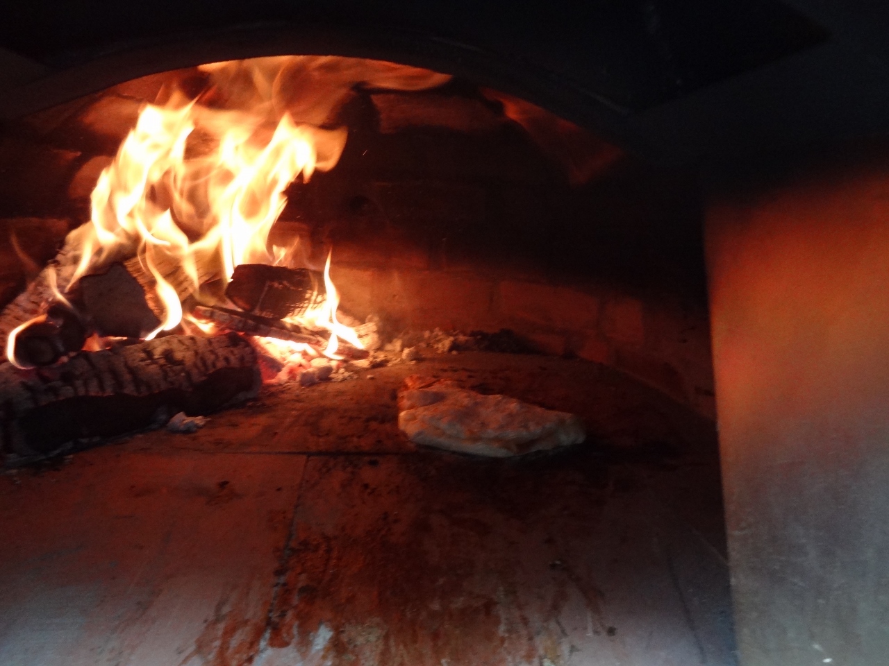

        First small fire
Name:	DSC00579 (1280x960).jpg
        Keeping a fire this small alive is actually quite hard!
        We've fired for about 6 hours @ about 100 deg. C today, tomorrow I'll build the fire a bit bigger.

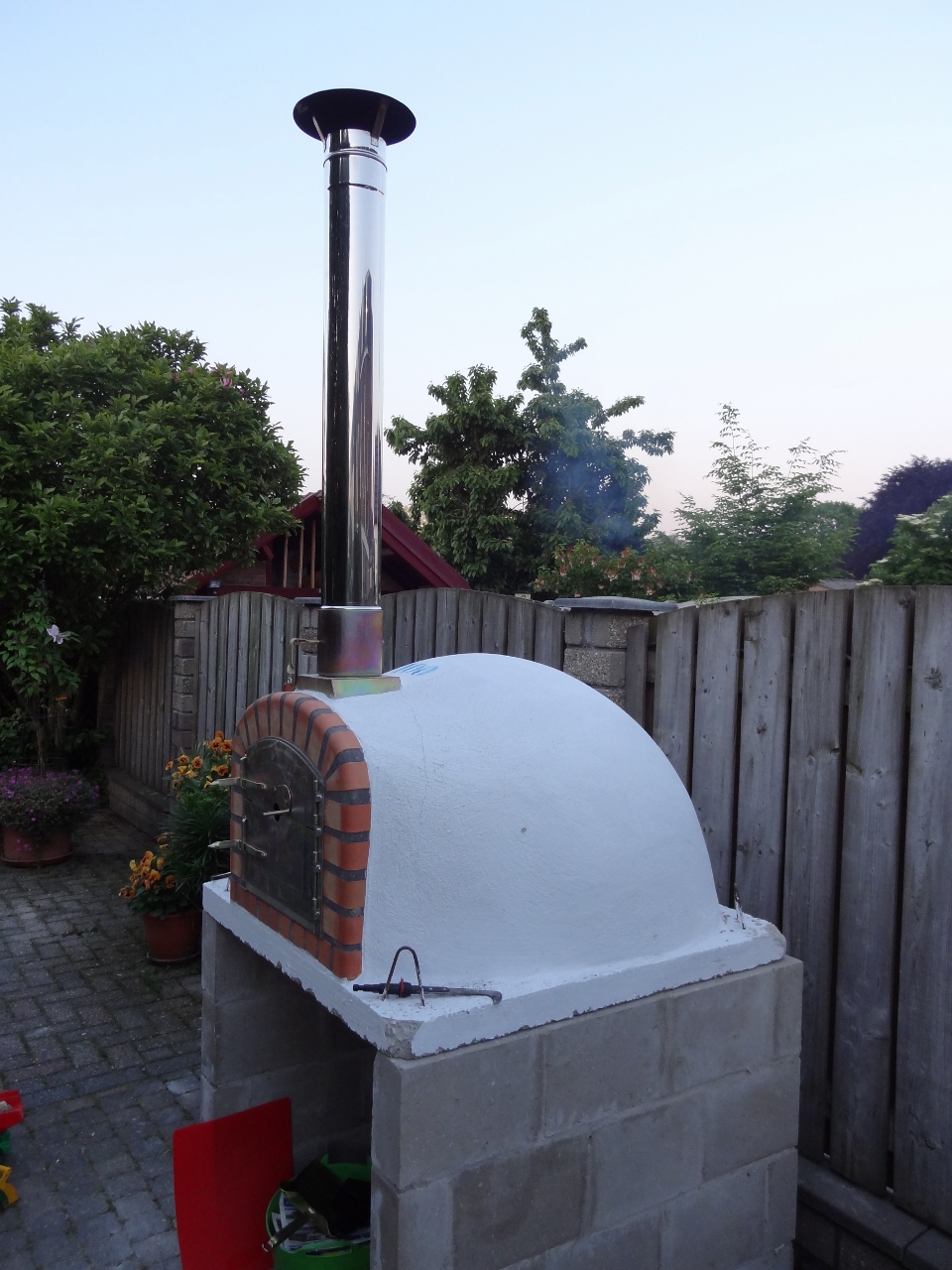

                      Is this a better view? Not the best of pictures due to the waning light.
Name:	DSC00584 (960x1280).jpg
                      There is indeed a damper in the flue.
                      We had a choice of a flueless oven, one with the flue on top of the dome or the one we have bought, with the flue on the front portal.
                      Firing the oven a bit hotter today makes it all the more apparent that we need to insulate the thing further, the outside got to about 80C at its hottest point, around 60 on the sides. Measuring the bottom slab I get to about 45C (while inside the floor tiles get to about 200C outside of the fire, I have not moved it to measure directly below. I feel insulating the outside and bottom will give us the biggest improvement at the moment. And anyway, as you say, pizza's are the main goal at the moment

                        Today we had our first pizza-session. The first one went horribly wrong, I couldn't get the thing from worksurface to peel and it kind of ended in a mess. A tasty mess however
                        The second pizza I made on the peel but it wouldn'd budge when I tried to shove it in the oven. We turned that one into a calzone. From the third one on I had the correct swing and we had a great night.
