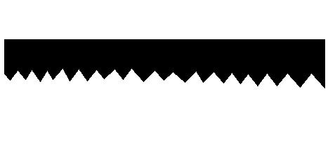

            3-If what you have already is a rounded oven and want to avoid burns I would suggest that you go to an iron fabricator to make a sheet of 3 mm thick steel formed like the drawing below and to bend it like a bow so it can support itself with the teeth downwards. After you push the coals aside, nest them with that sheet with the teeth downwards. This way you protect your meal from burns leaving gaps (between the teeth) in order for the air to circulate and keep the coals burning.
            Hope that helps. If not ask again and I'll try again
