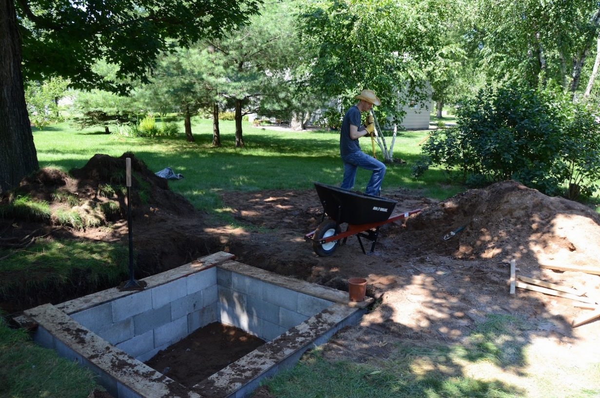

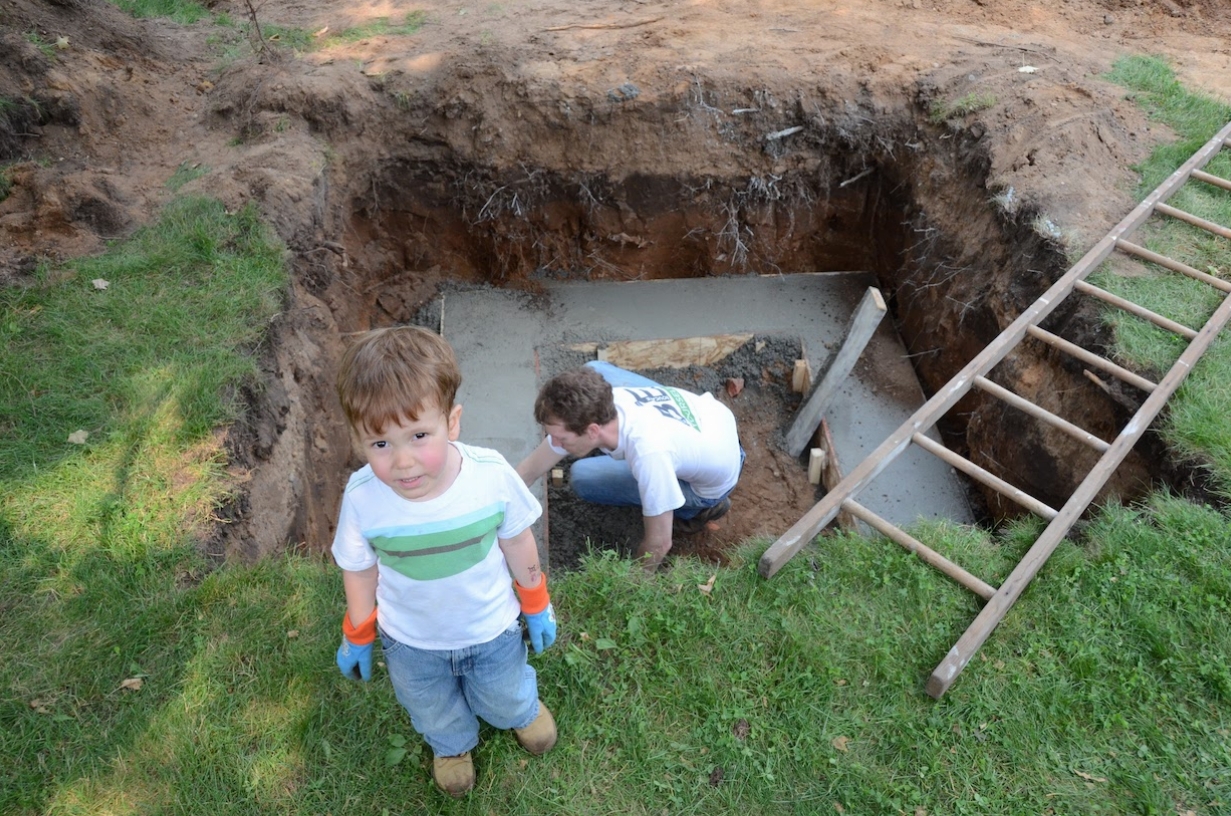

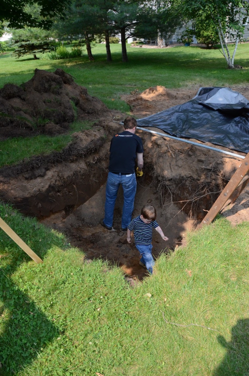

                    I know this thread is pretty old, but I thought I'd update it with what I ended up doing.
                    I dug a basement. Well, technically a friend with a backhoe dug a huge hole for me.
