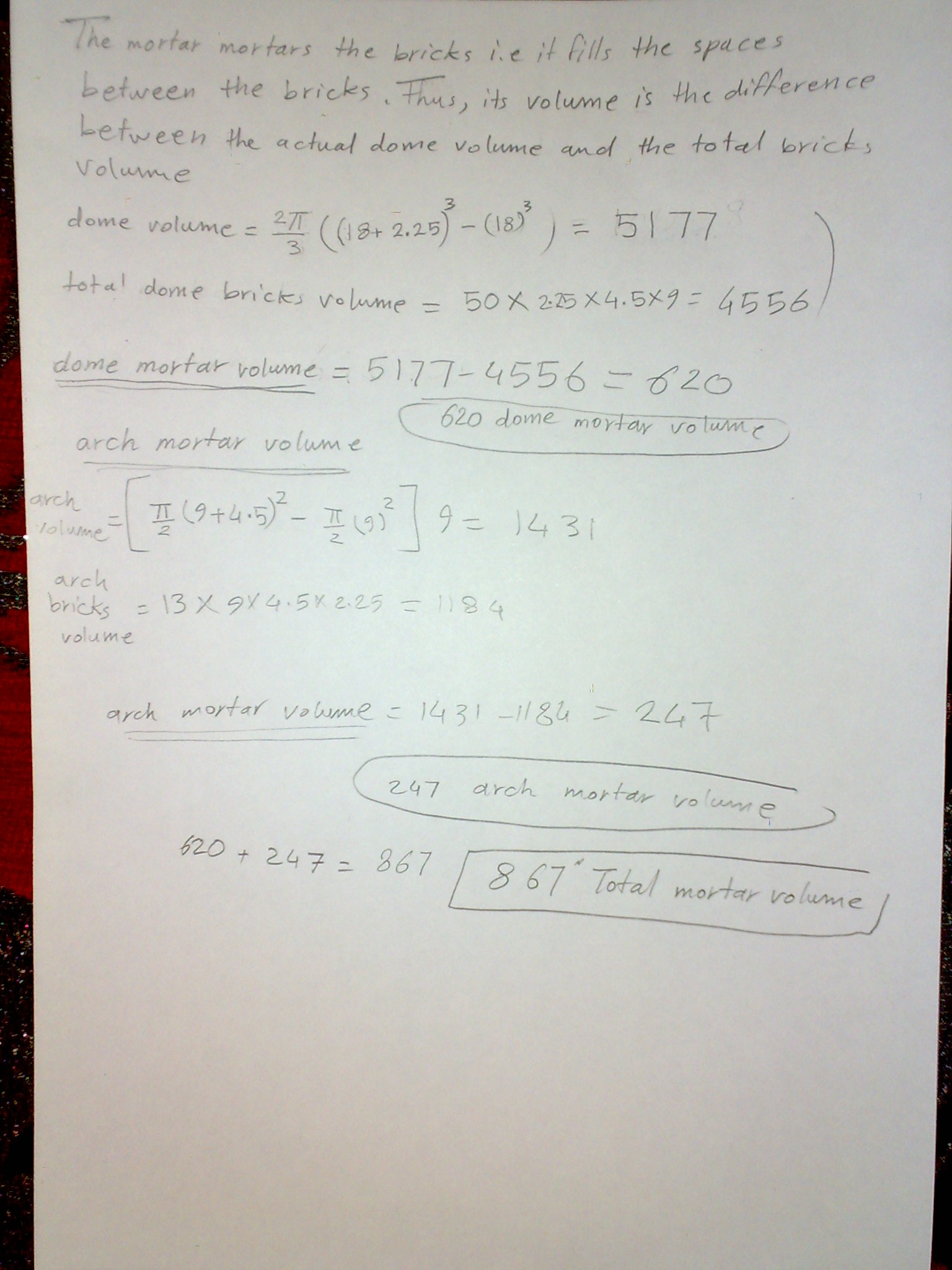

    As for mortar, I did the math too for the rounded shape, I'm not sure, all I know is that you need about 1000"^3 of (mortar mixed with water and ready for mortaring) Ask your supplier what the volume of the ready mortar is. It should be more than 1000"^3 i.e 17L, make them 20L just in case.
    As for the right material, I reckon you are purchasing the right stuff. You must be as generous with insulation too.
    Here is the draft of my calculations you can justify them, I'm not a mason neither a mathematician. I'm just trying to help.
    The machine is losing the uploaded images. I'll post them to you a few hours later.

      Here is the mortar calculation

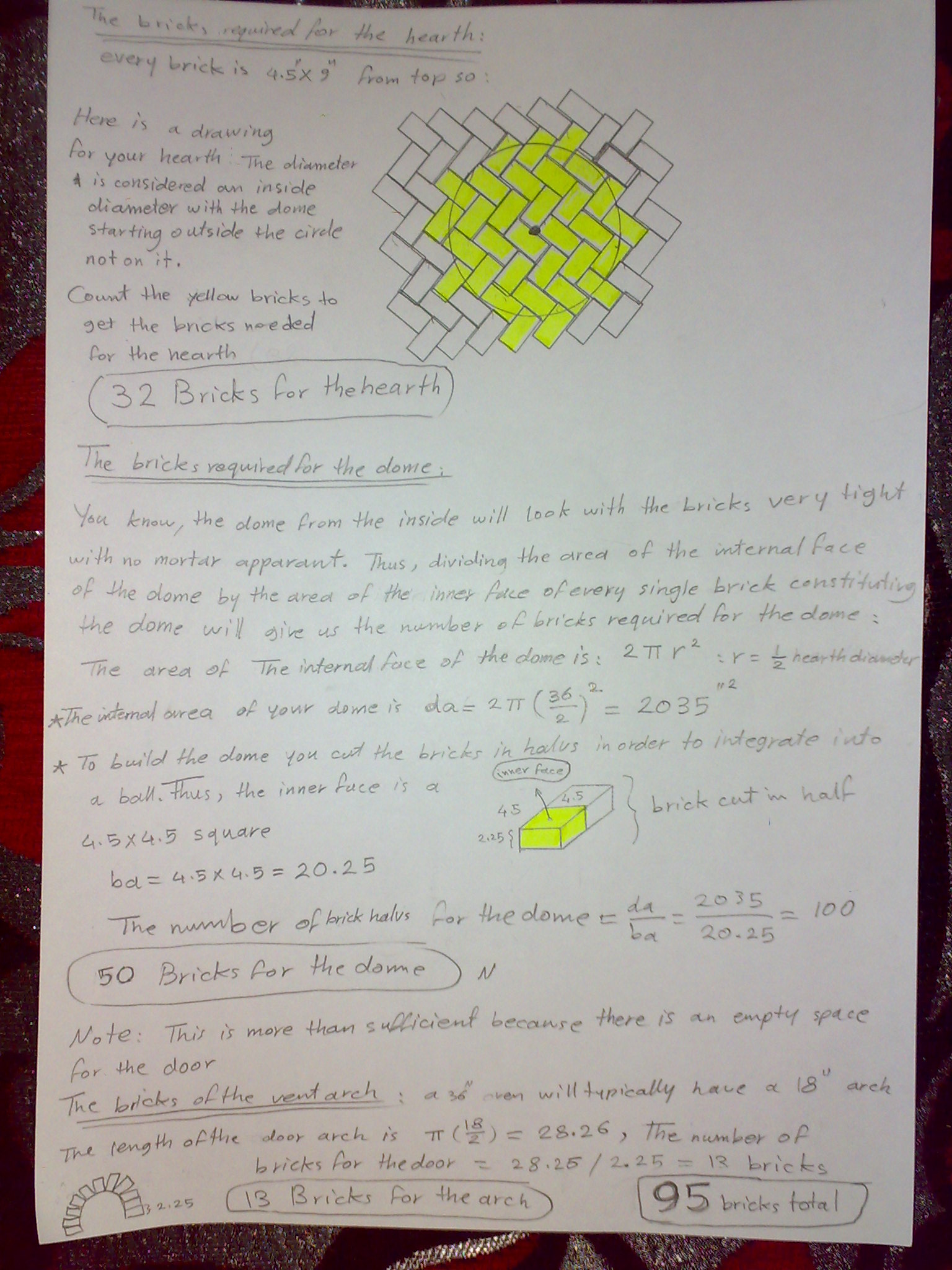

        and here are the brick calculations

            That sounds a little tight on the bricks there v12spirit. You forgotten the entrance hearth and entrance way
            If you go back to the plans for a 36 in dome it calls for 60 firebrick for the hearth ( and entrance way hearth. 120 firebricks cut in 1/2s for the dome and a further 30 common bricks for the entranceway. Its a bit over in its calculations in one way as accounts for a bit of waste for cutting the bricks sides.
            My own oven 42 in consumed 160 firebricks for oven and entrance hearth and dome. I used commons for the entranceway. That's with minimal cutting as well
            So DB your going to be very close at 185 bricks if you don't do to many fancy cuts of course. I recon you could find yourself just few shy though you just can't tell.

                      Thanks for paying my attention to those omitted calculations. I am embarrassed by not reading the plans carefully, but you know I'm building with steel so I skipped the chapters that don't concern me so far. After considering those omitted calculations I end up with 10 more for the vent landing, and 13 more for the door entrance the total is 95+23 = 118 or 120 say provided that the chimney itself is not included. BTW when I did the math for your 42" oven I got exactly 155 bricks.
                      DBinnema,
                      Dave has given you an elegant, simple, and reliable answer so go with it. You may use my papers as a concept if you plan one day to build an "immense" oven that no body has built before to be able to tell how many bricks will be needed
                      When you use my equations, add half of the result to get how much to buy so that junk bricks/cuts are considered:
                      120+60 = 180.
