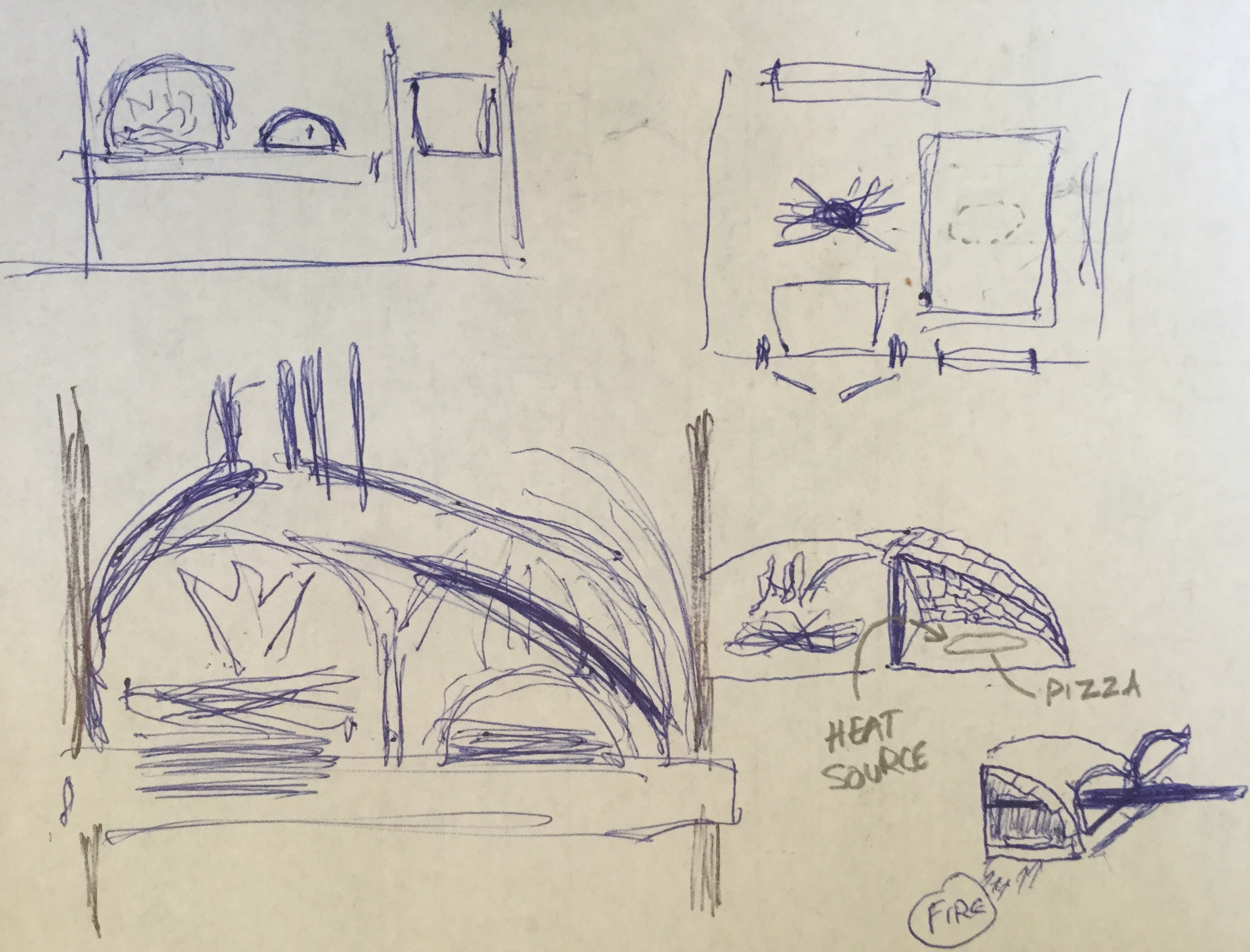

    We are building a new home and want to construct a side-by-side fireplace pizza oven combination in our kitchen. We want to have two connected internal chambers and two external doors. Any thoughts on feasibility? Plans?
      I think you would be better off doing it as 2 separate pices. You will compromise the cooking abilities of the oven severely by having it open in side. You want and need to be a sealed chamber that is well insulated. Then you can use it to bake and roast with retained heat. Also it makes it easier to cook pizzas. You could have them next to each other but do not connect them. They will both be compromised.
      Randy
        That's great, I suspected this wasn't going to be easy. Our fireplace opens into the kitchen and has a sealed glass door facing the dining room. The fireplace divides the rooms. I wanted to keep it to one fire surface and have the fire at the mouth of the oven which I thought could be elevated and smaller than the main chamber and have a curved, low ceiling. I realize we'd need to only use the pizza oven door only when cooking and it may not heat up enough. We would consider adding a gas fed heat source additionally. The fireplace will already be fit for gas regardless.
        Do you think it would work or still no?
          Some sketches. Thanks for your help.
            We were also thinking about having an internal door in the pizza oven that closes off to the main fire so that it could be gas heated then open to fire and close off gas to continue with wood fire cooking. Are we pushing for something that is to complicated to resolve?

              There are scientific reasons why this is not a good idea. You need to have a certain ratio of dome height to door height to get proper combination. Also it affects how say a pizza will cook. It has a lot to do with radiant heat. I believe fireplaces also have certain rules that alow them to properly operate. You could end up with a situation where both sides function poorly. A door in the middle also won't be a viable option unless it was extremely solid and heavy-duty and then you would not be able to open or close while operating. It will be easier and less work to build 2 separate units and then they will both function properly. If space is limited then you could use the oven as a fireplace. They produce a lot of heat. I did steaks in mine the other day and would guess the temp at around 1300F that was 2 min a side. If done right they are very useful.
              Randy
