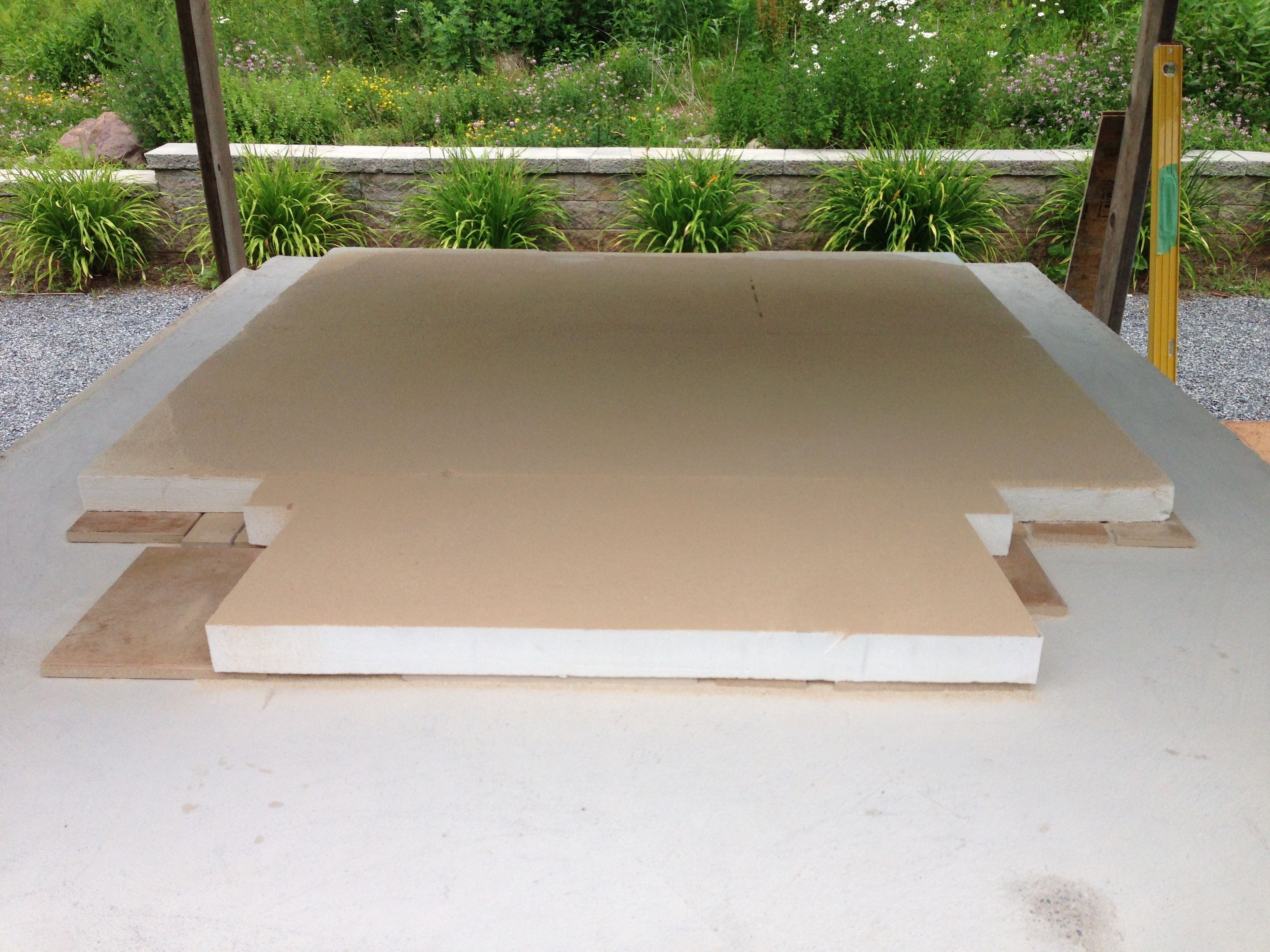

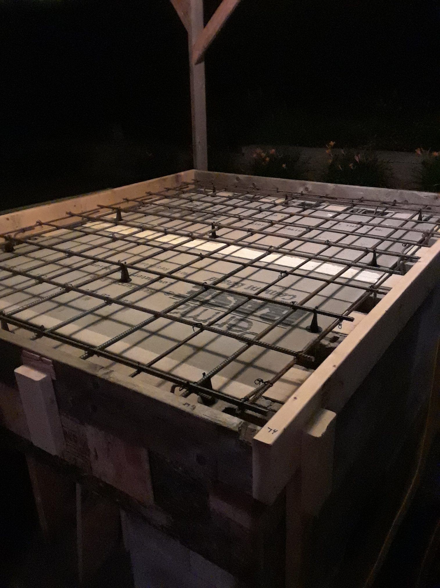

    I have been a member of the forum since 2010 but finally had the time to start my WFO build. Started a few weeks ago when my son who had been working as a pool builder BC (before cov19) He came home and wanted to build our oven. We already had done the slab a couple of years ago when we poured a concrete patio out back. We built a concrete block stand, filled every other hole with rebar and concrete, poured our rebar reinforced 4" slab, let it cure for a week, built an IT, drilled weep holes, placed scrap pieces of Italian porcelain tile over a sand fireclay base, laid out the FB sheets and we just finished cutting and laying out our floor with 18x18x2 fire bricks (some were a bit warped so that took some time. We cut the bricks to size so we can place the dome on the FB, not on the oven floor. It was a challenge getting our floor level. The FB sheets we had were from two separate boxes and the thickness was different by 1/8." Had to use some sand clay mixture to get everything level. It's been a good experience so far. Look forward to getting started on the dome.

    Had to take a break because my son totaled his car after hitting a deer, his third one in 3 years. Also had a problem with the sand/fireclay mixture used to level everything. It kept getting on my wet bricks and messing up the level on my first course. I ended up using the Aussie method that I have seen where they put aluminum foil down over the fiberboard. What a good idea. The first reason to use it is to keep the fiberboard dry when building and the second reason (just as important) is to keep the sand where it belongs and not on the firebricks. In my experience, I couldn't get the refractory mortar to stick on the bricks without washing and wetting them first and keeping sand off them. I also never used mortar and had to find the right consistency. I have laid plenty of tile using thinset but the two are very different. I finally finished the first course today. Pictures to follow.

Name:	FB OvenRebar.jpg
ID:	427467 Click image for larger version
