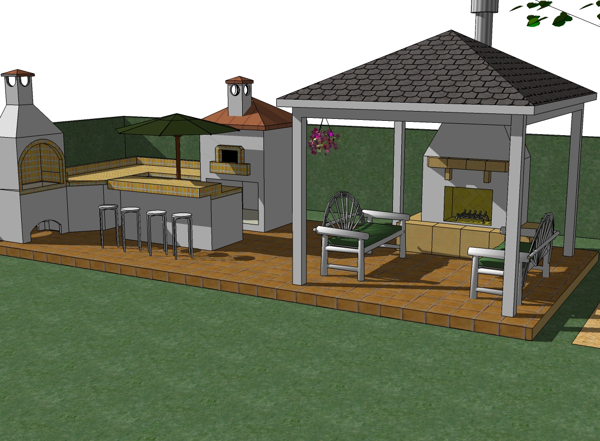

              My biggest concern with having both in same unit would be trying to use the oven while a fire is going (i.e. having a pizza party in fall) I wouldn't want to stand in front of fireplace while trying to cook, nor do you want guests huddled around fire trying to get warm as you cook. I like the attached layouts.

                It looks good: you might consider putting the roofed area over the kitchen rather than the seating area: There's going to be lots of time you want to cook outside in inclement weather, but most folks won't want to sit out, even under a roof, when it's raining.
                Good call on separate fireplace and cooking areas.
