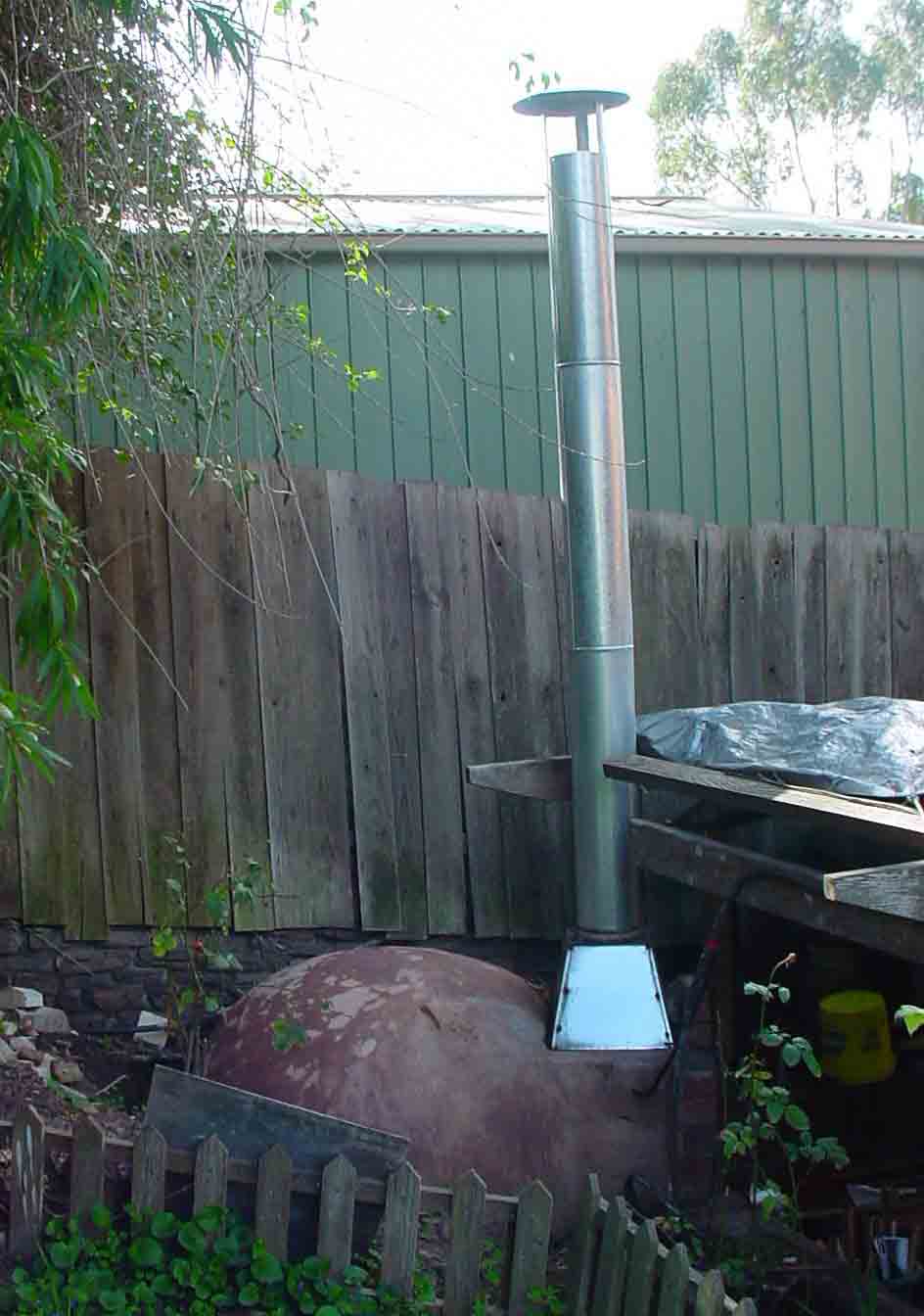

              Re: Pizza Chimney
              The higher the chimney, the further from your comfort zone, the smoke is released. Who wants the smoke to hang around on a still day/night. Get it up and away.
              Neill
