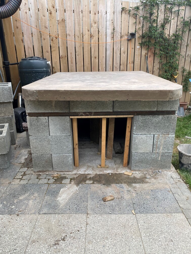

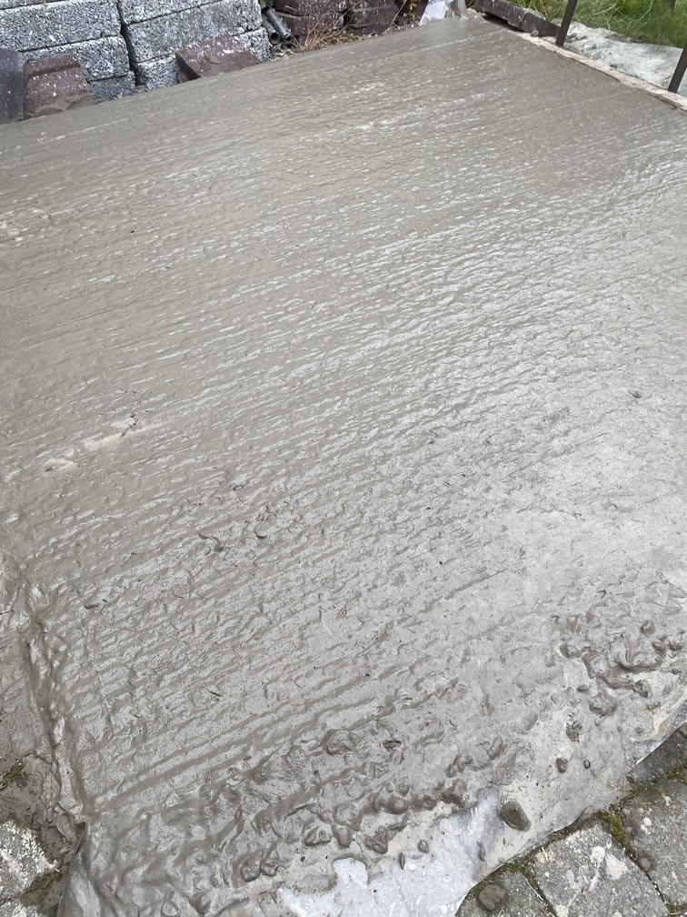

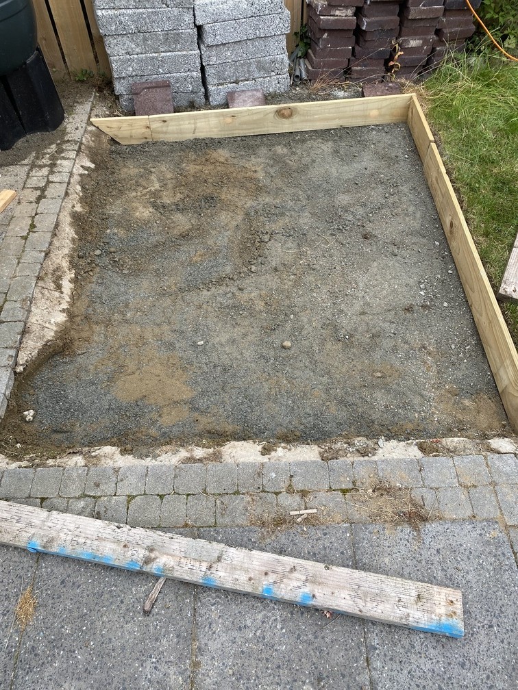

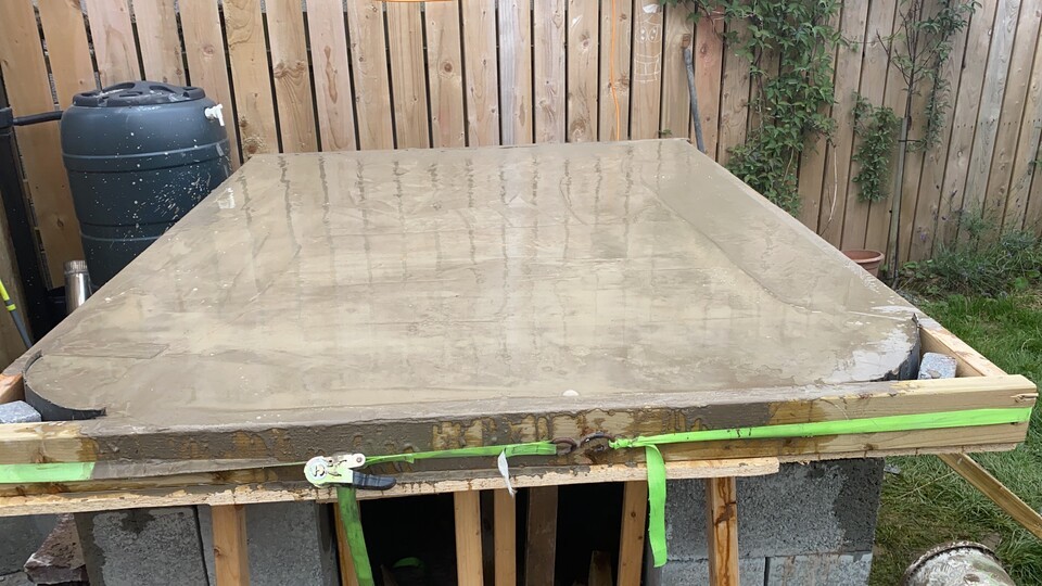

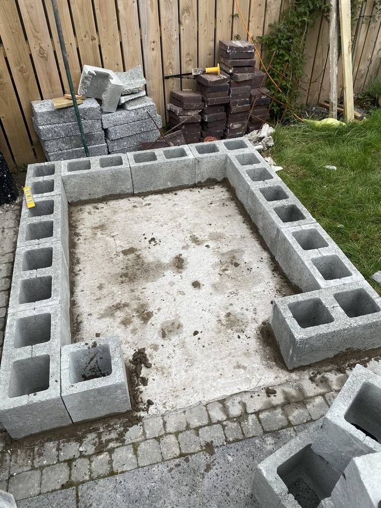

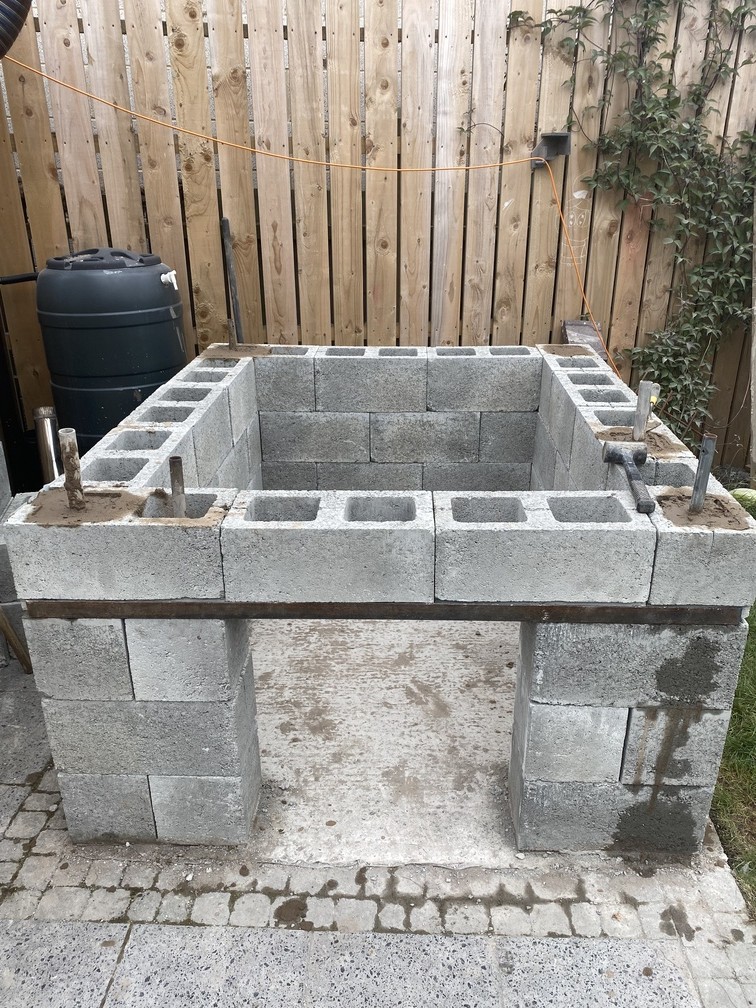

    I've stated a build in Co Down and got lots of good info from here so far so thanks to all. I'm up to the hearth level now and looking to decide a way forward. I started out thinking a 36 inch oven would be right but think I may be able to fit a 42 inch. Any thoughts?
    Hearth dimensions are
    W - 60 inch
    D - 79 inch including a 10.5 inch overhanging landing area
    I was gifted a lot of storage heater bricks but as I've gone on, I'm not convinced I'd like to build with them. I was going to use regular fire bricks in the floor and build the dome with the SHBs but now I'm thinking I'd rather do the lot with regular FBs. What do you think about using the SHBs underneath the floor instead of ceramic fire board? They are the square shaped ones with the lip at the back so I could set them in sand/fireclay.
    Some progress pics attached
